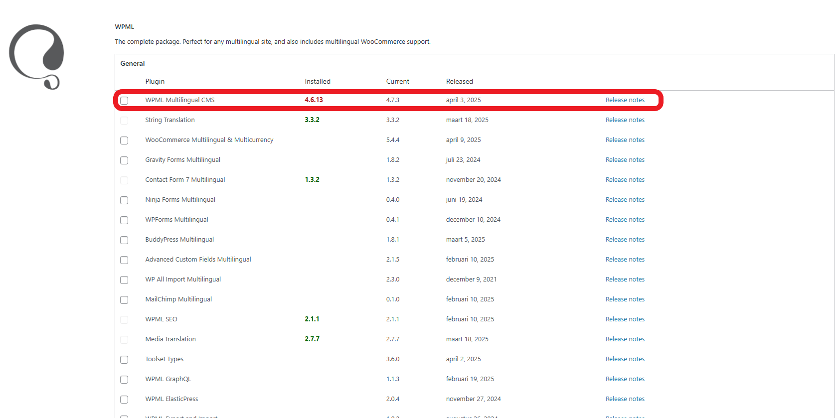

April 21, 2025 at 8:13 am #16951132
lodeT
Sorry i made a mistake. it's this plugin that caused the crash : WPML Multilingual CMS

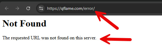

April 21, 2025 at 9:21 am #16951345
Itamar
WPML Supporter since 02/2016
Languages: Hebrew (עברית )
The access link to your website is not working. You shared this with me: hidden link, but I'm getting this error:
Not Found
The requested URL was not found on this server.
Please see the attached screenshot.
Please correct this and share the right access link. I'm enabling a private message for the following reply.
For your information, some WordPress plugins can change the default WordPress admin access. Please check if one of the plugins you are using is causing this issue. It can also be a security measure from a security plugin you are using.
Itamar.
