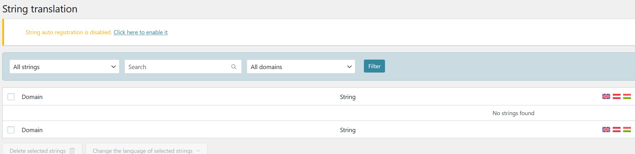

I wanted to try the new 'Easy Theme & Plugin String Translations' feature. I installed WPML 4.7 on two of my websites. It works fine on infinityarchmedia.com, but on weigertimages.com, which is a multisite, I could not see my strings anymore. I reverted back to 4.6.x and everything is fine again.
On weigertimages.com, a multisite, I could not see any strings anymore. When I chose all strings on all domains or on any domain and clicked on 'filter', I got the message: 'no strings found.'
Why are strings not visible on my multisite after updating to WPML 4.7?
How can I resolve the issue of missing strings on a multisite with WPML 4.7?

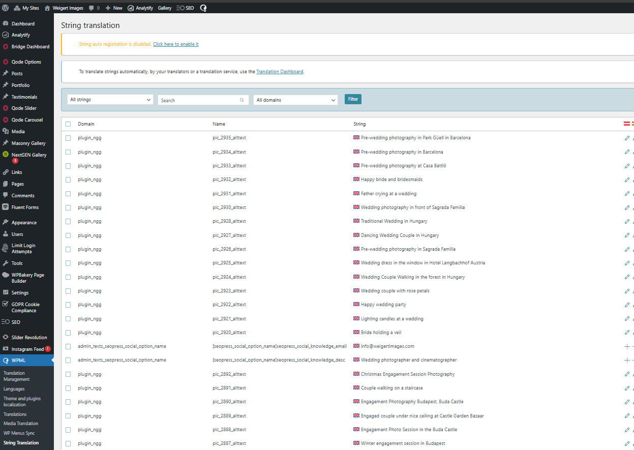

February 26, 2025 at 3:50 pm #16751991
George Botsev
Thank you for the package.
I deployed in locally, and for me, the strings are being displayed properly when I updated to latest WPML package for the main plugin and for String Translation plugin.
I am adding here a screenshot
That being the case, I feel that we might have some other issue over there - perhaps with cache or with the server itself - but I have to guess - it might be a firewall or another security measure.
Another possibility is that I may be missing a vital step on how to reproduce the problem - in which case, I feel it might be beneficial if you can record a short video showing the problem.
February 26, 2025 at 4:19 pm #16752181
jozsefW
You are welcome!
Thank you for the screenshot. I also have all the strings displayed when I open the page.
Did you make any filtering? Please choose for example plugin_ngg (or all domains) and make a filtering for it. The problem is that I get an empty screen here with the new version.
I stopped using cache plugins on my website.
If it is working on your side with the filtering, too, I'll make a video of the new version.
February 27, 2025 at 7:38 am #16754239
George Botsev
Thank you for the clarification on how to reproduce the problem
I see the issue.
To fix this, you need to go to WPML > Languages.
There click on Add / Remove Language and click on the "Save" button without selecting anything else and wait for the Ajax process to complete.
Once this is done, please clear your browser cache and re-open WPML > String Translation page and filter by any domain that you wish.
The issue should be resolved.
