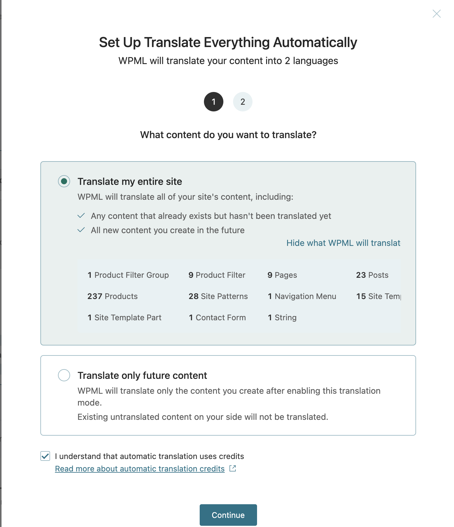

I am trying to translate an ecommerce shop on our development site using WPML before implementing it on the production site. hidden link
The translation preparation is stuck in preparation for several days.
How can we complete the translations that are stuck in preparation?
When the translate the production site, and the translations are preparing, will the shop be fully functioning in the default language?
How many credits do we approx. need for 330 products? See screenshot

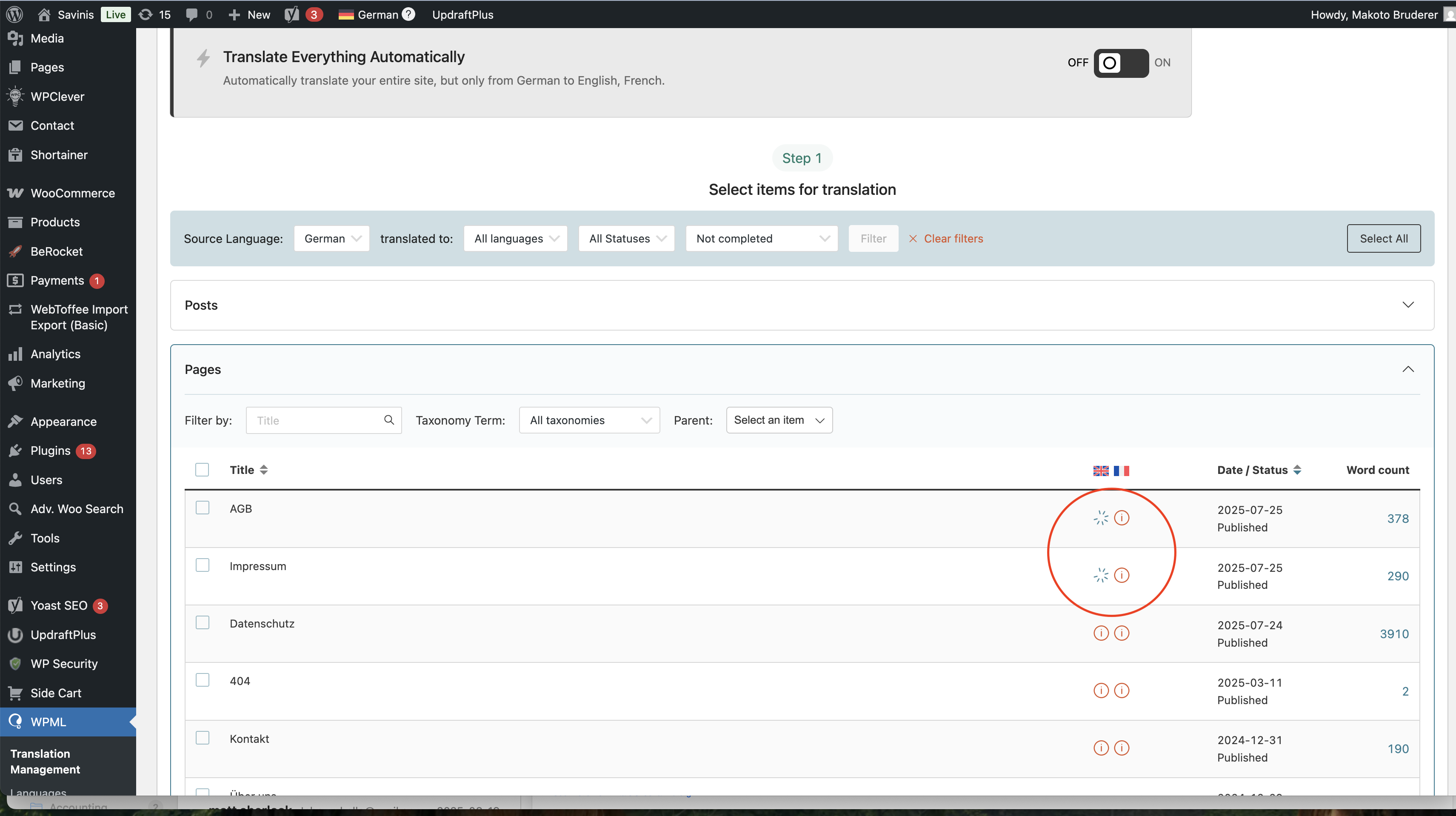

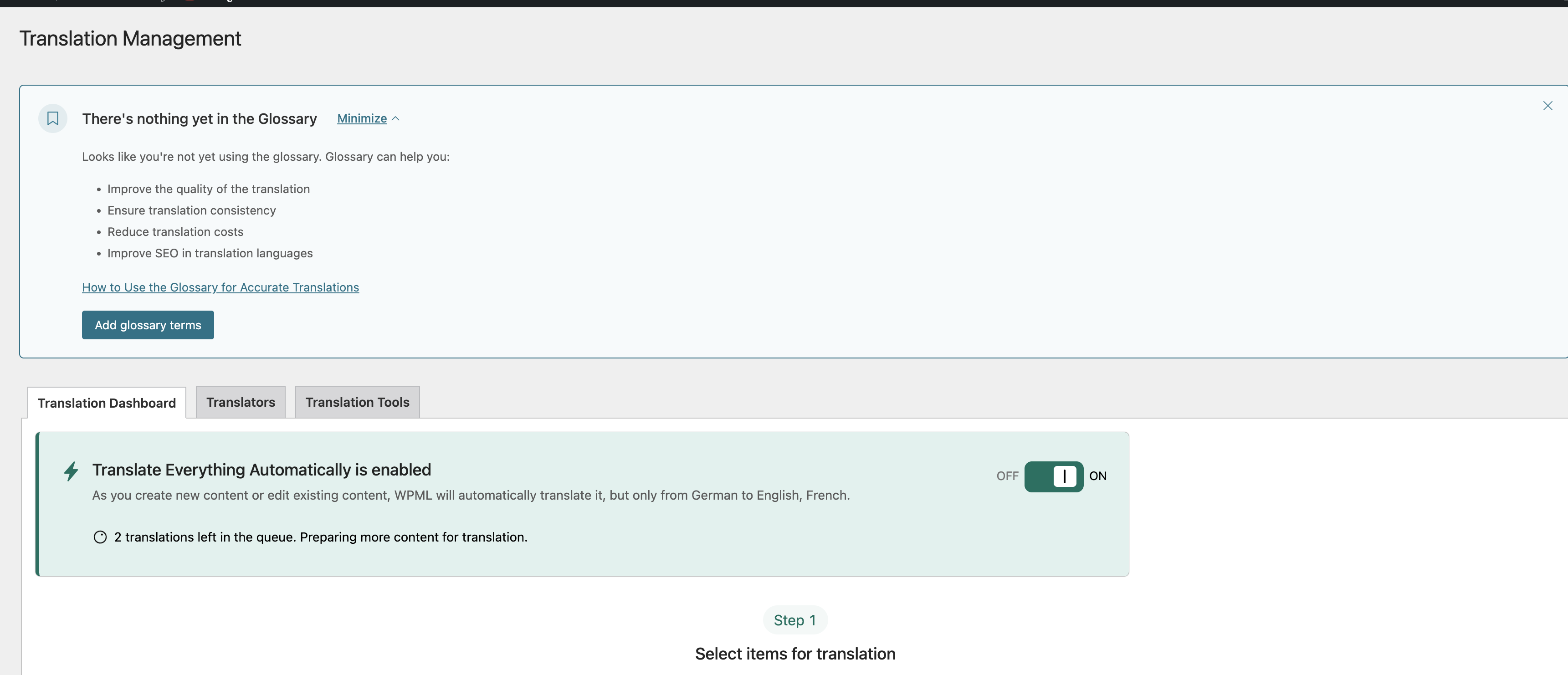

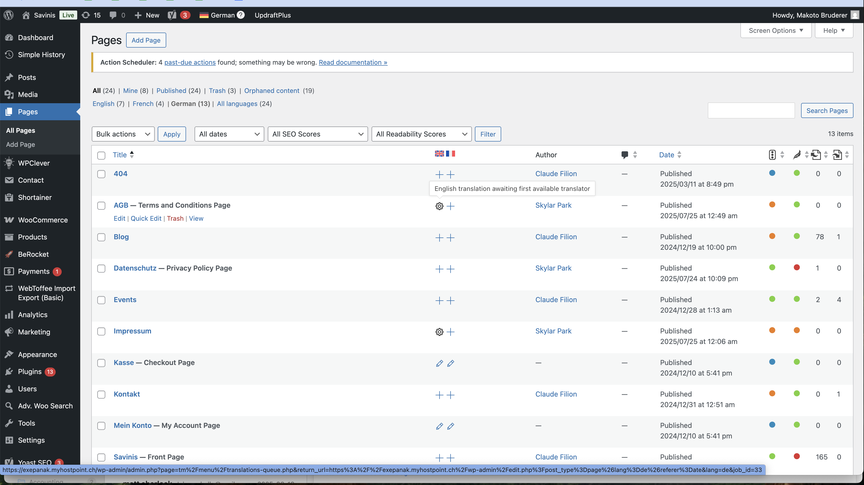

Hi we do need help yes please.
We wanted to test the Auto AI translation for our e-commerce shop but must have had not enough credits. Now the translations are stuck in "processing" mode. The wheels are endlessly spinning.
1. How can we stop the auto translation? We have already turned off the " Translate Everything Automatically" button.
2. The auto translation translated a few pages, but the translation did not change to the "pen" icon, instead we see the gear wheel and it says "Translation is awaiting first availbale translator" what does that mean? and how can we complete the translation?
3. We tested a translation with the deepl AI function - About us page, and it worked great, we translated it to 100% and completed, but the translation again is just showing the gear icon with the note "English translation assigned to local translator" -> how can we complete these translations?

August 22, 2025 at 7:37 pm #17341330
Otto
Hello Makoto,
Please try the following:
Go to WPML -> Support -> Troubleshooting, scroll down and click on "Cancel in-progress automatic translation jobs".
As far as I can see from your screenshot, you already disabled automatic translation, so once you cancel in progress job you should be able to select and send to translate specific content.

On live page now better but still strange behavior:
1. Translated a page pressing on the + icon, everything clean translated up to 100%, saved and closed
2. Then unfortunately it switches only to the gear, again - the status is endless spinning wheel at translation mgmt dashboard
3. BUT: If I go over to WPML > translation mgmt dashboard > last tab translation jobs --> there I see it is "in progress", and if I stop/delete the job there, then suddenly it jumps to the green check icon and to the pen icon on page overview
What does this behaviour mean? Maybe this helps to solve this issue?

August 29, 2025 at 2:10 pm #17358373
Otto
I am sorry for the troubles.
The error points to "yk_clear_translations_cache" function, which is not part of WPML base code. I think there may be a compatibility issue.
I understand that the problem is happening in production, right? So it will be hard to suggest debugging steps there.
Is it possible for you to provide me with a copy of the site? You can use the plugin hidden link to do it or WP All In One Migration.
With it, I will be able to debug it locally without affecting your client's site. Once the issue is solved, I will delete it.
I enabled a private reply so you can share a download link to it.
Best Regards,
Otto
September 1, 2025 at 12:59 pm #17362629
Otto
Hello Makoto,
Thanks.
I deployed the copy of the site locally and managed to see the first issue:
After completing a translation, the status remains as "in progress". But not the fatal error.
I switched from the "Savinis" theme to Twenty-Twenty Five, and the issue disappeared. Is it possible for you to confirm this on your end?
