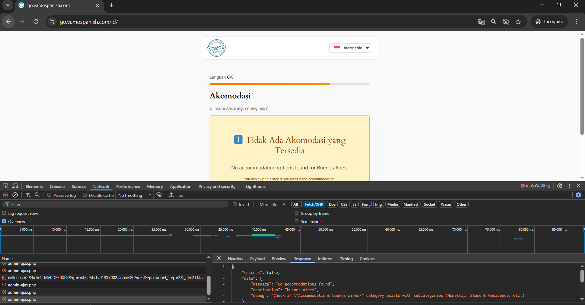

Type 2: “No accommodations found”
Affected Languages: Catalan, Italian, Finnish, Hungarian
Cause: English slug like buenos-aires is received, but translated category lookup fails in those languages.

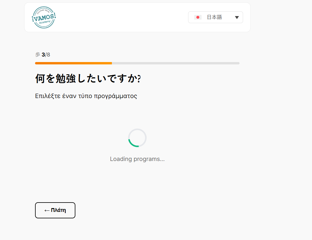

4. Loading Time Increased Significantly
After switching to SKU-based WooCommerce product fetching in the AJAX logic, the loading time for several languages increased dramatically.
AJAX responses take too long
Slow DB queries for translated SKUs
Performance drops when WPML applies language filters
This is affecting user experience on frontend heavily.

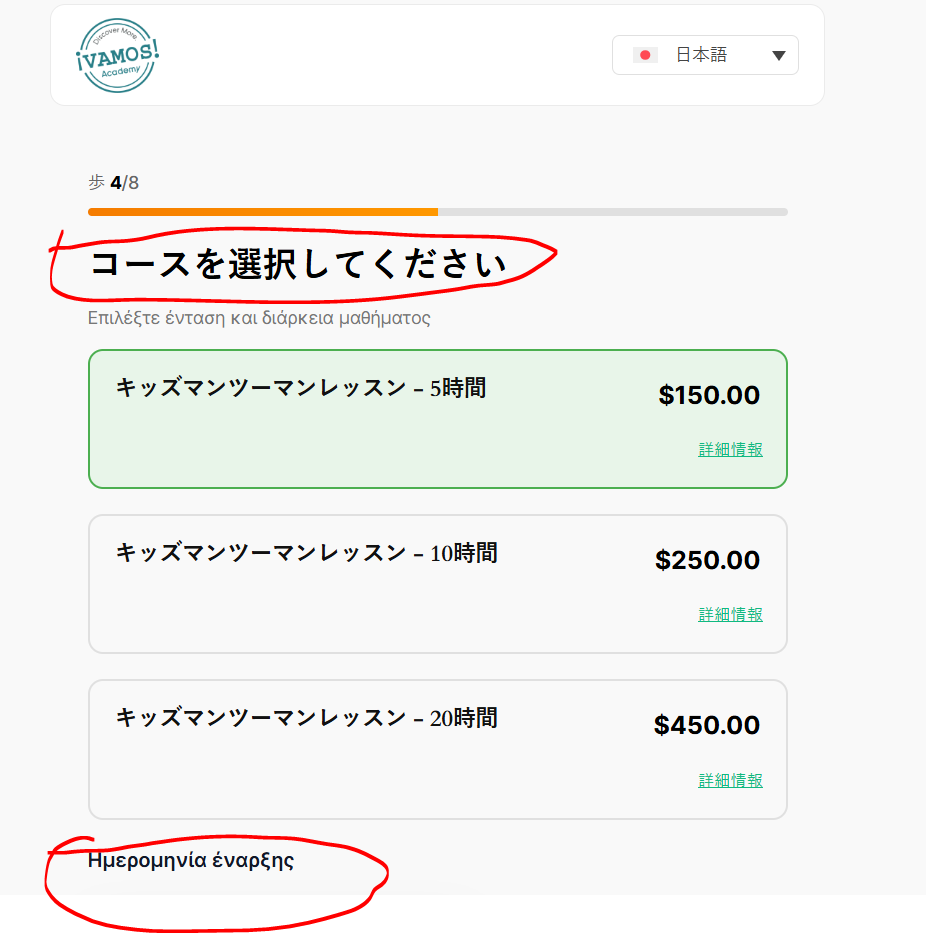

5. Incorrect Translation Strings Showing
Some translated text strings are appearing in the wrong language.
Examples:
If I select French, a few labels show in Spanish
Choosing Korean loads some Arabic static strings
Certain WPML string translations are mismatched or overlapping
This makes the frontend look broken and unprofessional.
