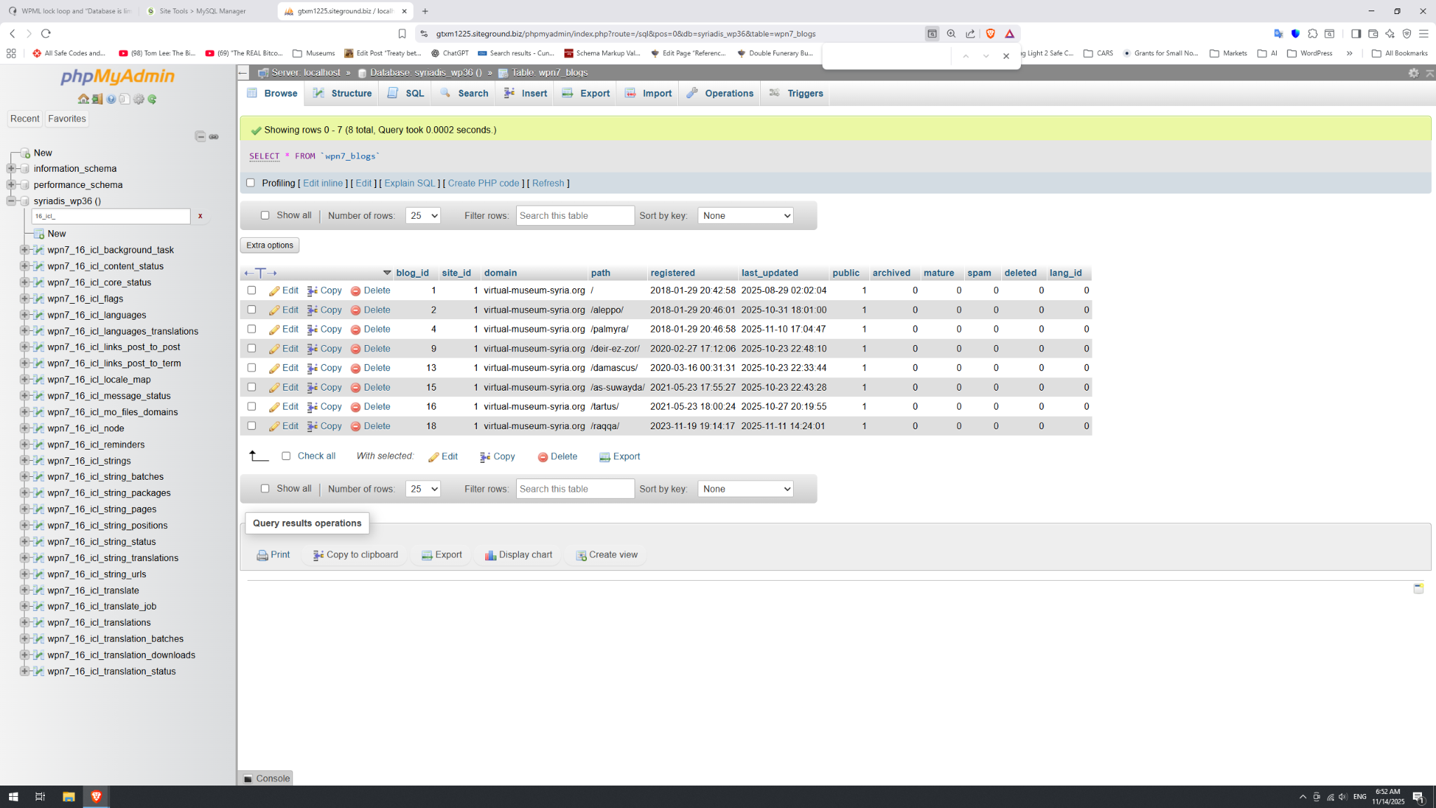

I am not able to see it at the moment, however, if you are comfortable taking a look at the database, what I need is a screenshot of all the _icl_ tables.
This will allow me to review and ensure they are all present.
November 14, 2025 at 2:55 pm #17579655
bisherA
“Here are all WPML icl_ tables for Tartus (blog_id 16)”

November 14, 2025 at 10:41 pm #17580336
Bobby
WPML Supporter since 04/2015
Timezone: America/Los_Angeles (GMT-08:00)
Thank you for sharing the screenshot!
if the notice has not came back, we can assume that the issue is resolved as the database tables look to be in order.
