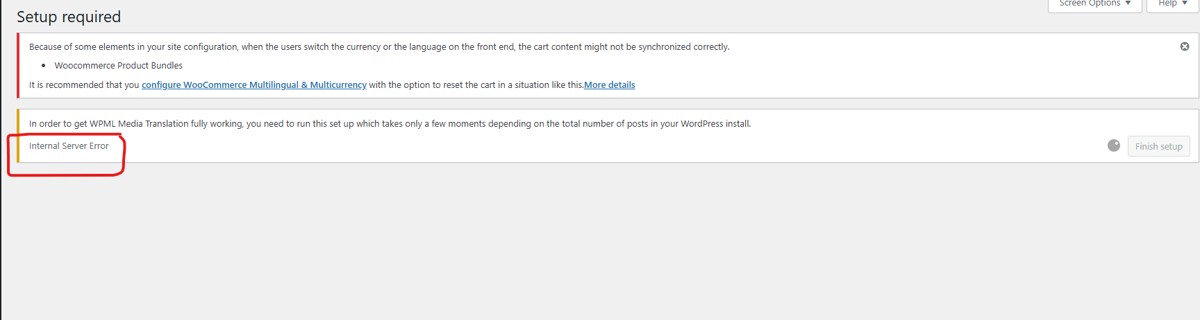

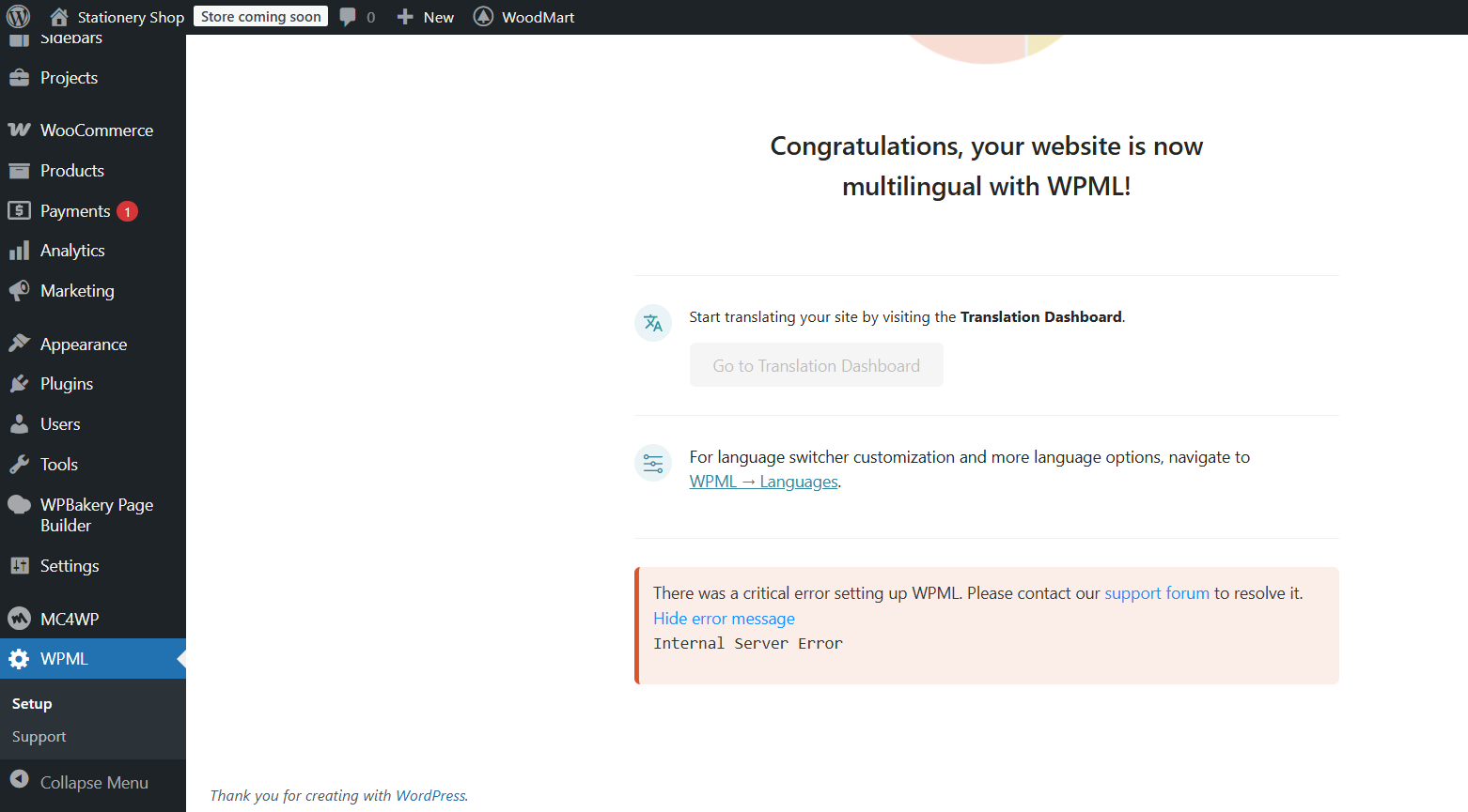

I am trying to set up WPML on our site hidden link but couldn't complete the setup process.
Every time I initiate the process, we get an error message and the site is stuck with an error message.
What could be causing the error message during the WPML setup process?
How can I successfully complete the WPML setup on my site?

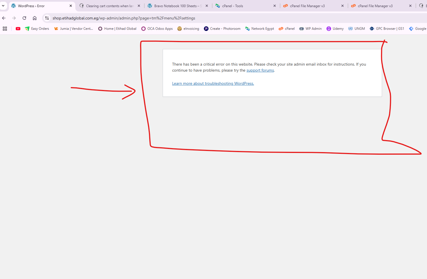

We also have deleted all themes, plugins and files from our site and re-installed the theme, which is WoodMart, WoodMart Plugins and the site is working very well until the moment we installed WPML, the website crashed again.
When the website crashes, the only way to gain access to the WP Dashboard is to delete WPML Plugins.
Once we delete WPML Plugins, we restore access to our WP Dashboard.

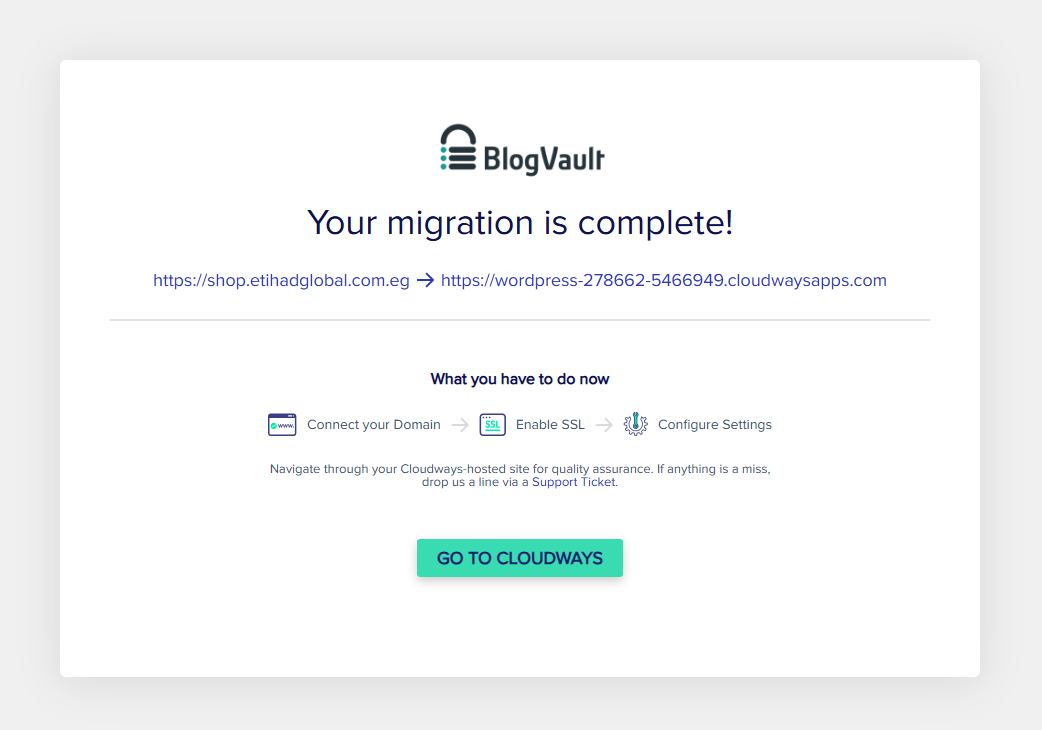

I'm in the process of setting up a staging site and will send instructions for how to migrate your site there. This way, we can test it in a different server environment and make changes as needed for testing without interuppting your live site. As soon as I have staging ready, I will send the next steps.

Please see my previous private reply and let me know once the migration is completed.
May 2, 2025 at 9:52 am #16988902
mahmoudA-50
Dear Lauren,
Many thanks for your kind support, I really appreciate it.
I have did exactly what is required with migration. Screenshot attached for your kind reference.
I also got 2 emails once when the migration process started and and another email upon completion of migration.
The WPML plugins are not installed on our site, please let me know if I should install them now.

Thanks for completing the migration. On the test site, I was able to install WPML without any problem. Please feel free to login and check my WPML settings and see if perhaps there is anything different on your live site.
If nothing appears to be different, please ensure that your server firewall is not blocking the WPML API. You should whitelist the following domains:
wpml.org
cdn.wpml.org
api.wpml.org
api.toolset.com
cloudfront.net
Since specific IP addresses are dynamic and not provided, whitelisting by domain is necessary. Additionally, it's possible that another plugin is blocking the connection. We recommend temporarily deactivating all other plugins except WPML to check for conflicts. Always ensure to back up your database before making these changes. For more details, visit https://wpml.org/faq/wpml-plugin-cannot-connect-to-wpml-org/.
Also, please let me know if you temporarily disable Woodmart and the Woodmart plugins if you are able to install WPML without the site crashing.
