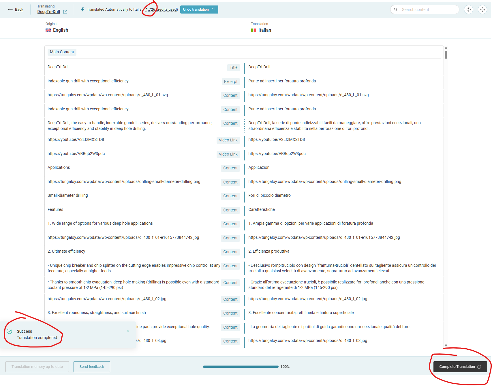

I am trying to translate an Italian post from English using the WPML translation editor. The issue can be seen on this page: hidden link
The WPML translation editor auto-translates as expected, but the 'complete' button spins endlessly. The original English text is still showing, and I have wasted credits.
Why does the 'complete' button spin endlessly?

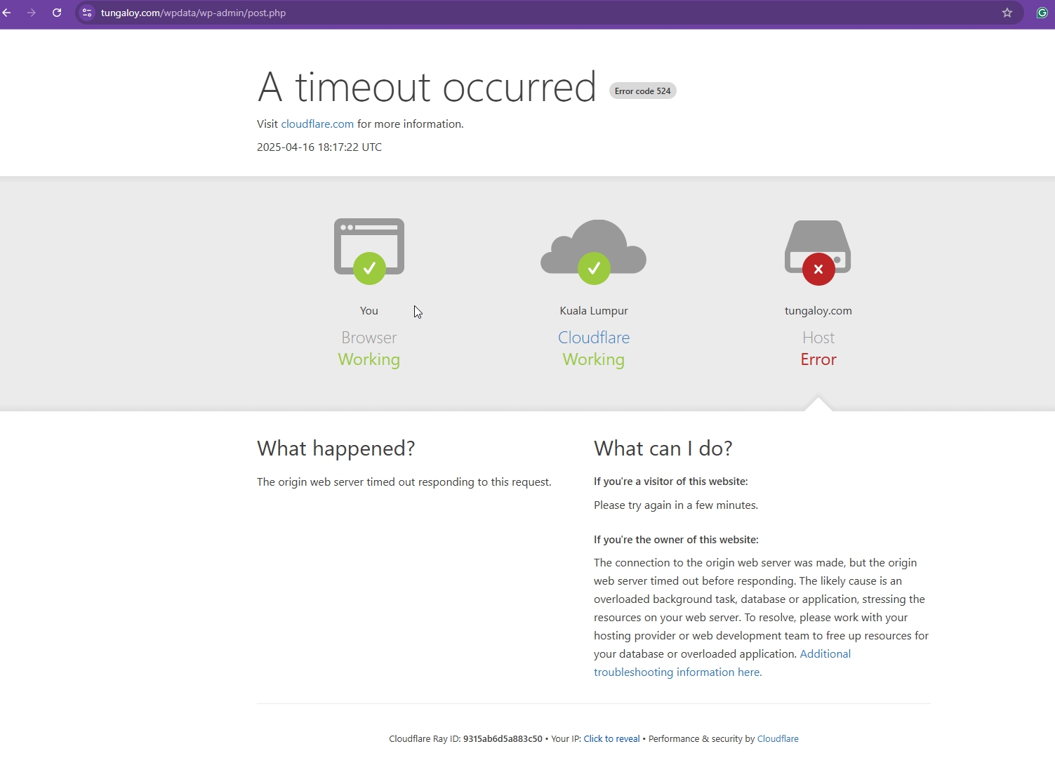

April 16, 2025 at 6:19 pm #16940784
Thanks for your reply. I’ve checked and I’m experiencing a lot of timeouts, as shown in the attached screenshot. I believe this is preventing the translations from completing, as the system is unable to open the translated page after the translation process. Could you check with your hosting provider to see what's causing the issue with the Website?

This is a problem.
The server is already upgraded for this reason because WPML really struggles to save all our duplicated pages within Cloudflares set timeout. We are unable to change Cloudflares timeout. Before we started useing WPML advanced editor, WordPress was still able to process everything in the background even with a timeout. You seem to suggest that the new editor needs to access the page afterwards to complete it.
