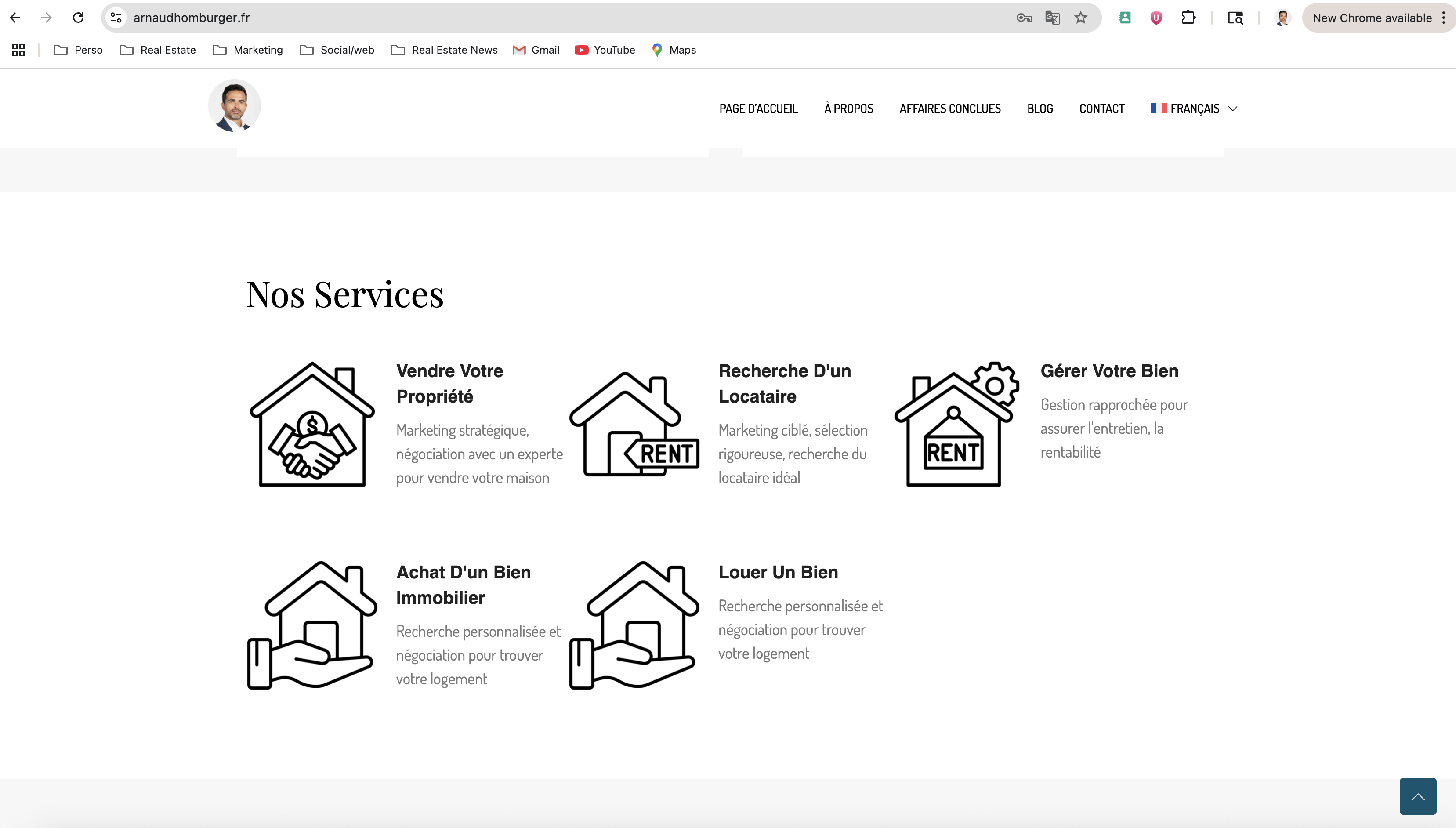

1. Elementor access on french version:
Could we now work on the Elementor issue on the french version of my website?
2. Icons size issue:
Also, Houzez released several updates since our last conversation and I updated them on my site. However, there is a section they improved on the homepage (see screenshot attached).
The improvement aligns the icons better, especially on mobile version (which was not the case before). However, the icons were too big so I reduced their sizes on the english version, using Elementor, but it did not modify the icon sizes on the french version. I tried to edit the french homepage and reduce the icon sizes using Elementor, but with problem 1., I can't do that. Shouldn't the logo size update automatically in the french version when I update it in the english version?
Thank you in advance for your assistance!!
Arnaud

June 16, 2025 at 1:44 pm #17139056
Ilyes
You next response will be private, please send the access again,
Best,
June 18, 2025 at 1:06 am #17144292
Ilyes
Hello Arnaud,
I have recorded this video explaining the issue : hidden link
Also, another possible test is to manually change the URL here to .fr : hidden link
Try also from a different device if possible too.
For the Icons, the sizes are now set correctly, keep in mind that any CSS/styling change you do, will not be automatically applied to translations, unless you resave the translation again.
I resaved the translation and it worked fine,
I hope this solves your issues,
