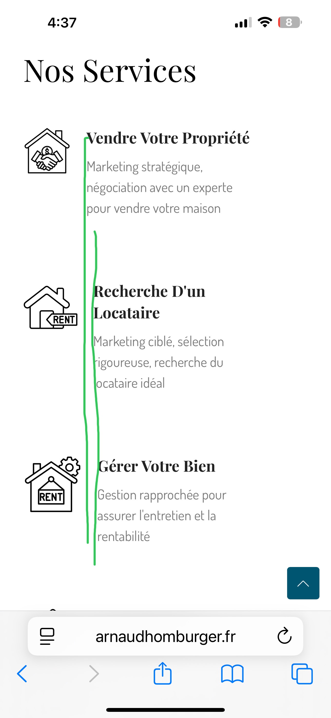

Regarding the alignement issue of the icons on the french mobile version, please see screenshot attached.
I would like to get this section perfectly aligned like the english mobile version.
Thank you so much!

June 20, 2025 at 3:26 pm #17154758
Ilyes
Hello Arnaud,
I found the issue, you can see that the size of the icon is slightly different in English for each icon : hidden link
And the alignment of the text and the icon itself depends on the size of the image,
Not having a constant size is a problem here, where is should've been a fixed size.
Maybe editing the size of the icon manually in French could work, I can't think of a solution from WPML's part, as it is conserving the "dynamic" styling as it should : hidden link
As you can see in the screenshot, the moment I slightly change the size of the text, the icon adjusts automatically,
Maybe find a way to make the icons' sizes fixed using the style or advanced tab instead of dynamic icon that depends on the text size.
Or maybe have separate widget for each device using the responsiveness function : hidden link , this way you can create a different design for mobile that could be better and more consistent.

June 20, 2025 at 4:58 pm #17154992
arnaudh-8
Hi Ilyes,
I changed the sizes of the icons and it helped a lot for now. So I am going to leave it like that.
