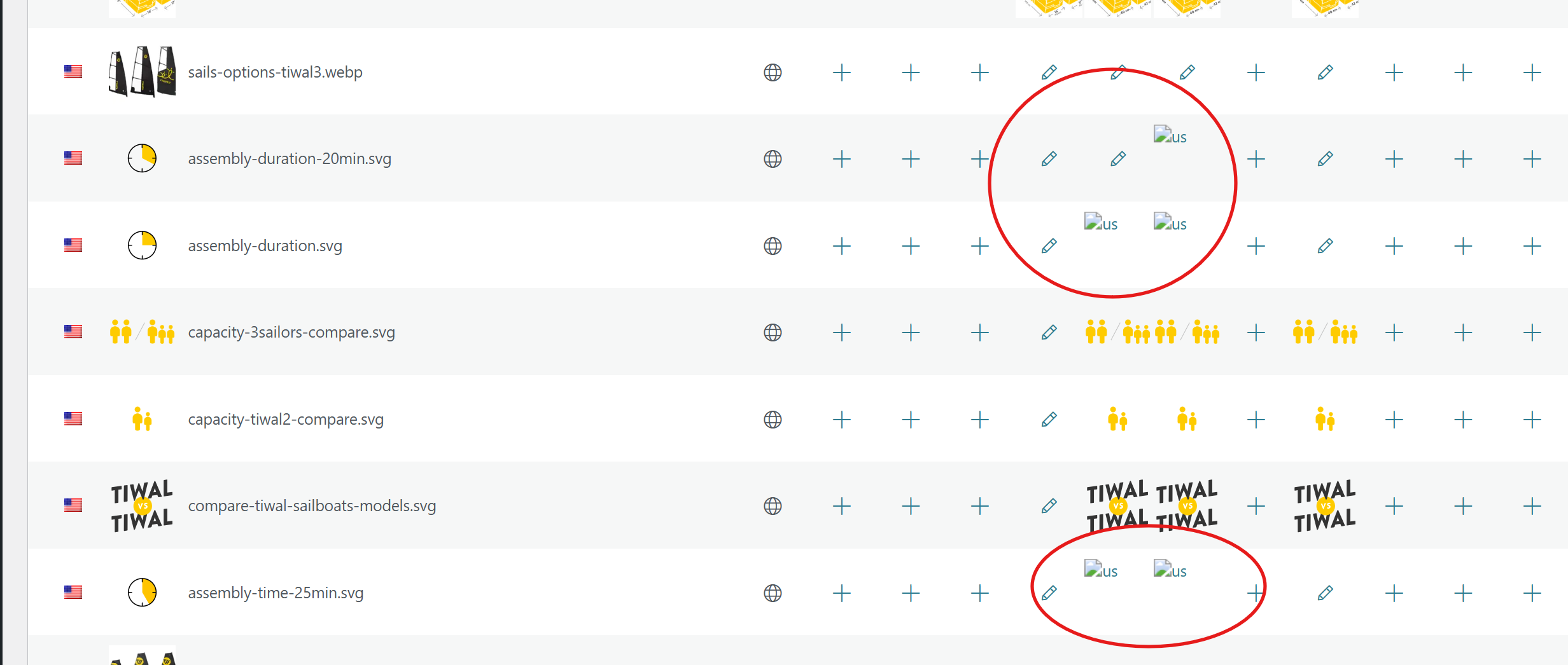

I did notice that sometimes (and it's not so rare...), image translated are broken in the media translation, or in the front end or in the media library.

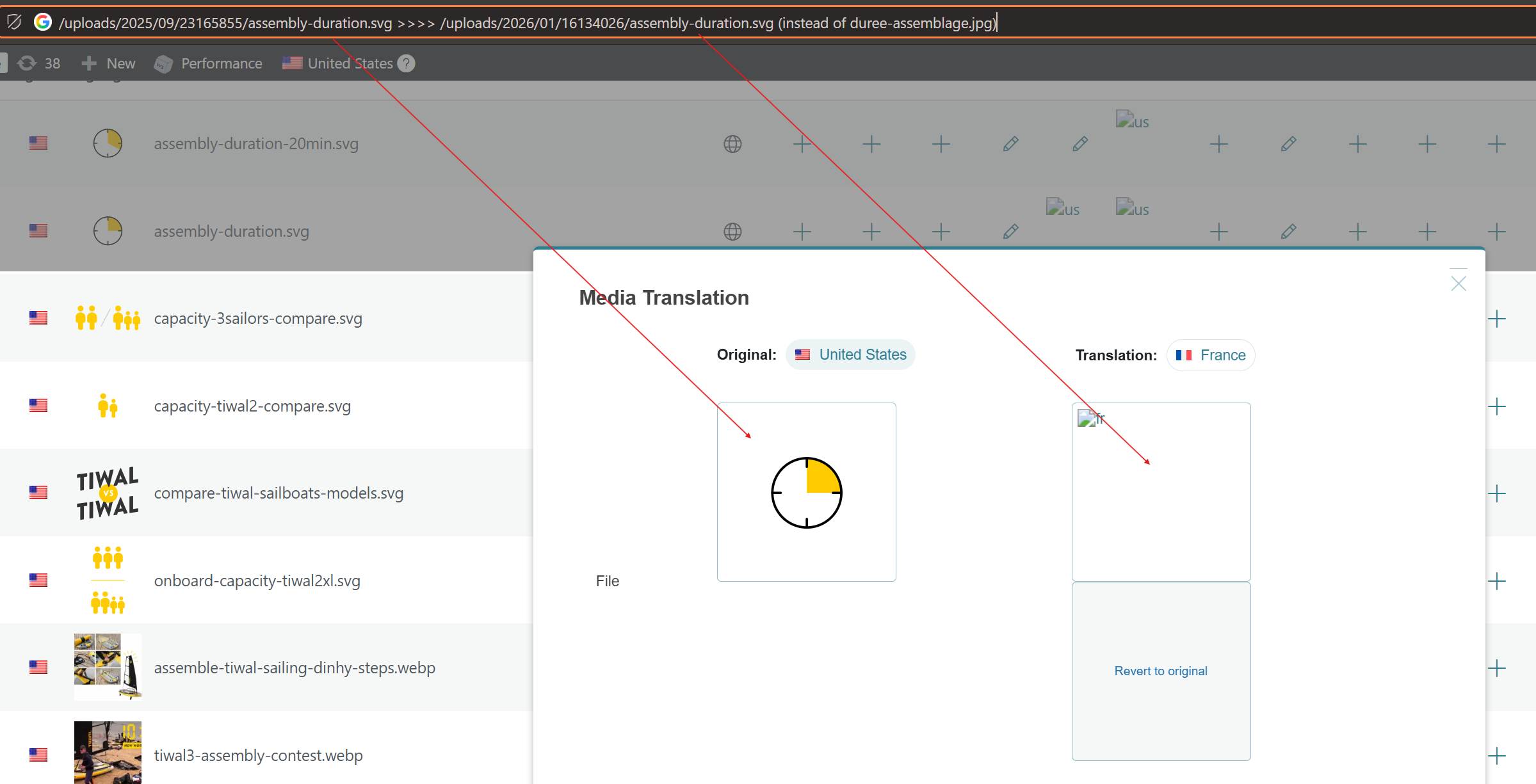

Taking a closer look a it, it's because in the paths of the translated images, sometimes the filename is right, but the path is the original one instead of the translted file's one. Or the other way around.
For example, if I upload an original language image on 2025-05, with image-english.png as filename its path is:
/2025-05/image-english.png.,
And its french translation as image-francais.png on the 2026-01, then the path is:
/2026-01-image-francais.png
Both the original and french files are reachable with these paths, and that's the path displayed in the media translation.
BUT then, in the media translation, once the page is updated, the french image is broken because it's pasth is: 2025-05/image-francais.png, or 2026-01/image-english.png.
In both case, of course, the media won't be reachable because the folder **or** the fileamame is the original's one.
Since the image is broken only in WPML Media translation, and not the library, I assume that's a WPML bug.
Finally, these broken images are also broken for the same reason in the content translation.
Best part is: in such case, there's no way to reupload the file - It'll remain broken, whatever I re-upload. The only solution that seems to work is reuploading the original images in the original language. The the metas, then reupload ALL the translated medias, and ALL their meta. It takes ages.
Enclose, it's just a sample, but I have many images in that case.
Can you please fix this?

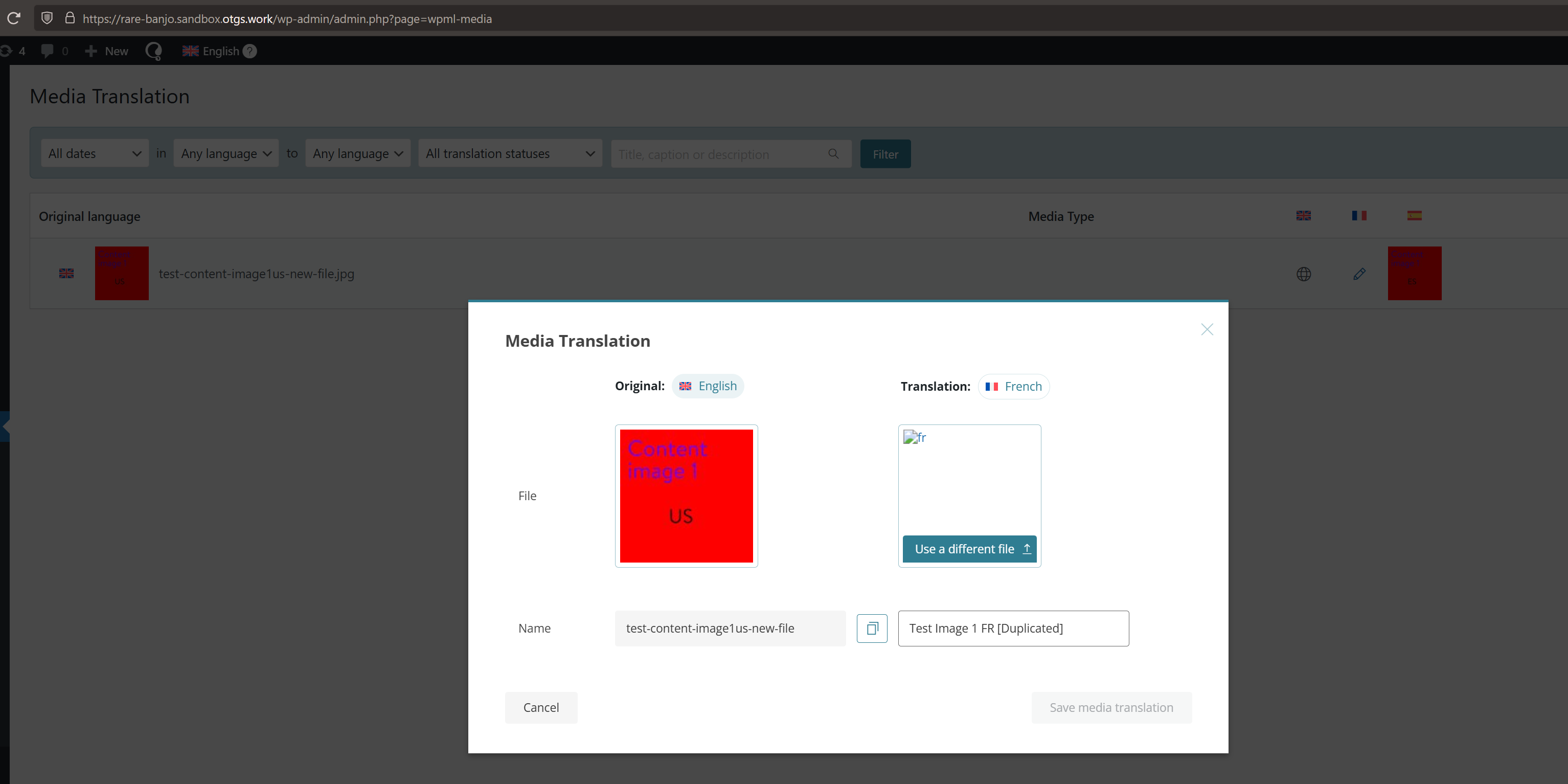

3. From Media Translation, I duplicated this image in French (no specific image), and added a specific image in Spanish
At this step, everything is fine.
4. I replaced the image with an other one, with another filename: test-content-image1us-new-file.jpg
Media Library > Edit image > Upload a new file > Set a Custom date (3 Feb 26 + Ticked "place the newly uploaded file in this folder" > 2026/02
5. Moved back to the Media Library: result attached ((screenshot case 1)
The Original image is fine: it has the new path and file name.
/wp-content/uploads/2026/02/test-content-image1us-new-file-300x300.jpg
The Spanish image is still fine... orignal path + filename: /wp-content/uploads/2026/03/test-content-image-1-es-150x150.jpg
The french one, however, is broken.
And this is because its path is: /wp-content/uploads/2026/02/test-content-image1us-150x150.jpg
The path was updated along the new original file, but not the filename.
Just in case I cleared the WPML cache + Clean/Optimize String Tables + Browser cache of course >> Same results.
So this is a case where the duplicated images get broken because the path is updated, but the filename isn't. But therer or other variants of this kind of issues.
The case I encounter the most being when:
1. I upload an image in the orginal language
2. Duplicate it to use it from another language
3. Months later, I upload an alternative image for a translated language, in this translated language, which will be broken because the path is the new one, but the filename is the orignal image's filename... (screenshot case 2)
The timestamp is due to offload media, but I checked multiple time, this one is always the one associated with the path, so doesn't seem involde in these issues
