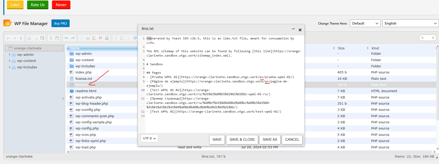

December 9, 2025 at 10:00 am #17646575
Lucas Vidal de Andrade
WPML Supporter since 11/2023
Hey there, thank you for waiting.
It seems Yoast SEO is able to export the correct URLs, but initially, it exported a version without any language directories.
Please ensure to have a backup before proceeding. To regenerate the file from scratch :
1. Go to your root directory and delete the file llms.txt
2. Go to Yoast SEO > Settings > advanced > llms.txt
3. Disable the Automatic page selection
4. Save
5. Enable again
6. Save
7. Access to the same link in a private browser: hidden link
This should regenerate the file with all languages. Please let me know how it goes.

December 11, 2025 at 12:15 pm #17655863
