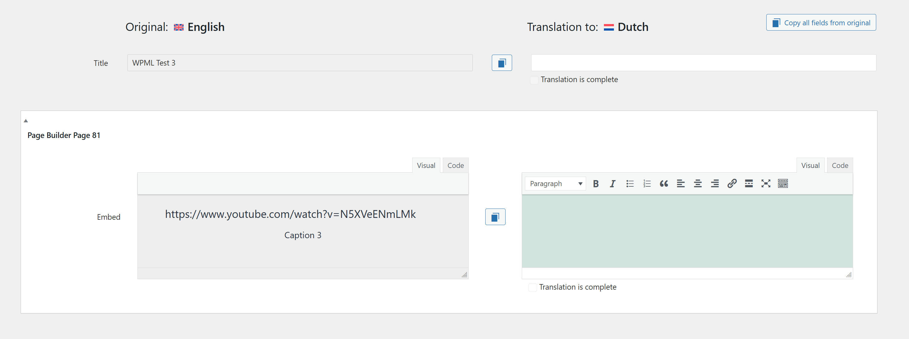

I am trying to translate a YouTube block on my WordPress site using WPML. The issue can be seen on this page: hidden link.
I expect to be able to translate the block with 2 segments: the URL and the caption.

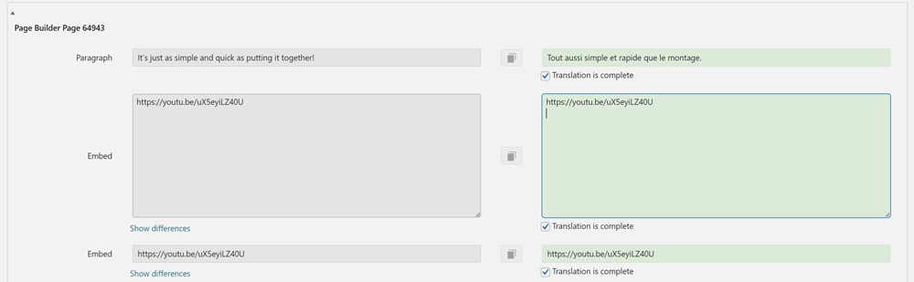

I get 2 "embed" in the CTE, while the caption is missing.
The first embed gets a line break that the original doesn't have, which breaks its translation. At least until I remove that line break.
Still, the caption will remain untranslated, unless I edit the page individually. Which would force me to break the translation process, so not a satisfying solution either.
Finally, I can't find the caption from the String Translation section.
Why does the YouTube block's URL appear twice in translations?
Why the second has a line break?
Why the caption is missing ?
Is there a way to translate the caption without editing the page individually?

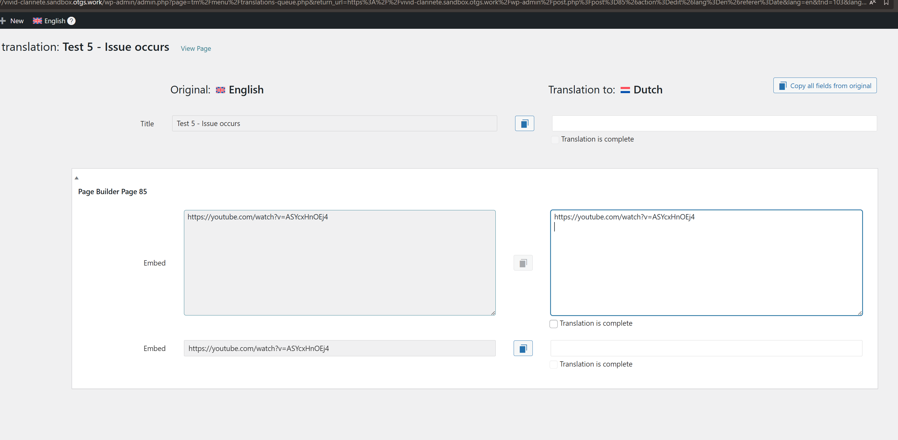

So I did further testing on my local env. And it drilled down to the case where :
- removing the setting
- clearing WPML's cache (from Support troubleshooting > Support > Clear the cache in WPML)
- Create a new content and translate it
Would sove the issue
In our case, this was difficult to check, because we implemented it both from the code AND the admin > WPML > Setting > XML.
And since both declarations would work, noticing a change would rely on
- removin the conf from the code
- from the admin
- testing on a brand new content
If one of this step was missing, you can't notice a change.
Which is bad, since this means I'll need to recreate ALL video blocks :((
Anyways. I think I can now confirm the issue is caused by this WPML config since, adding this configuration + clearing WPML's cache on your test env makes the issue occur.

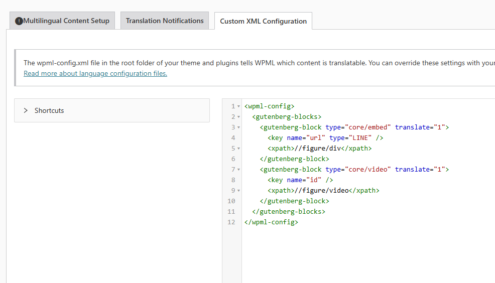

The guilty configuration is:
<wpml-config>
<gutenberg-blocks>
<gutenberg-block type="core/embed" translate="1">
<key name="url" type="LINE" />
<xpath>//figure/div</xpath>
</gutenberg-block>
<gutenberg-block type="core/video" translate="1">
<key name="id" />
<xpath>//figure/video</xpath>
</gutenberg-block>
</gutenberg-blocks>
</wpml-config>

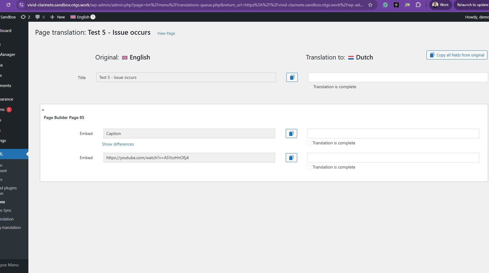

But I tested that as well, and it doesn't make any difference. As long as this setup is enabled, the video blocks can't be translated properly.
I just added it and cleared the cache on the test env, so that you can test it.

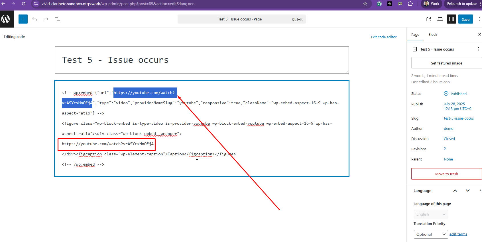

Thanks for your reply. I’ve checked the test page where the issue can be replicated: hidden link
After reviewing the source code, I can see that two embedded YouTube codes are being rendered, as shown in the attached screenshot. This appears to be coming directly from Gutenberg, and unfortunately, I don’t believe there’s anything we can do from the WPML side to change that.

I'm sorry, it looks like you didn't understand my feedback.
What I found out, is that the custom setup, as advised in the post mentionned int #2, seems to be what causes the issue.
Indeed, If I:
- Get rid of this custome setting from my child theme code
- Get rid of this custome setting from WPML > Settings > XML ,
- Clear WPML's cache
- Create a new post, with video block
>>> I **don't** encounter the issue anymore.
So there's nothing to "fix", it seems I just need to get rid of this custom setting.
Still, I don't understand why this setup was needed at some point, and why now it does break the content.

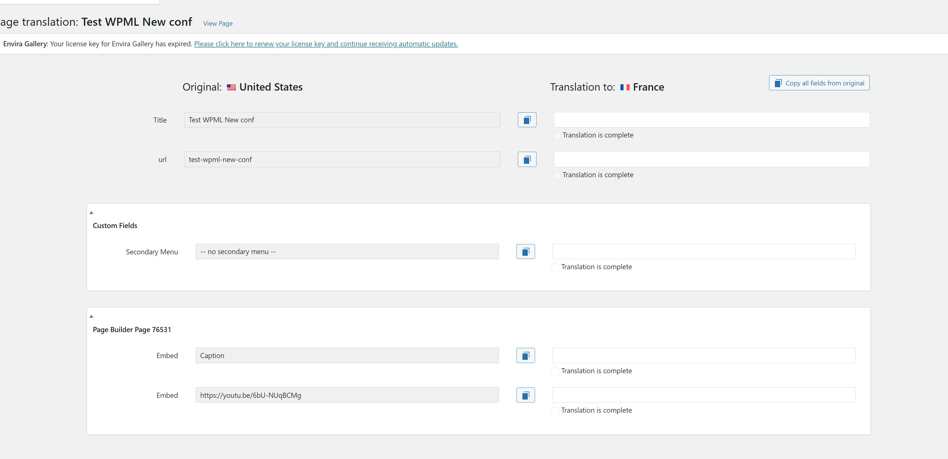

July 28, 2025 at 2:45 pm #17275820
I get what you mean now. I've adjusted the custom XML configuration code to the below.
<wpml-config>
  <gutenberg-blocks>
      <key name="url" type="LINE"></key>
     <xpath>//figure/figcaption</xpath>
    </gutenberg-block>
  </gutenberg-blocks>
</wpml-config>
Could you check and see if it works correctly now?
July 28, 2025 at 2:55 pm #17275887
T4ng
This is a different issue. I was OK with how the caption displays in the editor.
Do you mean the presence of a captions changes the behavior?
Do you mean there's no issue if there's no caption?
July 28, 2025 at 2:58 pm #17275892
Thanks for your reply. I mean, the custom XML configuration code that you applied earlier is incorrect. So, I've corrected it for you, and could you test this?
July 29, 2025 at 8:01 am #17277392
T4ng
Indeed, it seems to work and now shows separate segments for the URL and the caption.
