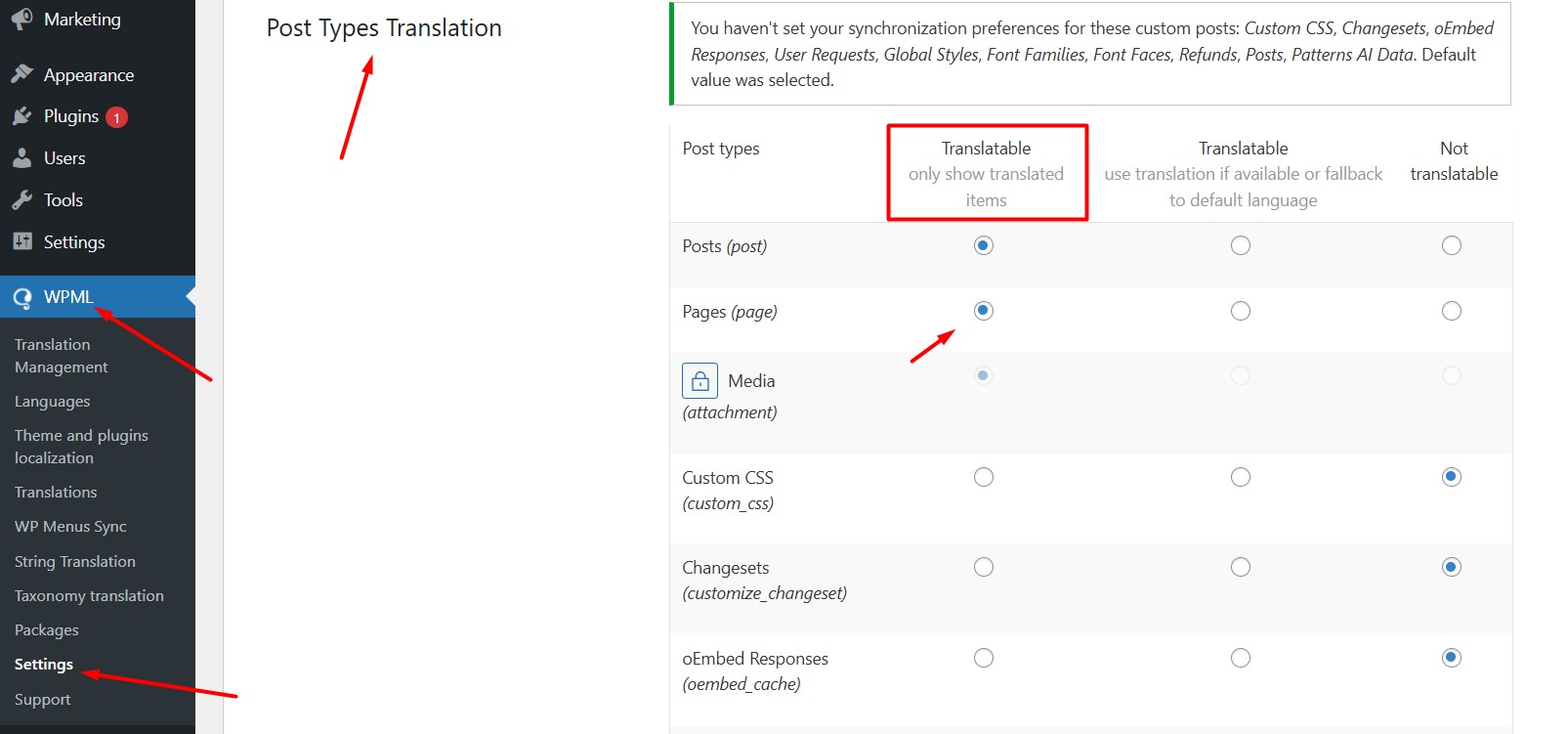

Thank you for contacting WPML Support. Sorry, there is no such option available in WPML. To enable custom post types translations, you need to follow the below steps:
1. Go to the WPML >> Settings page.
2. Scroll down to the Post Types Translation section.
3. Set the Accomodation post type as translatable as you can see in the attached screenshot.
Here is a doc for more details: https://wpml.org/documentation/getting-started-guide/translating-custom-posts/
