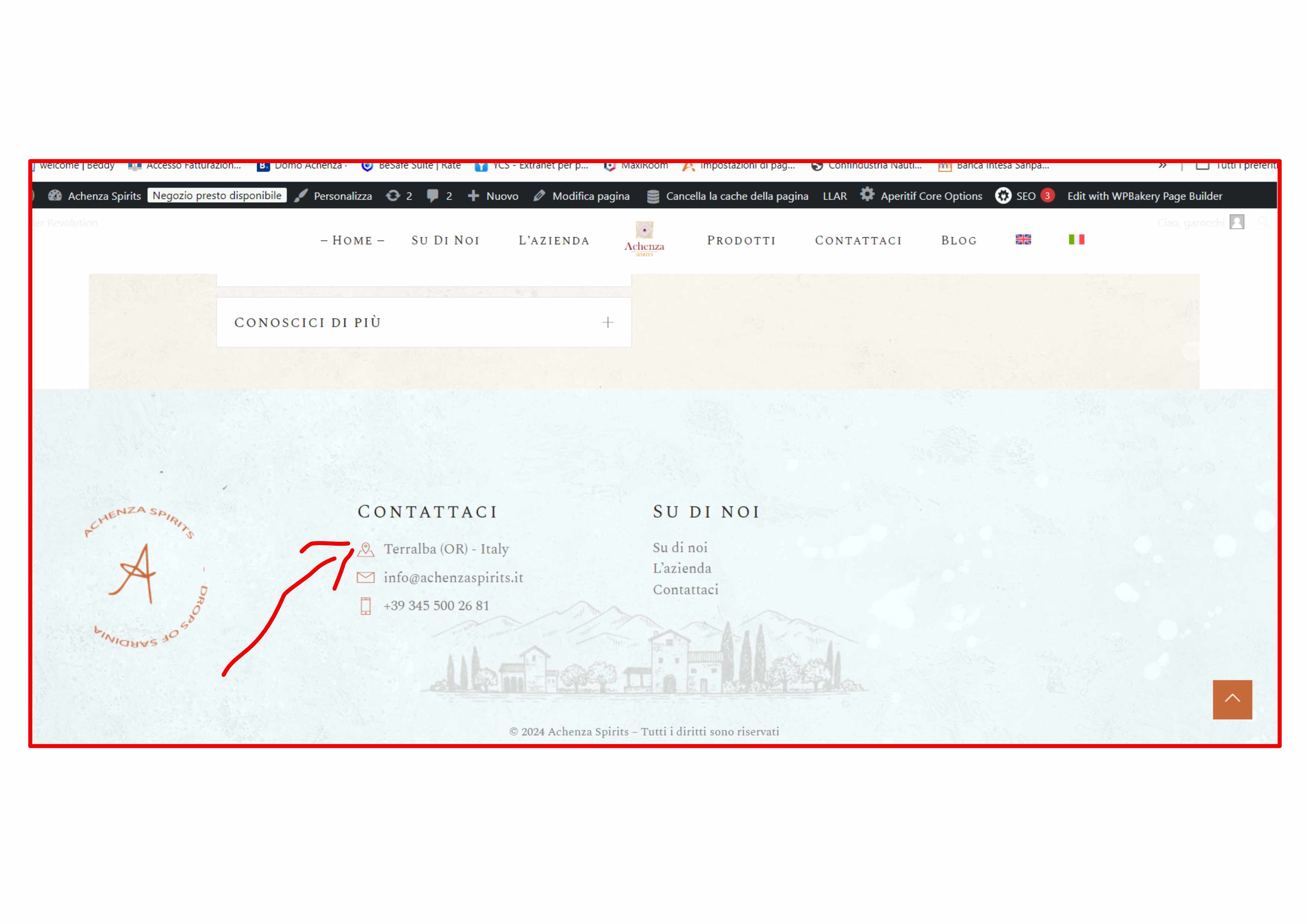

Settembre 18, 2024 alle 9:19 #16191861
gabrieleR-4
Hi Prosenjit,
English's fine for me..
I've done everything written in the vademecum, but still cannot translate the string "Terralba (OR) - Italy".. as you can see it appears both in English and in Italian.
I've already translated it in String Tranlations area, but not working and I've becoming crazy about it..
can you please check?
Gabriele

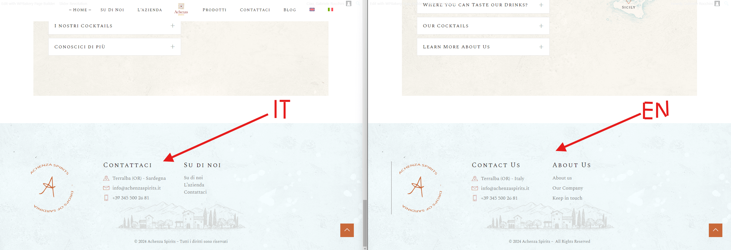

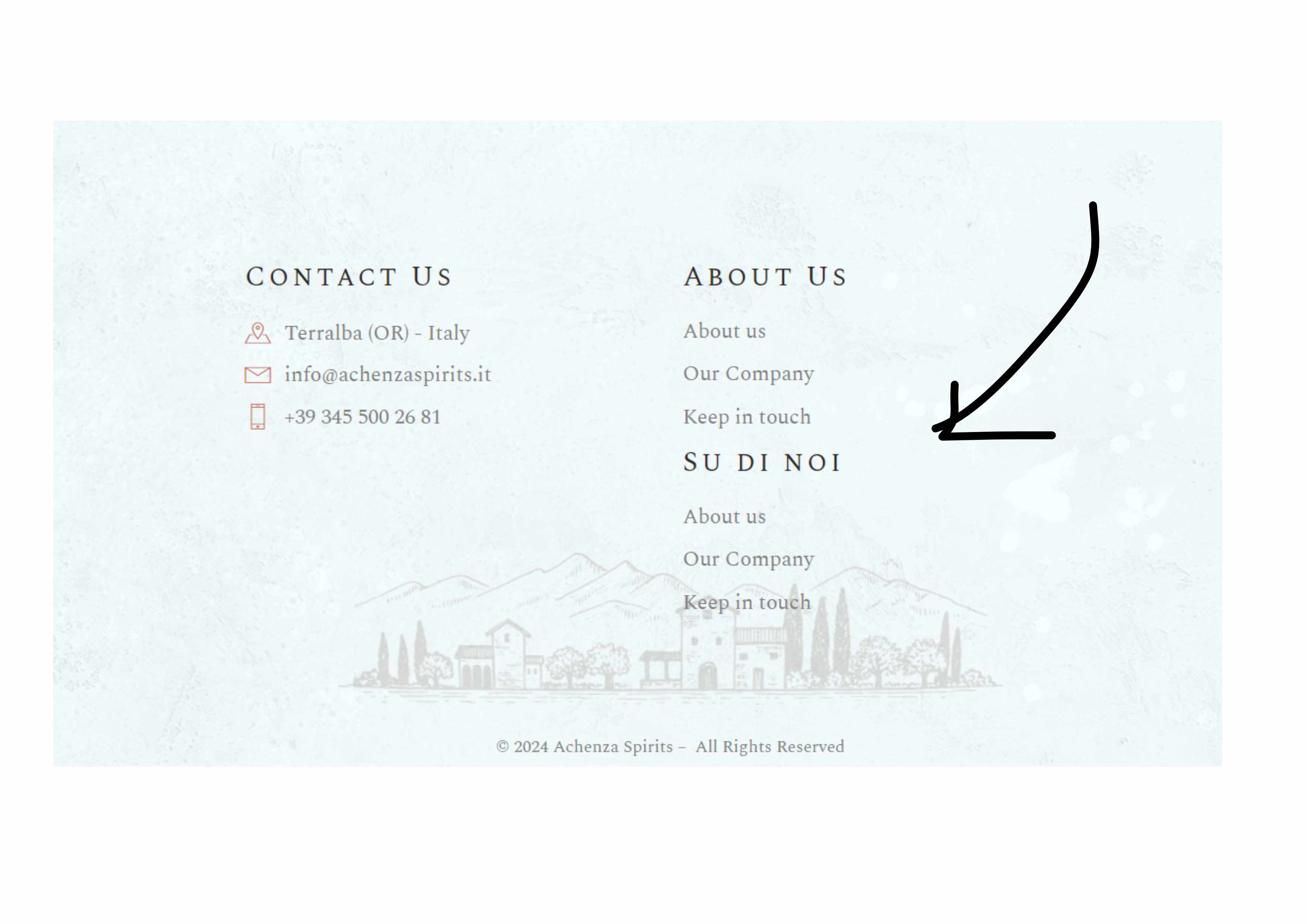

Settembre 18, 2024 alle 10:23 #16192371
gabrieleR-4
Also in the 3 Column (about us section).. I've been trying to tell to put it only in the English site, but it puts both English and Italian..
I checked on String translation but there I cannot translate the links to the Italian site..
Once it worked better this part with Widget Logic plugin, isn't it?
Thanks for your support..
Gabriele

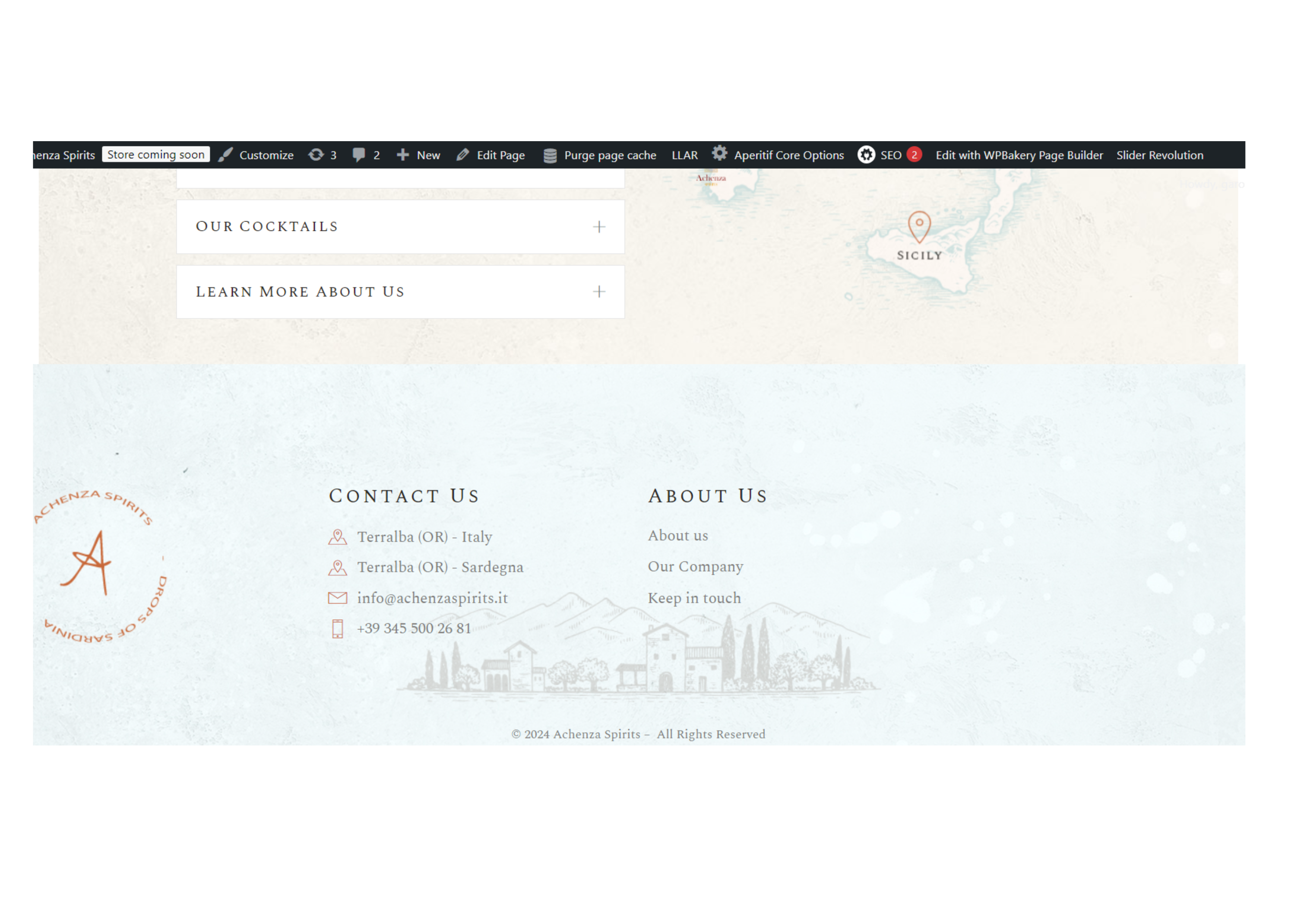

Settembre 20, 2024 alle 3:40 #16201076
Prosenjit Barman
Hello Gabriel,
Thank you for sharing the access details.
I checked and noticed that you've used a widget from the theme in the footer. It’s possible that the widget doesn’t fully support translation, which is why the text within the widget isn’t displaying correctly in other languages.
Upon inspection, I found that the About Us column is displaying correctly in all languages. However, to show "Terralba (OR) - Italy" in English and "Terralba (OR) - Sardegna" in Italian, I followed this approach:
- In Footer Top Area - Column 2, I duplicated the Aperitif Icon List Item widget.
- In the duplicated widget's title, I added "Terralba (OR) - Sardegna".
- I set the original widget, with the title "Terralba (OR) - Italy", to appear in English only, and the duplicated widget to display in Italian (Screenshot: link nascosto).
- I then saved the changes.
The widget started to appear correctly after that. Please check the attached screenshot.
I hope you can understand. Please feel free to let me know if you have any other queries or need clarification. I will be happy to assist.
Prosenjit

Settembre 24, 2024 alle 4:14 #16212292
Prosenjit Barman
Hello Gabriele,
Thank you for the update.
As I mentioned earlier, the translation support might not be fully integrated into the theme’s default widget, which could explain why the widgets aren’t translatable via String Translation. However, manual translation can still be used to translate the widgets.
I added another Icon List widget in the "Footer Top Area - Column 2" and configured it to match the default one. For the new widget, I added "Terralba (OR) - Sardinia" and set it to display only in Italian. Now, the widgets are displaying correctly in each language.
During the configuration, I encountered an issue where the language settings kept changing automatically. I had to adjust the language settings several times to ensure the widgets appeared correctly in each language. It’s possible that these widgets don’t yet have full multilingual support, which might be causing this inconsistency.
If you need to modify the text for Italian, you might experience the same issue. Make sure to adjust the language settings for the widget correctly, and try refreshing the widget section after making changes. It would also be a good idea to reach out to the theme author’s support team and ask whether the widgets are fully compatible with a multilingual environment. You can also request their guidance on how best to translate the widgets.
Since the theme is not listed in the compatible theme directory of WPML, you can also request them to join the Go Global program of WPML to make their theme compatible with WPML.
I hope you can understand. Feel free to let me know if you have any other queries or need clarification with any particular step. I'll be happy to help.
Prosenjit
