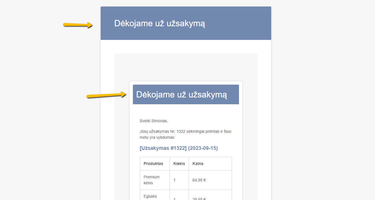

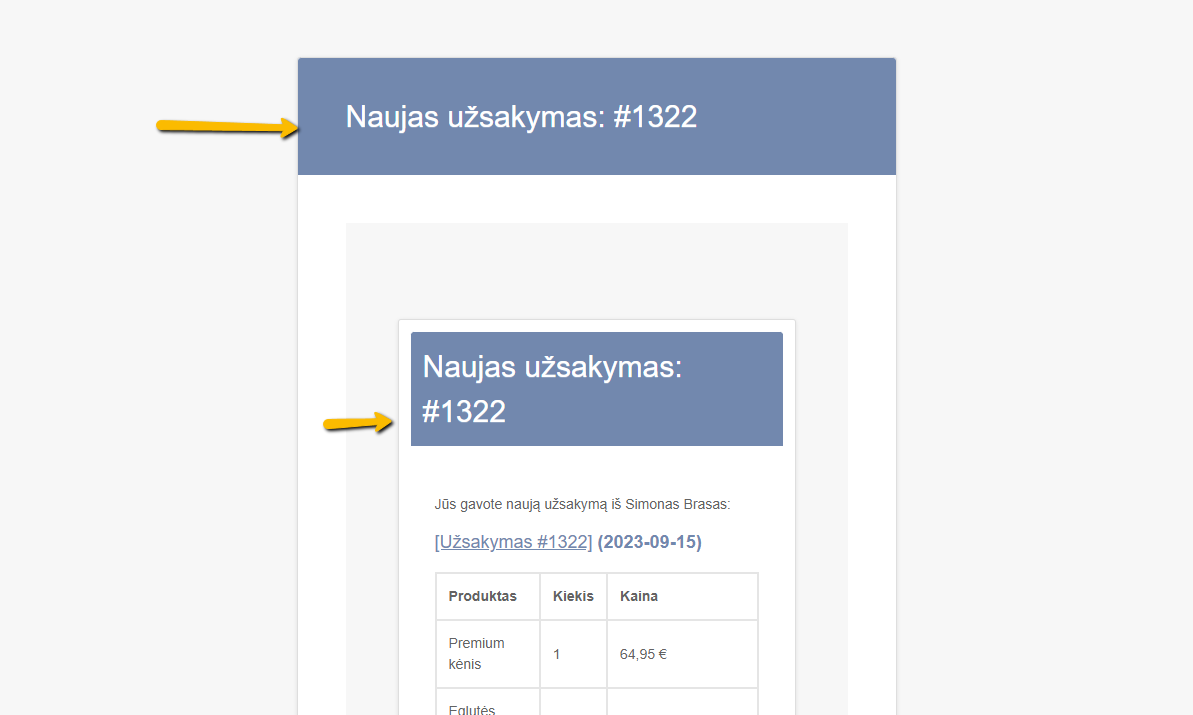

I am using woocommerce.
After installing WPML plugin, I have duplicate header(Customer New Order, Custome Proccesing Order) in wocoomerce email. Why?

linasP
Does the problem go away when you disable the WPML plugin?
Yes. VIDEO: hidden link Thats answer for the
What will be the result if I temporarily disable all plugins except WPML, WooCommerce and WooCommerce Multilingual?
Also check if there is a problem with any standard theme?
Custom fresh clean theme. This theme was used 9 years now and never had any problems like this.
Could you first update the WPML plugin to the latest version 4.6.6 and its extensions to take advantage of the latest fixes and improvements? This may not necessarily solve the problem, however, the best way to resolve it is to work with the latest available versions of the plugins.
We installed lateest as ytou can see in the video.
19 сентября, 2023 в 1:52 пп #14420119
Andrey
Languages: Английский (English ) Русский (Русский )
Thank you for the updates and for sharing the video.
The WordPress itself and the plugins are constantly evolving. If there is no issue with any default theme, i.e., Storefront, that means that some of your theme's templates could be outdated and need to be fixed there.
This ticket is now closed. If you're a WPML client and need related help, please open a new support ticket.
