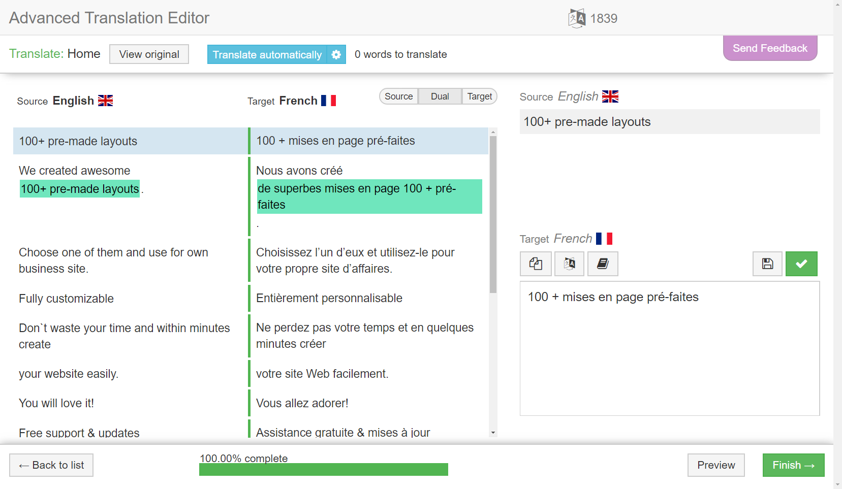

Betheme is already compatible with WPML. Yet, pages built with Betheme’s Muffin Builder were translatable using manual translation only, which required duplicating the page to the secondary language(s) then manually translating the page content. Now, you can translate Muffin Builder pages using WPML’s Advanced Translation Editor which makes the translation workflow much easier.
It is worth mentioning that Muffin Builder pages are also translatable using the classic translation editor.

Translating pages built using the Muffin Builder is similar to translating pages using the default WordPress editor. Simply, click the plus icon in the language box to translate the page into the desired language.
Click the plus icon to translate the page

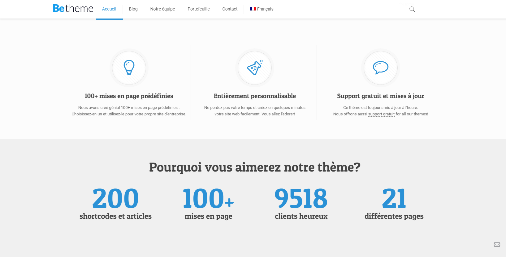

On the translation editor page, add the translated content, save the translation, and publish the page. This is how the translated page looks on the front-end:
Translated Muffin Builder page on the front-end
