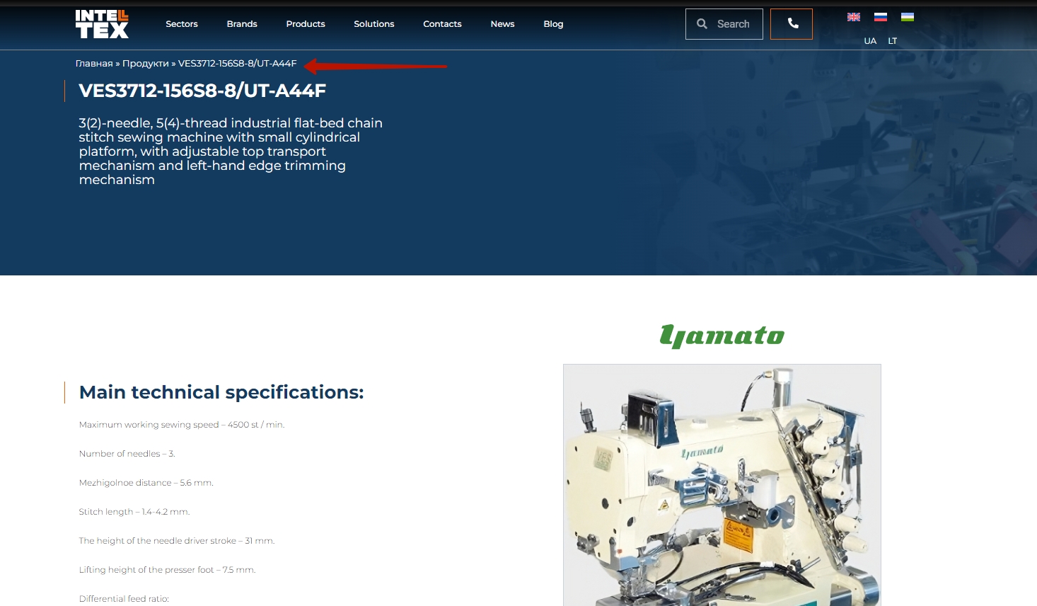

I am trying to translate breadcrumbs on my site скрытая ссылка using WPML.
Симптомы:
Breadcrumbs translation. How do you translate?
Вопросы:
How do you translate breadcrumbs using WPML?

Thanks for contacting WPML,
You should be able to translate breadcrumbs is String Translation. I'm sharing some steps with you that will help you to translate the Breadcrumb text properly :
- Please navigate to WPML > String Translation and search for the text on the Breadcrumb that you're trying to translate. Here is some very helpful documentation on how to use the String Translation plugin.
https://wpml.org/documentation/getting-started-guide/string-translation/
- If you're not seeing the text there, it would be better if you can scan the plugin/theme that you've used to create it and then go back to WPML > String Translation and see if the strings show up. Please follow the guide below to understand the procedure of finding the strings that don't appear in the String translation.
https://wpml.org/documentation/getting-started-guide/string-translation/finding-strings-that-dont-appear-on-the-string-translation-page/
I hope these steps will help. If you need further assistance in this matter, please let me know.
