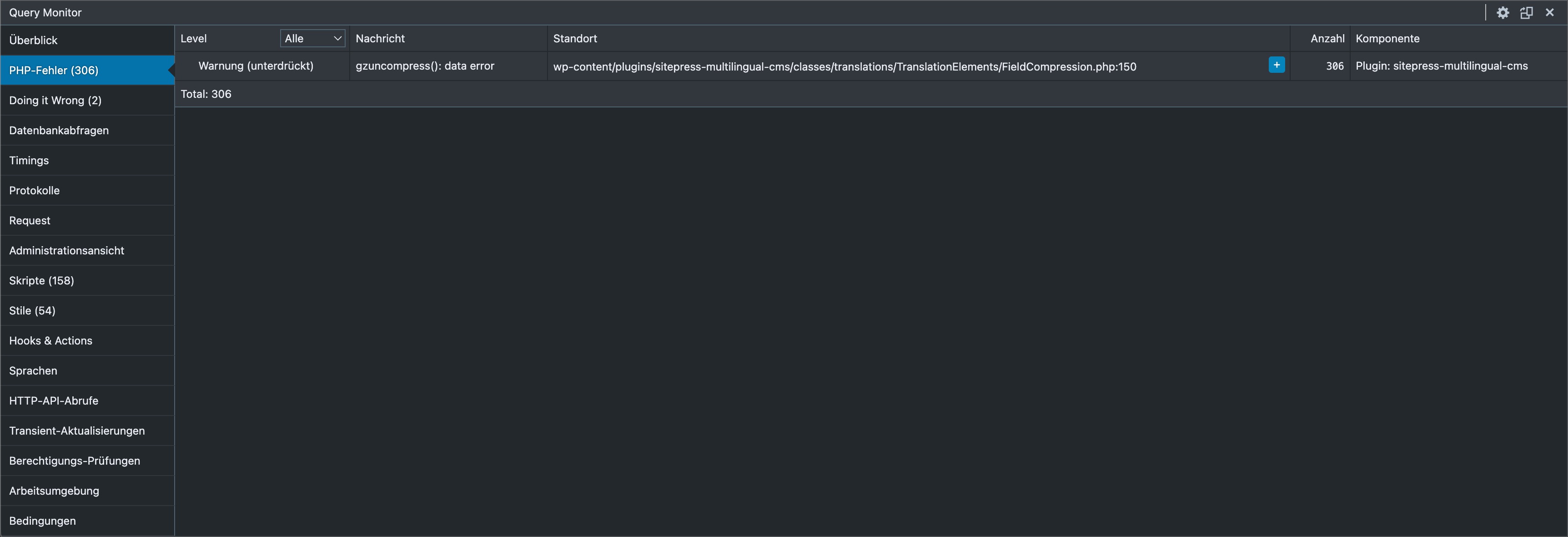

I am trying to access a custom post type listing via the WordPress backend.
Custom post type overview loading took nearly 3 minutes to load.
Posts overview is also slow.
We're using PHP 8.3 and automatic translations.
I have used Query Monitor, which suggests that the issue is caused by a slow WPML query.
I've followed multiple recommendation of yours to increase performance – but none of them have anything to do with the backend queries, so did not help. I've attached screenshots of the Query Monitor.
Why is the post listing taking so long to load?
How can this be fixed?
My customer is understandably upset that he can't easily edit his posts due to long wait times.
On a side note.. there's 306 PHP Errors that could probably be avoided on your end (see screenshot attached).
Here's the query that causes a long wait time on my custom post type listing (see screenshots attached):
