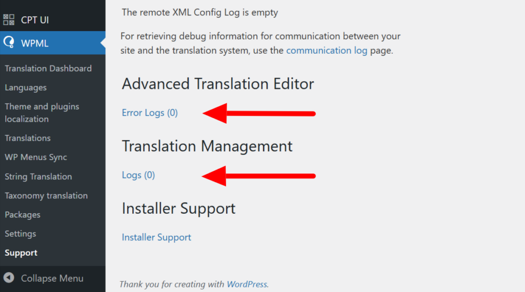

To record a debug log in WPML:
  1. Go to WPML → Support.
  2. Scroll until you see the Advanced Translation Editor and Translation Management sections.
  3. Click the Logs link under each one.
Error log links in WPML’s Support screen
