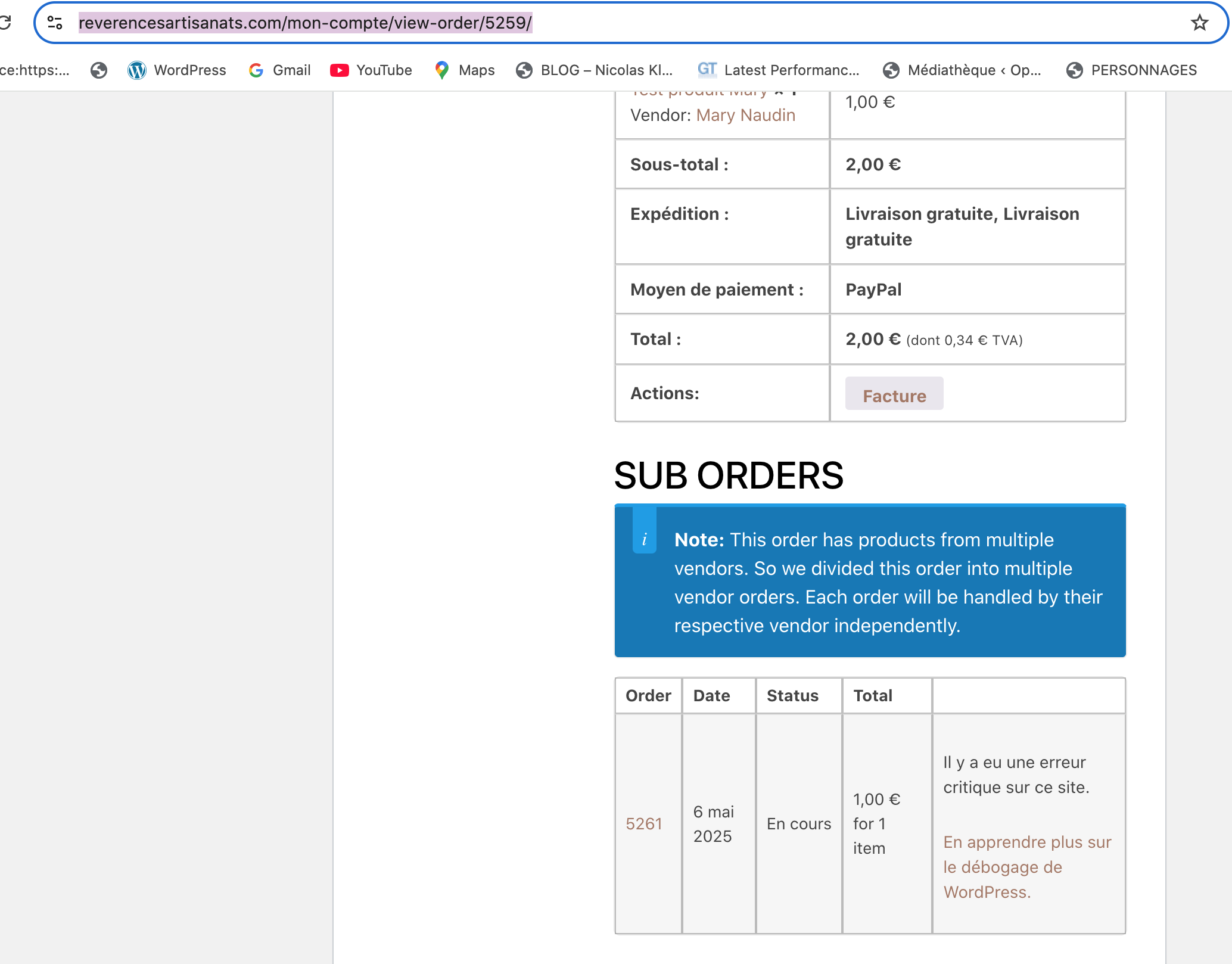

Contexte de la question:
I am trying to use the WPML plugin with the Dokan invoice plugin on my website lien caché. I encountered an issue while doing so. The problem can be seen on the page lien caché.
Symptômes:
Il ya une erreure citique.
What is causing the critical error when using WPML with the Dokan invoice plugin?

mai 14, 2025 à 7:23 pm #17034203
Ilyes
Please check if you are getting any errors or warnings related to WPML in the WordPress Debug log or Server Error Log while having this issue. May you need your hosting team's support to access the server error log file.
To enable WP debug log, open your wp-config.php file and look for:
define('WP_DEBUG', false);
And change it to:
define('WP_DEBUG', true);
// Enable Debug logging to the /wp-content/debug.log file
define('WP_DEBUG_LOG', true);
// Disable display of errors and warnings which is recommended on a live site.
define('WP_DEBUG_DISPLAY', false);
@ini_set('display_errors',0);
Then try to reproduce the issue and check if any errors were saved to the debug.log log file inside the /wp-content/ directory
If you can paste your debug.log to https://pastebin.com/ and provide me that link, it would be great!
Best,
