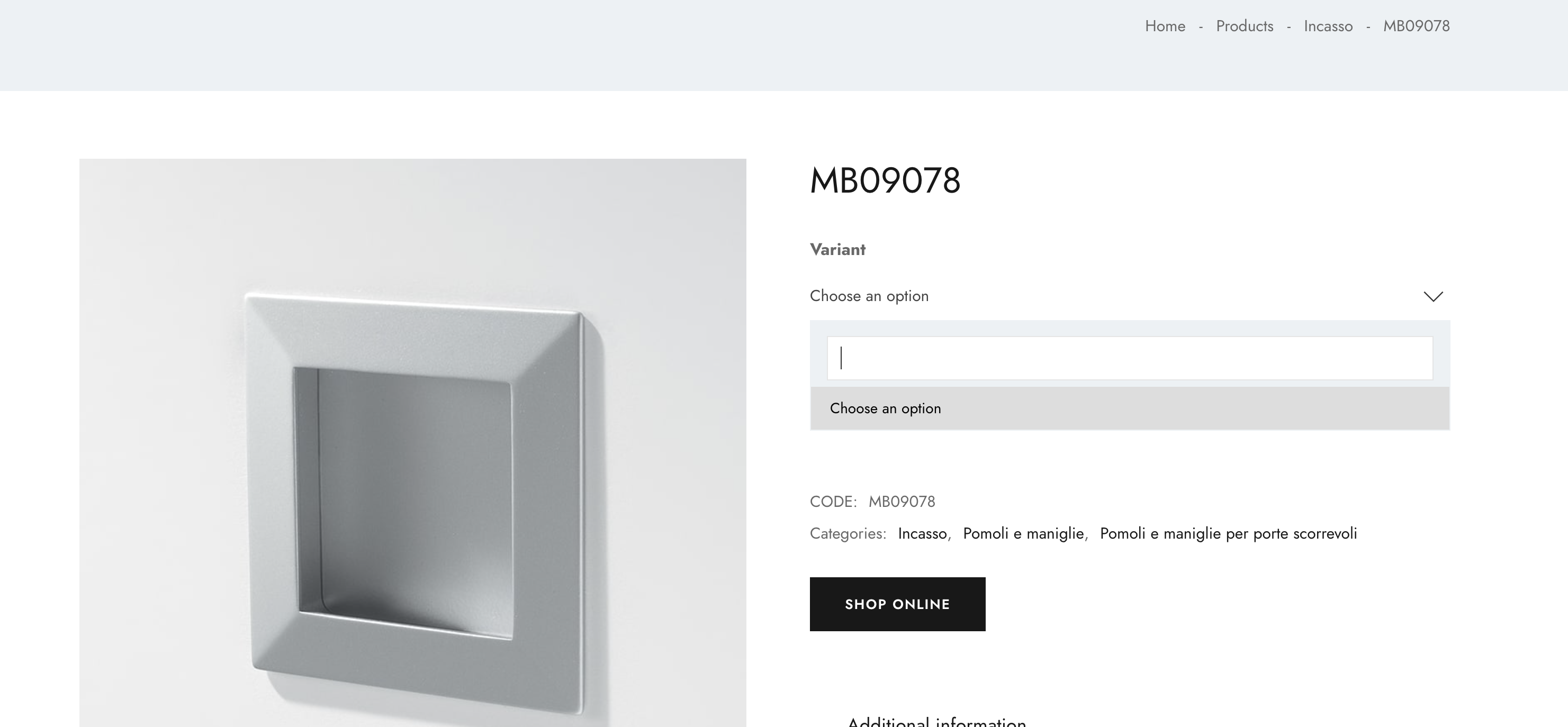

I am trying to activate in woocommerce the Variations for the products I added.
In the main Italian it works in the products I added months ago as well in the new products I added they only work in the main language Italian and not in English

Unfortunately it doesn't resolve itself. I followed the procedure described but without finding a resolution.
Marzo 19, 2024 alle 7:38 am #15424240
leonardoP-18
I also tried saving the product but it doesn't work. Can I give you access to the backend to verify?
