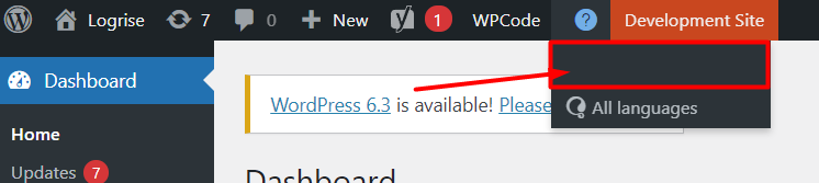

A full copy of this site has been made. This site was on another server, so the database and files were copied. After this copy, we found that WPML stopped working.
If possible, we ask for your help.

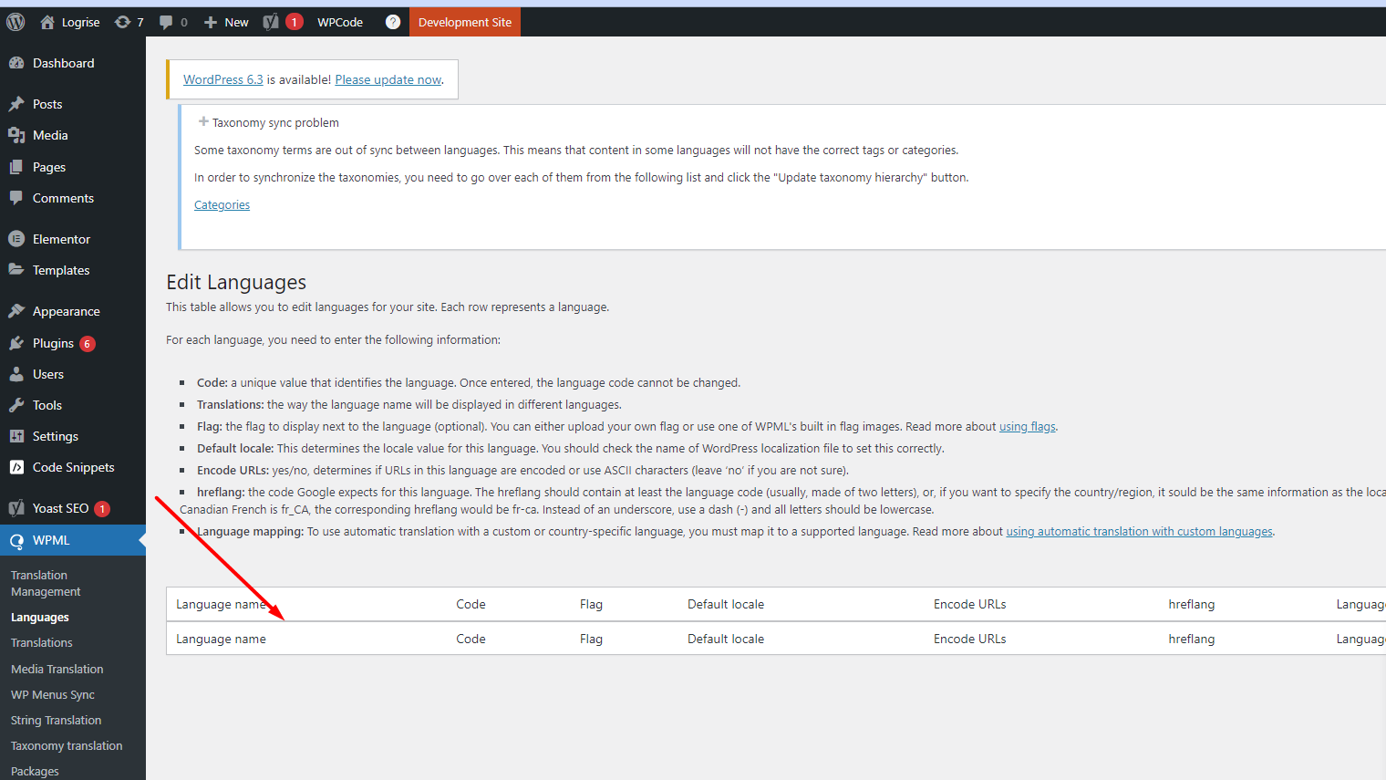

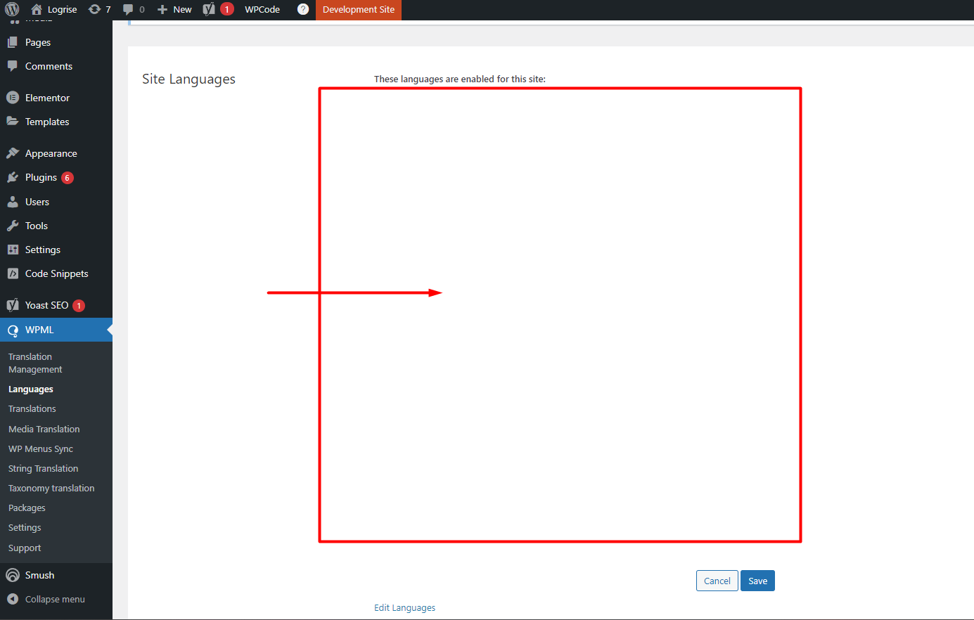

Hi Mateus,
Thank you very much for your reply.
We've been looking at the articles you sent us and they haven't helped.
I am attaching some print screens of areas of WPML where there is no language information.
If necessary, we can provide access to the site's BO for analysis.
Best regards

We could solve the issue by following these steps:
- We went to WPML -> Languages
- Since there was no language added in the website, we added 'French' first, and set it as the new default language
- Then we added the rest of the languages and reverted the default language to Portuguese
This seems to have done the trick. Could you please double-check and tel us if everything is fine now? Thank you.
