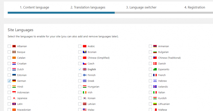

Once you’ve installed WPML Multilingual CMS and its components, you can go through the WPML setup wizard to configure your basic language settings (like which languages you’d like to translate your Elementor designs into).
For this example, we’re going to translate our template into German (with Google Translate – sorry for any mistakes, German grammar sticklers!):

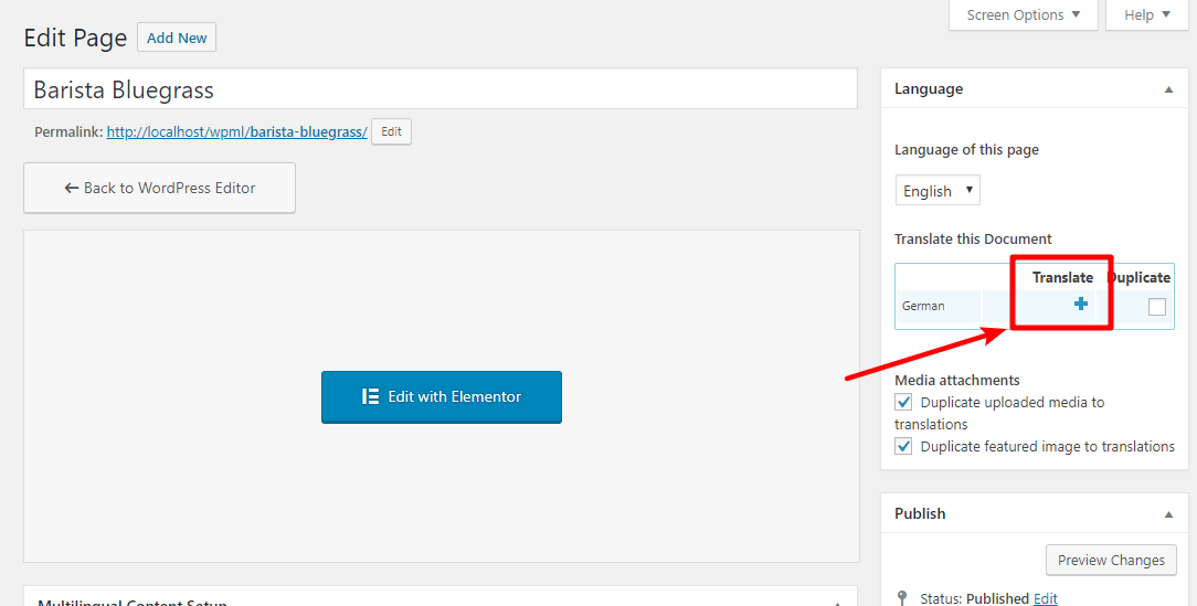

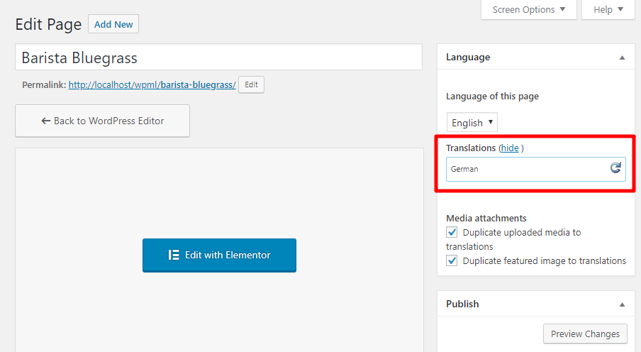

Once you’ve set up WPML’s basic settings, go to the WordPress dashboard editor for the Elementor page that you want to translate (don’t open the Elementor editor – stay in the regular WordPress editor).

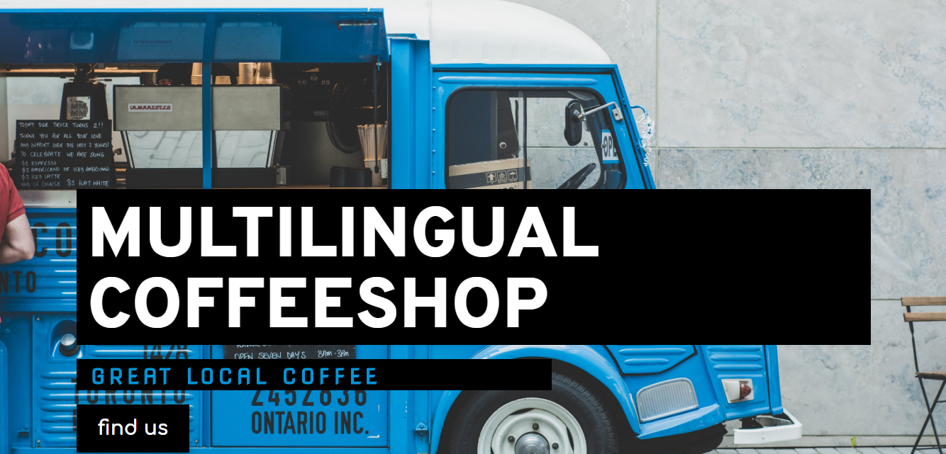

Here’s what the EasyThemePacks Barista Bluegrass template looks like in its native English:
In just a few minutes, we’ll be able to translate it into German!

In the WordPress Editor, click on the + icon to create a new translation of your Elementor design:

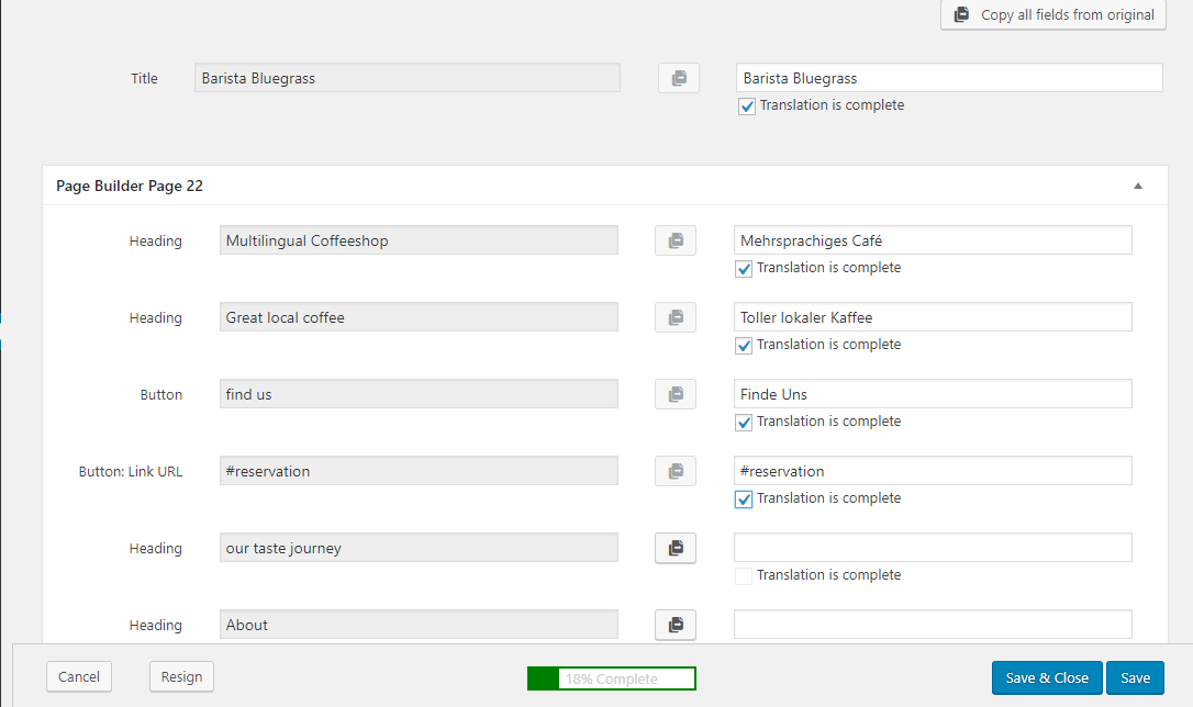

This will open up a handy side-by-side editor. On the left side, you’ll see all the information from the original English translation. WPML pulls in every individual string from your Elementor design, as well as other helpful attributes (like the URL that a button links to so that you can send users to the proper translation).
To start translating your Elementor template, you just need to enter the translation in the corresponding box on the right side:
As you go through, make sure to mark each translation as Translation is complete so that you can quickly tell what’s been done and what still needs to be translated. Additionally, while you can always save partial work, you won’t be able to display your translation on the front end until you’ve marked everything as complete.
Once you finish up your translations and save them, you’re done!Now, you’ll be able to edit your existing translation whenever needed:

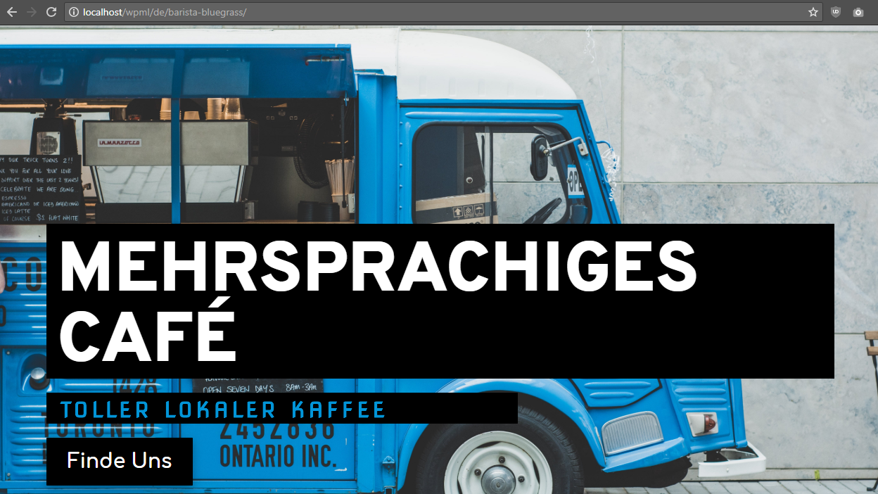

And if you go to the front end of your site, you’ll be able to access the translated version of your page by changing the URL according to your preferences (more on how to create a language switcher in a second!).
Here’s how the translated version of our EasyThemePacks template looks, including the URL structure so that you can see how everything is localized:

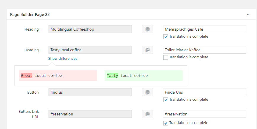

If you ever use the Elementor interface to edit the existing translation of your page, WPML will simply mark those translations in the editor and give you an option to show the differences:
WPML won’t do anything to already-translated strings that weren’t changed. So all you need to do is update the edited text and you’re good to go!

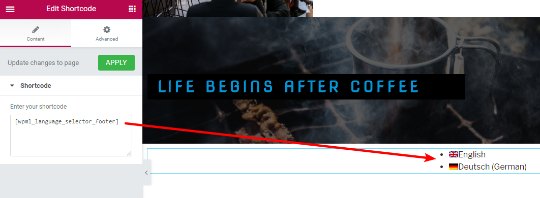

While you can create your own WPML language switcher using code, the easiest way is to just include a language switcher shortcode in your Elementor template.
To do that, place the Elementor Shortcode widget where you want it to display and include this shortcode:
{{wpml_language_selector_footer}}

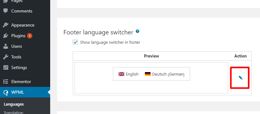

This shortcode will pull the settings for your WPML footer language switcher. To configure those settings, go to WPML → Languages in your WordPress dashboard and scroll down to the Footer language switcher section:

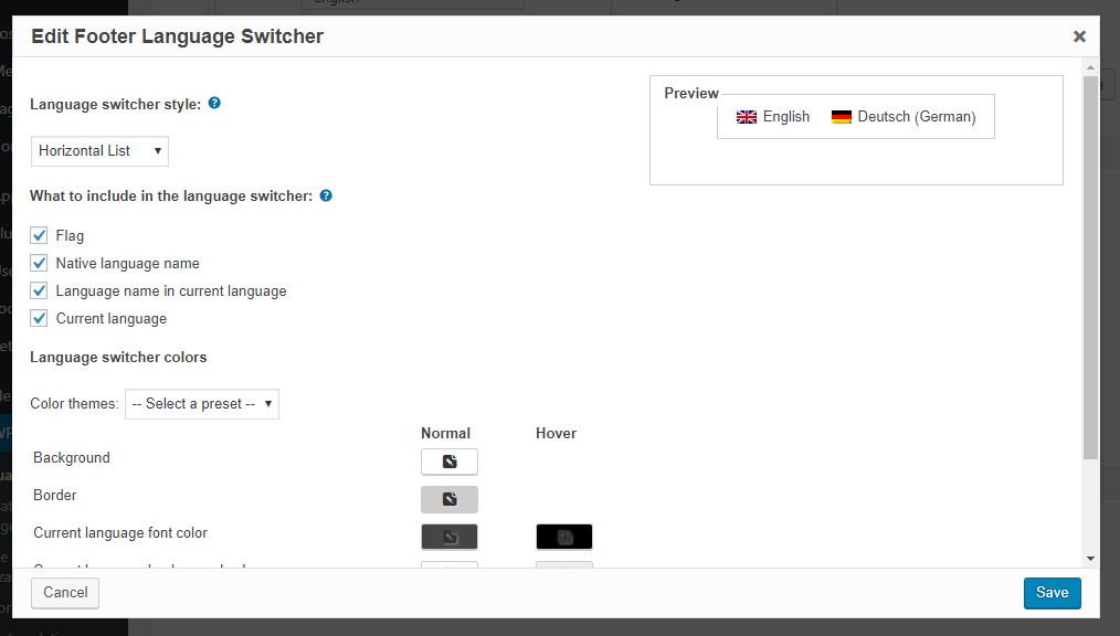

When you click on the pencil icon, you’ll be able to configure how your language switcher functions. You can:
  • Change the layout
  • Choose whether or not to display language names and flags
  • Choose a new color scheme
  • Configure individual elements’ styles
As a tip, using a language name is a great option as it allows people to search for their local language by using CTRL + F.
