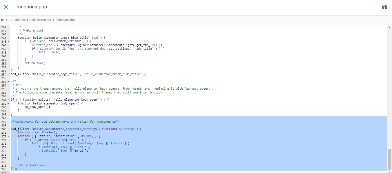

Hello Prosenjit,
Thank you for your response. I have applied the workoround as mentioned in the errata and as shown in the attached image, however the critical error (and the white screen) appears as soon as I activate the WPML String Translation plugin.
I am uploading a new debug.log file to show you updated errors:
enlace oculto
Thanks,
Juan
