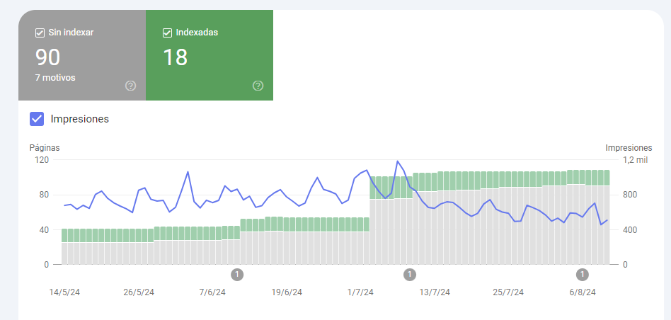

Al implementar wpml e ir organizando el multi idioma inglés se han desindexado distintas urls en español (selecionado como idioma predeterminado) perdiendo usuarios. Google search console nos seleciona lo siguiente:

Google Search Console indica "Página con redirección"

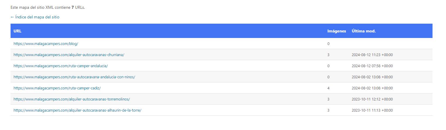

We observe that in the post the spanish version ones appear, but the only one we have in english does not appear in the sitemap. enlace oculto

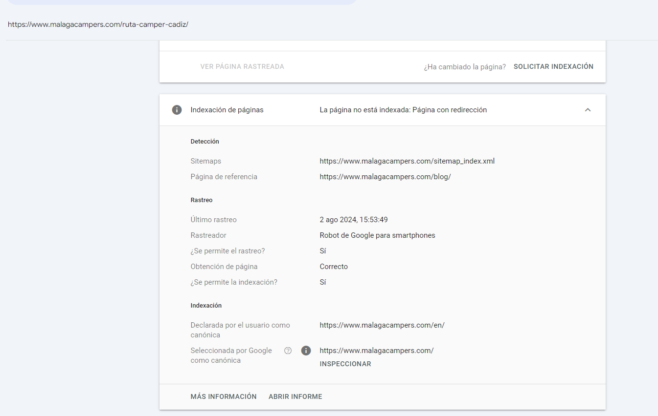

I have rechecked one of the urls of a Spanish entry that was ranked. It indicates that it is not indexed. But then in indexing it says that ‘Declared by the user as canonical
enlace oculto when we have not done this

I reviewed the sitemap and can confirm that the link you shared is present. You can see it in this screenshot: enlace oculto.

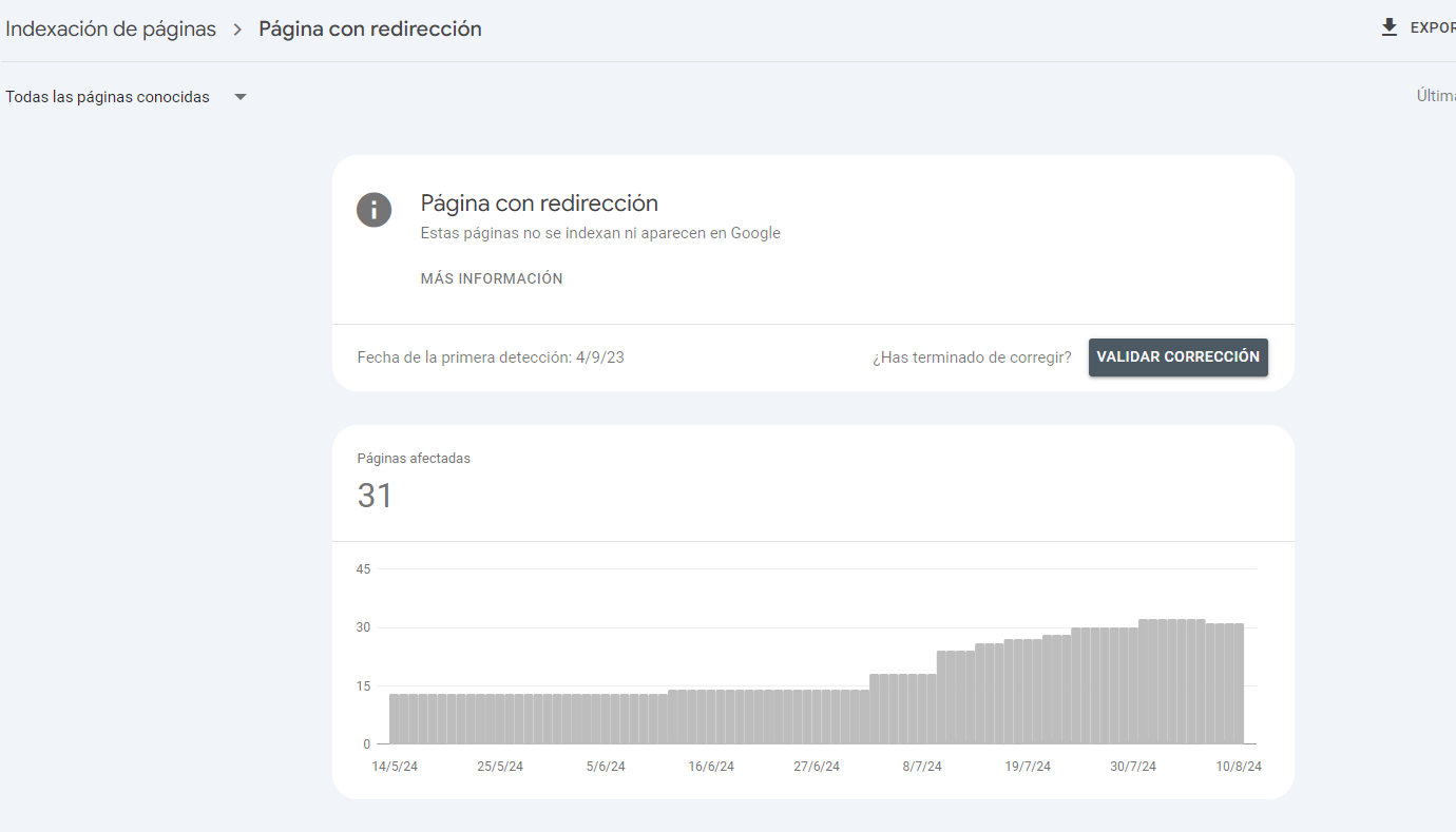

Now, let's stay focused on resolving the issue with the page being deindexed by Google Crawler. From the WPML Debug info, I noticed that the Browser Language Redirect option is enabled in WPML > Languages. Please be aware that enabling this option can impact Google indexing. The crawler bot may interpret the links as redirects, which could result in the page being flagged and not indexed. Please refer to the guide below to understand how Google indexing can be affected by using the Browser Language Redirect option.
- https://wpml.org/documentation/getting-started-guide/language-setup/automatic-redirect-based-on-browser-language/how-browser-language-redirect-affects-google-indexing/
Since the pages are flagged as redirects, it would be advisable to disable the Browser Language Redirect option and then resubmit the pages for a recrawl. I hope you'll not encounter any issues after that.

We have deactivated the redirection as you said, because it is possible that this is why we have the problem. We have also seen that in the sitemap of pages are the English ones, but in the sitemap of posts are not found the entries in English.
Best regards.
