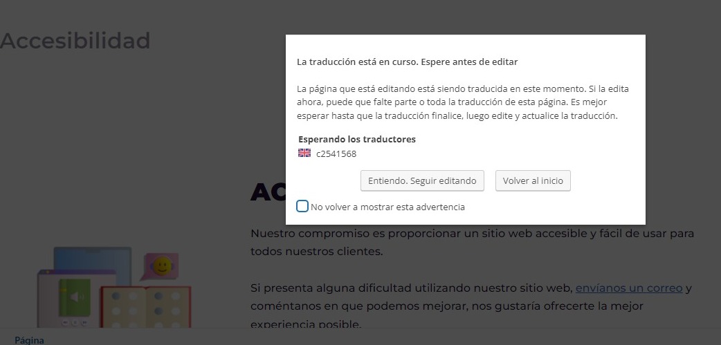

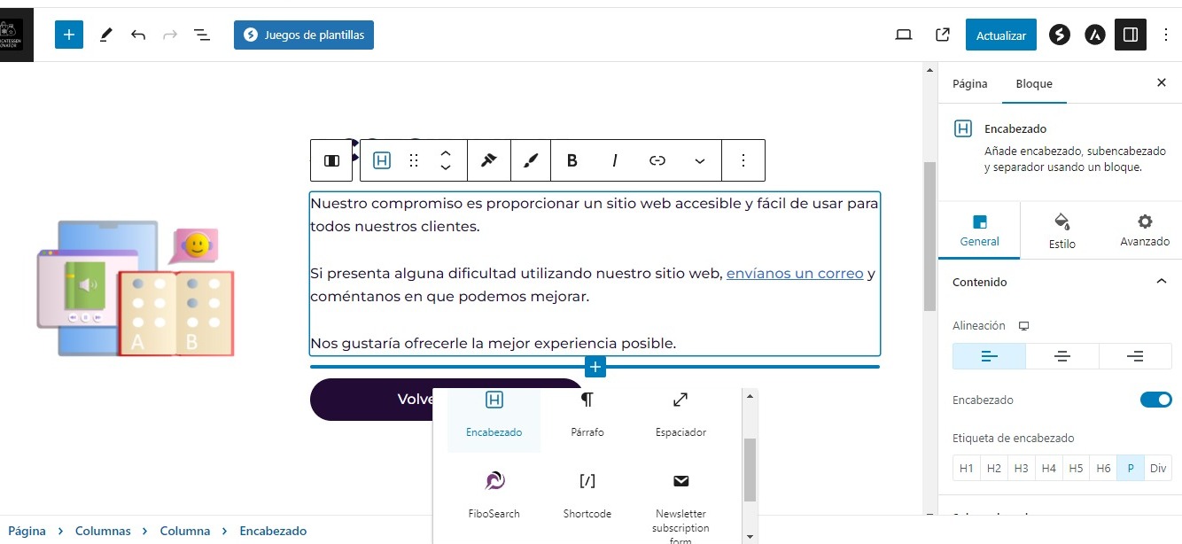

enero 12, 2024 a las 6:02 pm #15180501
jose-luisS-16
Hello good morning!
Thank you for your prompt response and support.
I have done what you mentioned, I already updated the plugins from WordPress and I still cannot translate the content of the advanced headers.
The advanced header comes as a wordpress builder tool, I just select advanced header and start writing the content or text I want.
I attach what appears to me when doing the translation.
If you need any additional information, I am at your service.
Aida Santiago

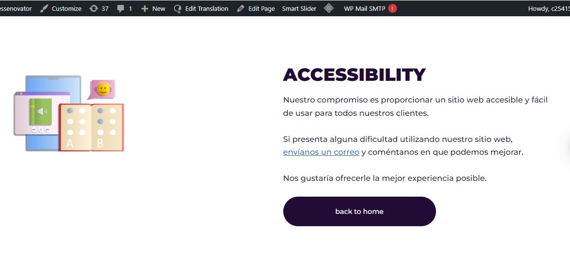

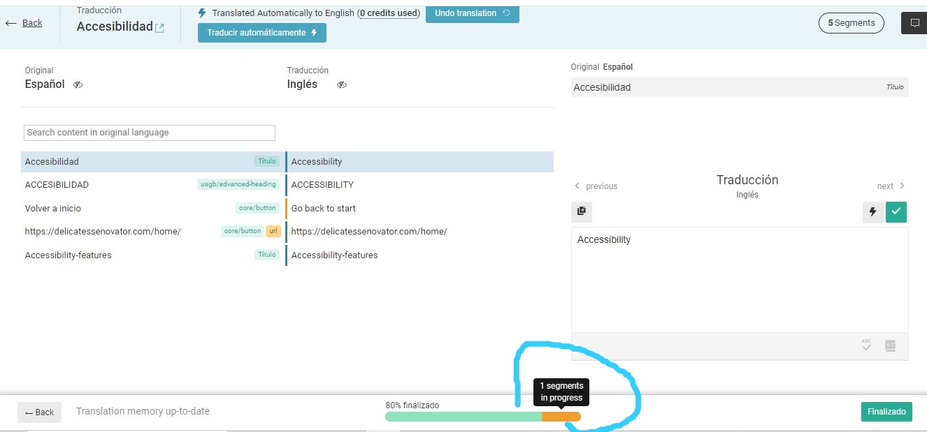

enero 15, 2024 a las 7:26 pm #15186764
jose-luisS-16
Hello good morning!
Thank you for responding and the availability of samples regarding the topic.
I already did what you told me to do but I still can't translate the advanced headers and not only on that page but on all the others where I use that tool.
It is worth mentioning that the Spectra update was carried out on the same day that you told me to update WPML.
I attach a screenshot of the messages that appear after modifying and updating.

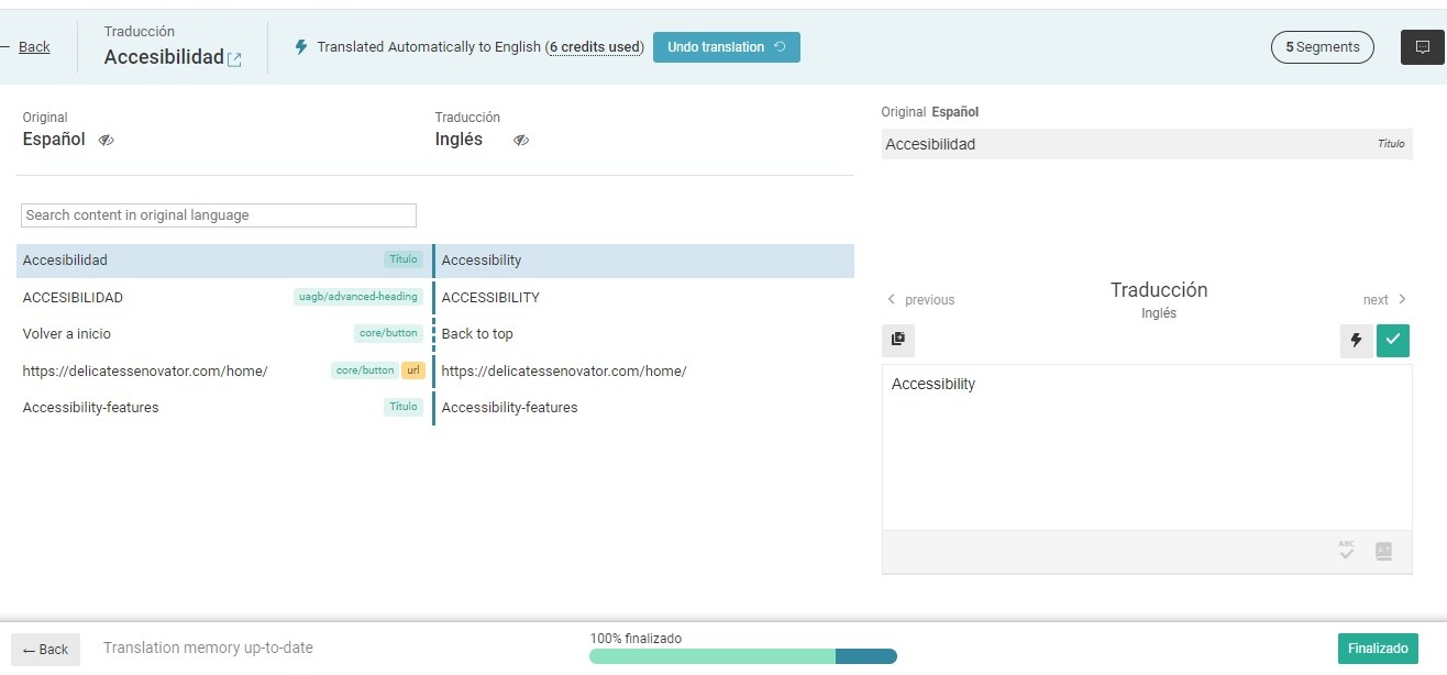

Hello Aida,
Thank you for sharing the access information.
1) Issue with Advance Heading content translation: According to the WPML Configuration file in the Spectra plugin, to translate the contents of the Advanced heading block, a specific tag must be chosen. For a clearer insight, please refer to this screenshot: enlace oculto. I opted for the Div tag, saved the changes, and upon updating the translation, I noticed that the contents were now present in the translation editor. With Automatic translation enabled, these contents were translated automatically. Consequently, the contents are now correctly displayed in the English version of the page.
