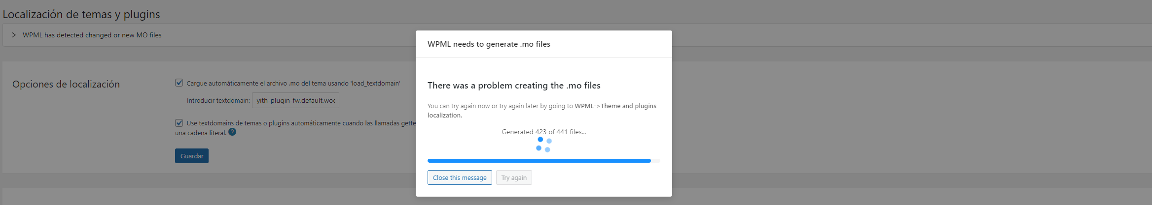

Antecedentes del problema:
Estoy intentando resolver un problema relacionado con la generación de archivos .MO en WPML. En respuesta a https://wpml.org/es/forums/topic/error-generating-mo-files-3/?ref=wd, el problema persiste tanto con PHP 8.3 como con PHP 8.1.
Síntomas:
No se generan los archivos .MO como se esperaba.
Preguntas:
¿Por qué no se generan los archivos .MO?
¿Cómo puedo solucionar el problema de generación de archivos .MO en WPML con PHP 8.1 y 8.3?

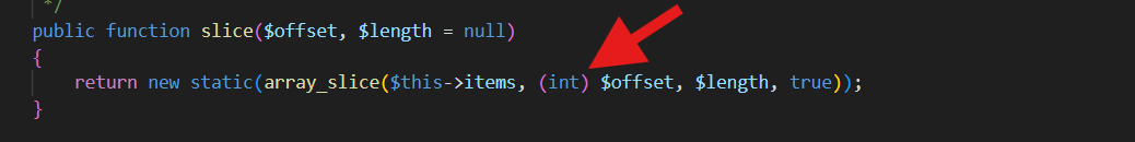

I have investigated the issue and discovered that a variable in the WPML core file is unexpectedly receiving a string value instead of an integer. This could be due to a conflict between plugins or code changes in the theme.
As a temporary solution, I modified the code where the error occurs by casting the problematic variable to an integer. This adjustment allows the MO file generation process to proceed successfully. Please review the attached screenshots for further details.
You can now generate the MO files without any issues. Since MO files need to be generated only once, please continue to use this workaround until we release an update for WPML.
I hope it helps. Feel free to let me know if you need further assistance in this matter. I will be happy to help.
Prosenjit

Hi There,
I hope you're doing well. Sorry for the delay in responding due to the weekend.
I'm happy to be able to assist you with this issue.
The file name is `Collection.php`, located at `/wp-content/plugins/sitepress-multilingual-cms/vendor/wpml/collect/src/Illuminate/Support/`.
I made the change on line 952. Please review the attached screenshot and make the same change on your staging site.
Prosenjit
