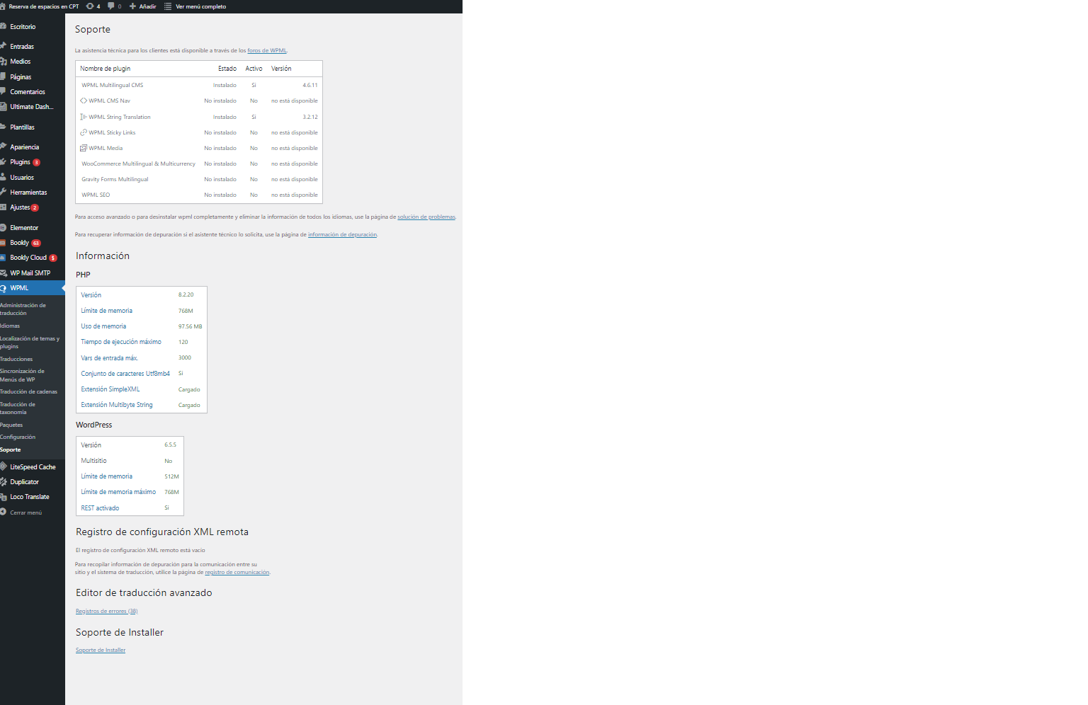

julio 3, 2024 a las 09:03 #15882558
inakiE-4
I don't see that option in my installation:
This is the link that is translated into strings and does not appear in the frontend, it is everything related to Bookly strings
enlace oculto
julio 4, 2024 a las 02:38 #15887913
Prosenjit Barman
Partidario de WPML desde 03/2023
Idiomas: Inglés (English )
Zona horaria: Asia/Dhaka (GMT+06:00)
Hi There,
Thank you for the update.
The WordPress Admin language is set to Spanish, which is why the exact option is not showing. Please navigate to "Usuarios > Perfil" in your WordPress dashboard and change the Language option to English.
Then, continue to follow the steps I shared in my previous message and you should see the options.
I also checked the Form page and noticed that the Spanish strings are showing in the Basque language. I hope the steps I shared above will help to fix the translation issue. If not, I will be happy to take a closer look and assist you further.

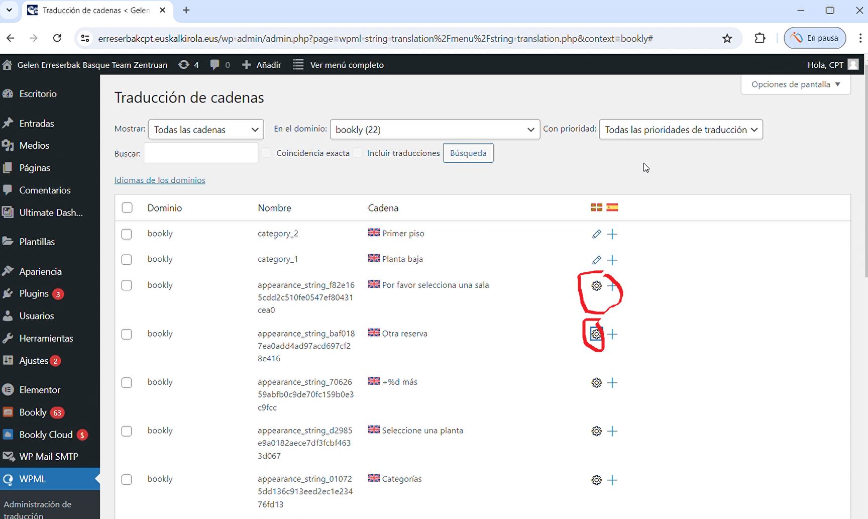

julio 4, 2024 a las 05:30 #15888896
inakiE-4
I have followed the indicated steps but it still doesn't work. There are strings that do show in Basque but most of them don't
could you access to my site and take a look at it, and see what am I doing wrong?

julio 5, 2024 en 08:58 #15897274
inakiE-4
If you try to click on the settings it doesn't work. All strings are translated in the translator, but they do not appear on the frontend
