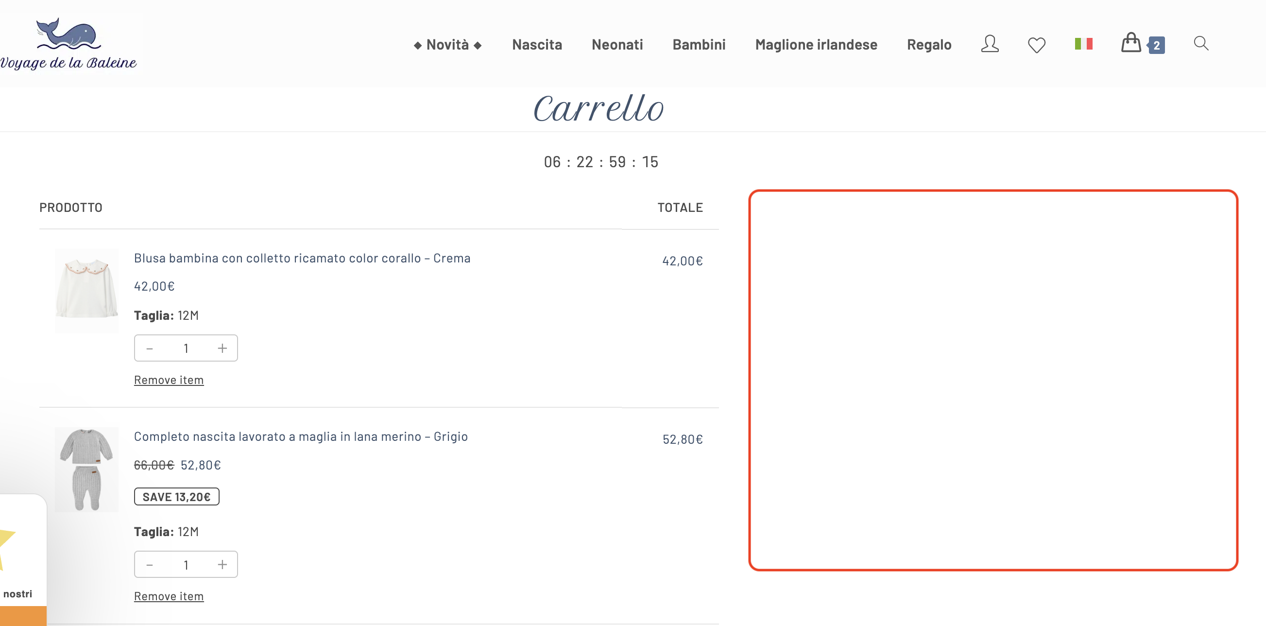

floreV

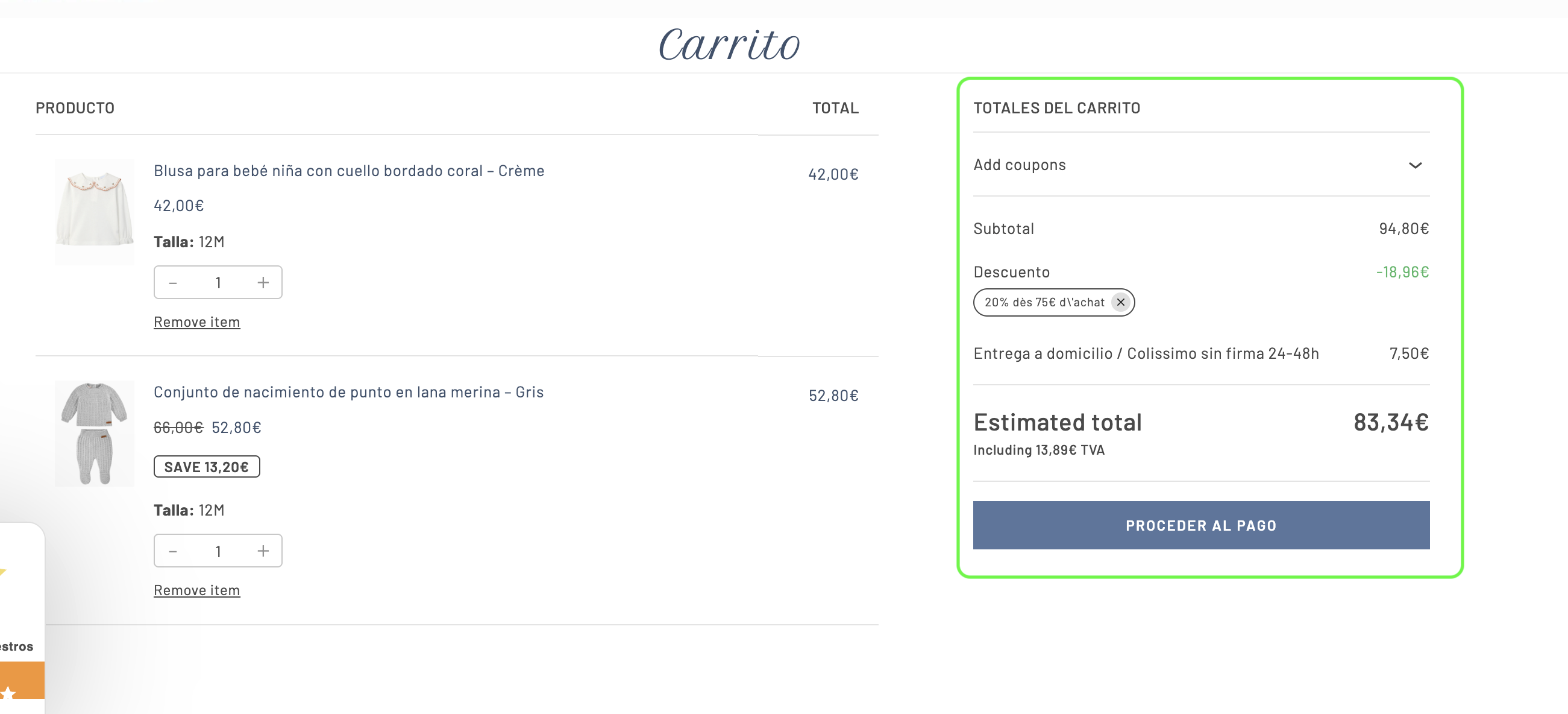

Bonjour,
J'ai un problème avec la page panier dans la version italienne de mon site : il est impossible de payer le panier car on ne peux pas le valider !
Je n'ai pas le problème dans les versions espagnole et anglaise de mon site.
Je vous envoie une capture écran de la page panier version italienne et de la page panier version espagnole pour que vous puissiez voir le problème : c'est la partie sur la droite qui manque dans la version italienne.
Merci d'avance pour votre aide.

Hi Flore,
I’m Long from the WPML Development team, I’m happy to help you with this issue.
I can see the issue with translation Cart in Italian language but it still works well in other languages. I would like to request temporary access (wp-admin and FTP) to your site so I can take a better look at the issue. It would be better to have a testing site where the issue is replicated. Your next reply is set to private to share the info.

I check the error log and Console tab of the browser when visiting the Cart page in Italian but don't see any related error message.
There could be a connection issue between the original Cart page and its translation in Italian, then I fix the issue by re-creating the translation Cart page:
- delete the Cart page in Italian
- go to WooCommerce > WCML > Status tab
- click on Create missing translation page in the section WooCommerce Store Pages
Now you can see the Cart page in Italian works properly, please check the attached screenshot.

I fix the issue with the Cart page in the Spanish language. Please recheck and let me know if you still experience it.
Thanks.

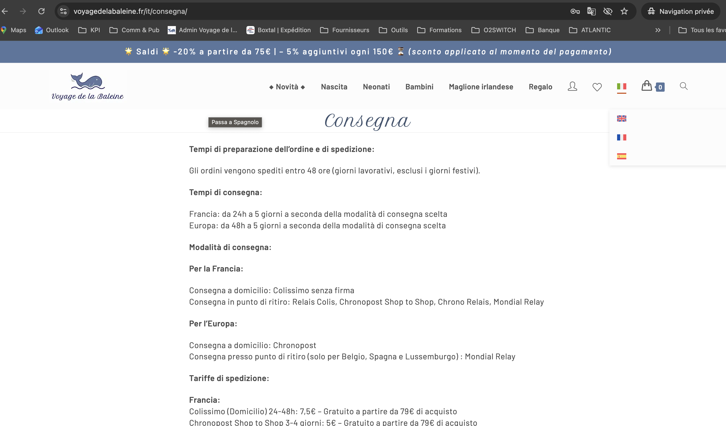

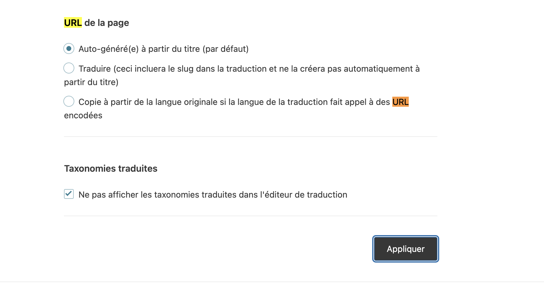

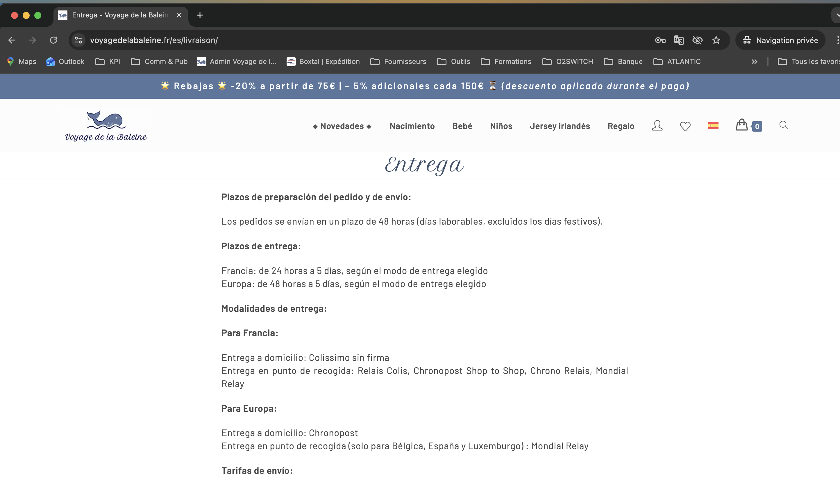

1) I noticed that the URLs of the pages are not translated in Spanish while they are translated in Italian. Please see the print screen attached.
I have enabled the option "automatically translate URL with the page title" in WPML settings so I don't understand why it is not translated.
How can I make the URLs translated in the Spanish version of my website please?

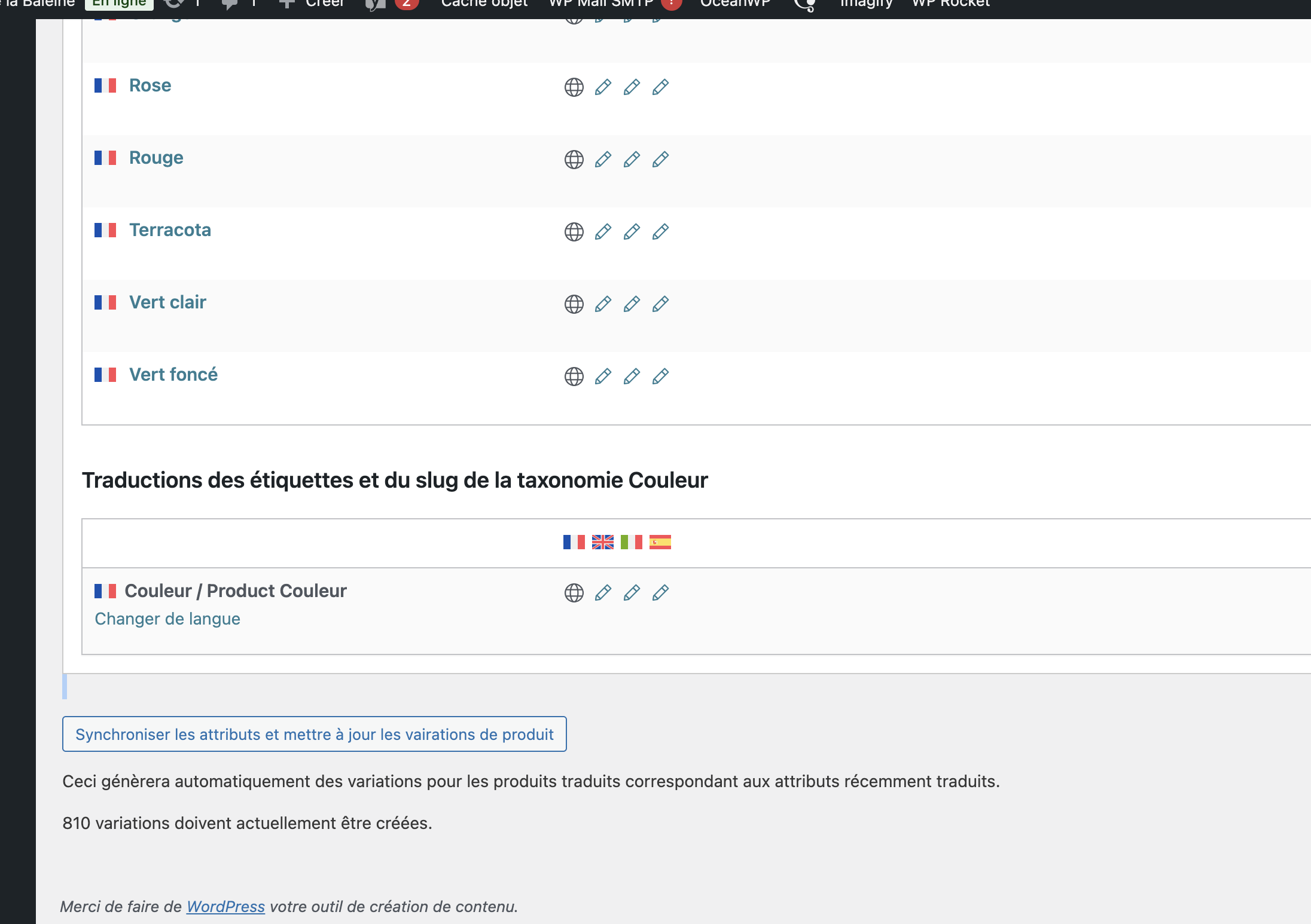

2) In WPML / Taxonomy translation : for each taxonomy, Do I need to click on "synchronize attributes and update product variations" ? see the print screen attached.
Many thanks for your help.

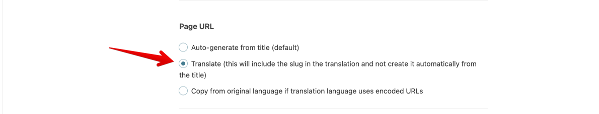

2. I noticed that the URLs of the pages are not translated in Spanish while they are translated in Italian.
Please notice that the option "Auto-generate from title (default)" will work at once, after creating the translation page. It doesn't re-update the page slug after you update the page title.
It is possible that the translation page in the Spanish language has the same title "Livraison" for the first time, then the title is updated to "Entrega". You can try to create a new page and recheck this feature.
If you want to update the page slug, you can:
- edit the page in admin area > Switch to Spanish language and update it manually.
- or use the option "Translate (this will include the slug in the translation and not create it automatically from the title)", then the page slug is available in the translation editor for translation every time.
3. Do I need to click on "synchronize attributes and update product variations"?
This is used for troubleshooting. For example, if you import product/content to your site and somehow the translation variations are missing in the translation product, you can use this feature for all product taxonomies. Please create a backup of your site before proceeding.

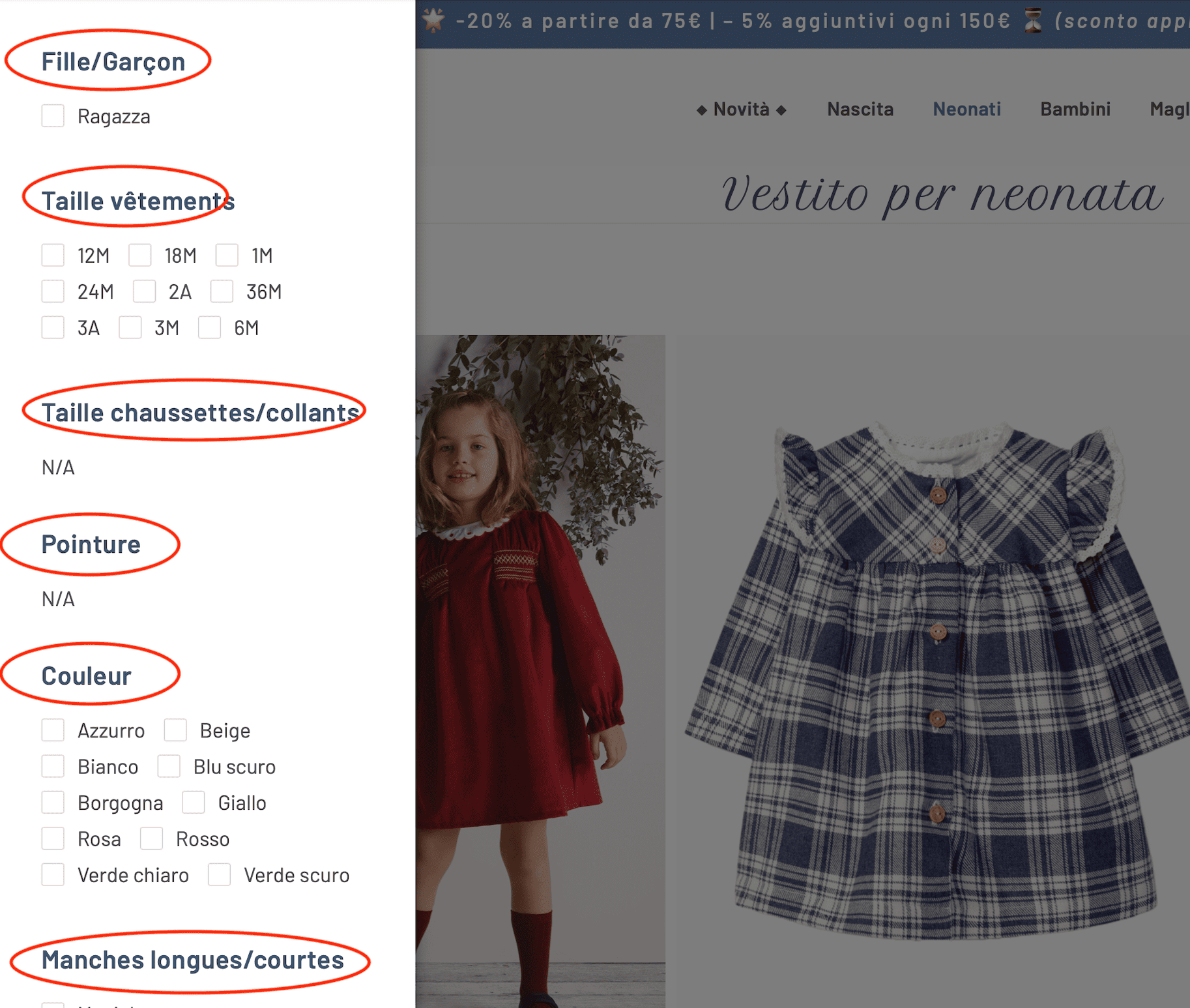

I have another issue : I am using the plugin "WCAPF - WooCommerce Ajax Product Filter" to filter the products on the archive pages but I do not find how to translate the titles of the filters (see print screen attached).
I checked the string translation but could not find the related strings.
Thanks for your help.

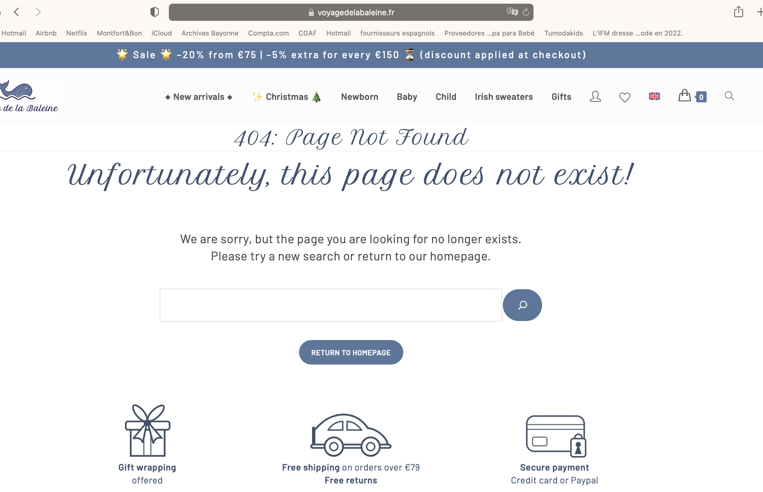

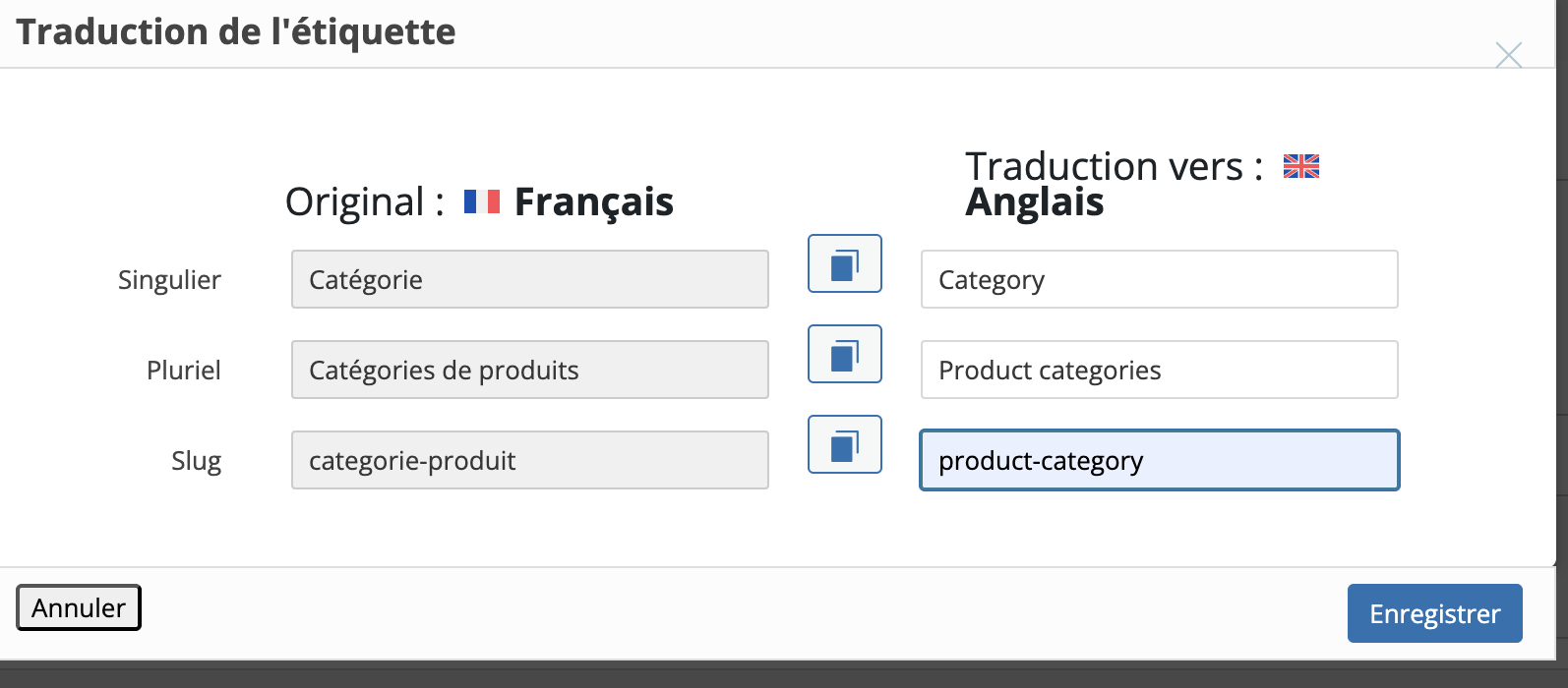

I also noticed that the slug taxonomy of my products categories are not translated because I have not entered a translation.
Thus, I have tried to enter one in English for example : "product-category" but when I do that, all the links in the menu are broken an I get a 404 error message.
See attached.
How can I change the slugs and make the links work again in the menu?
I get the same issue by the way when I translate the URL of my pages in Spanish and then, the links to the pages in the footer are broken.
Thanks!
