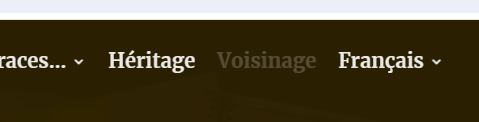

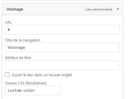

Contexte de la question:
Dans mes menus, vous pouvez voir un élément grisé. Je l'obtiens en entrant la classe "custom-color" dans mon élément de menu, avec le CSS suivant :

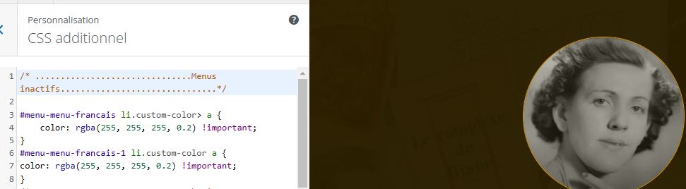

#menu-menu-francais li.custom-color> a {
color: rgba(255, 255, 255, 0.2) !important;
#menu-menu-francais-1 li.custom-color a {
#menu-de-francoise li.custom-color a {
#menu-sur-francoise li.custom-color a {

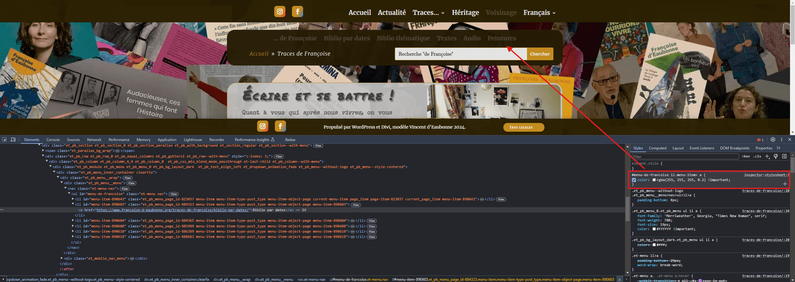

I checked the link again and realized I previously missed the menu with the menu-de-francoise ID. Therefore, the CSS I shared would work for the primary menu in the header, not the secondary menu with the ID menu-de-francoise.
I found the menu and noticed that there is no class named custom-color with the menu items. Which is why, the CSS you were previously trying to use wasn't working. I added the class menu-item in the CSS and the styles applied correctly in the menu items. Please check the attached screenshot.
I'm also including the corrected CSS below.
#menu-de-francoise li.menu-item> a {
Please give it a try and let me know how it goes. I'll be happy to help if you need further assistance in this matter.
