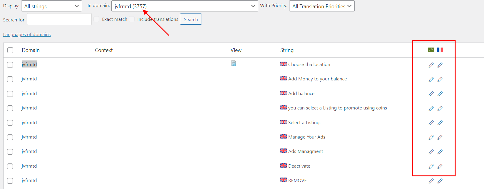

La traduction d'un paquet de chaînes (string package) n'était pas délivrée sur le site.
Ces travaux de traduction étaient assez long (3700 segments) et pour résoudre le problème nous avons dû augmenter le 'max_input_vars' de 5000 to 8000
- Accéder aux fichiers de votre serveurs via FTP ou Cpanel
- Faites un back up de votre fichier htaccess
- Éditez le fichier htaccess pour y ajouter cette ligne:
php_value max_input_vars 8000

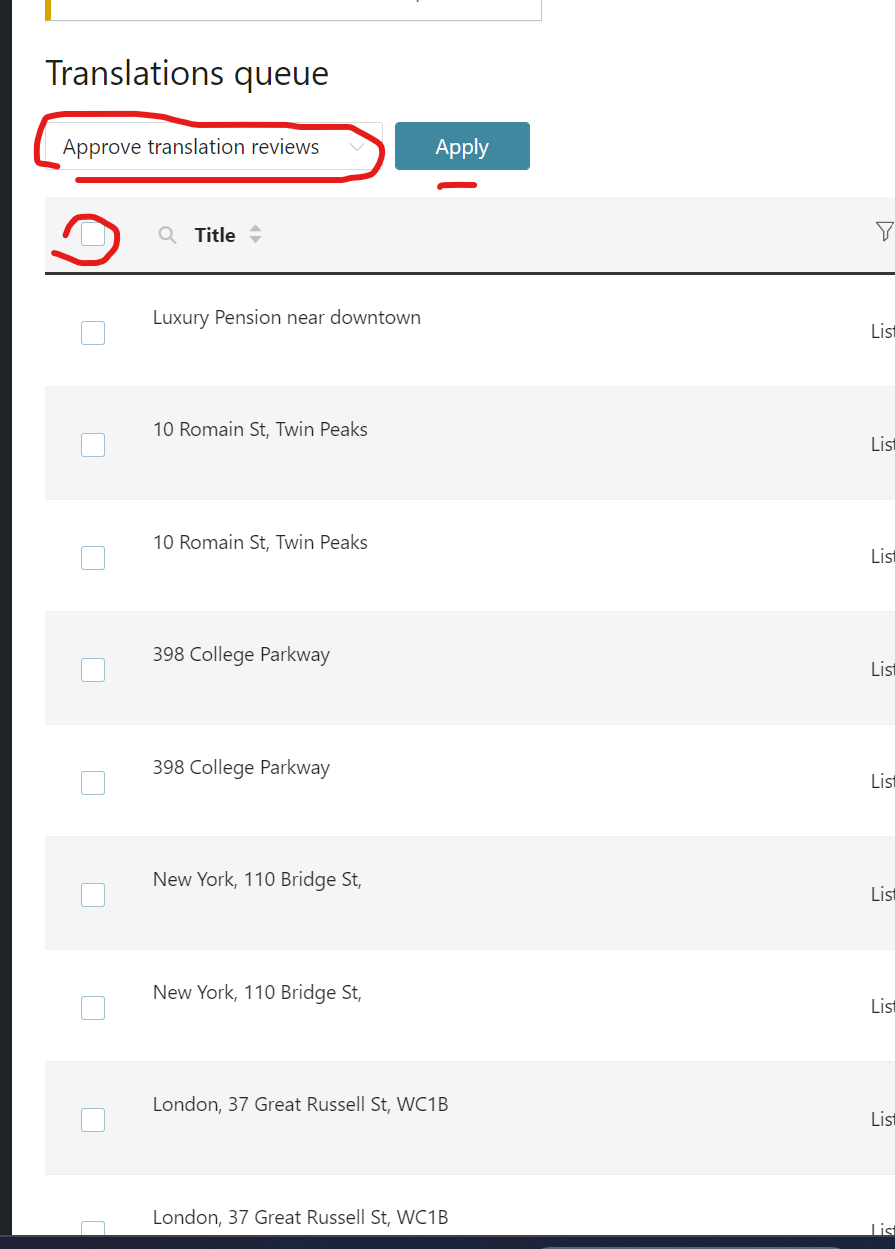

saidB-4
Bonjour ,
1- Comment faire une validation groupée de la traduction automatique
2- L'éditeur se charge lentement

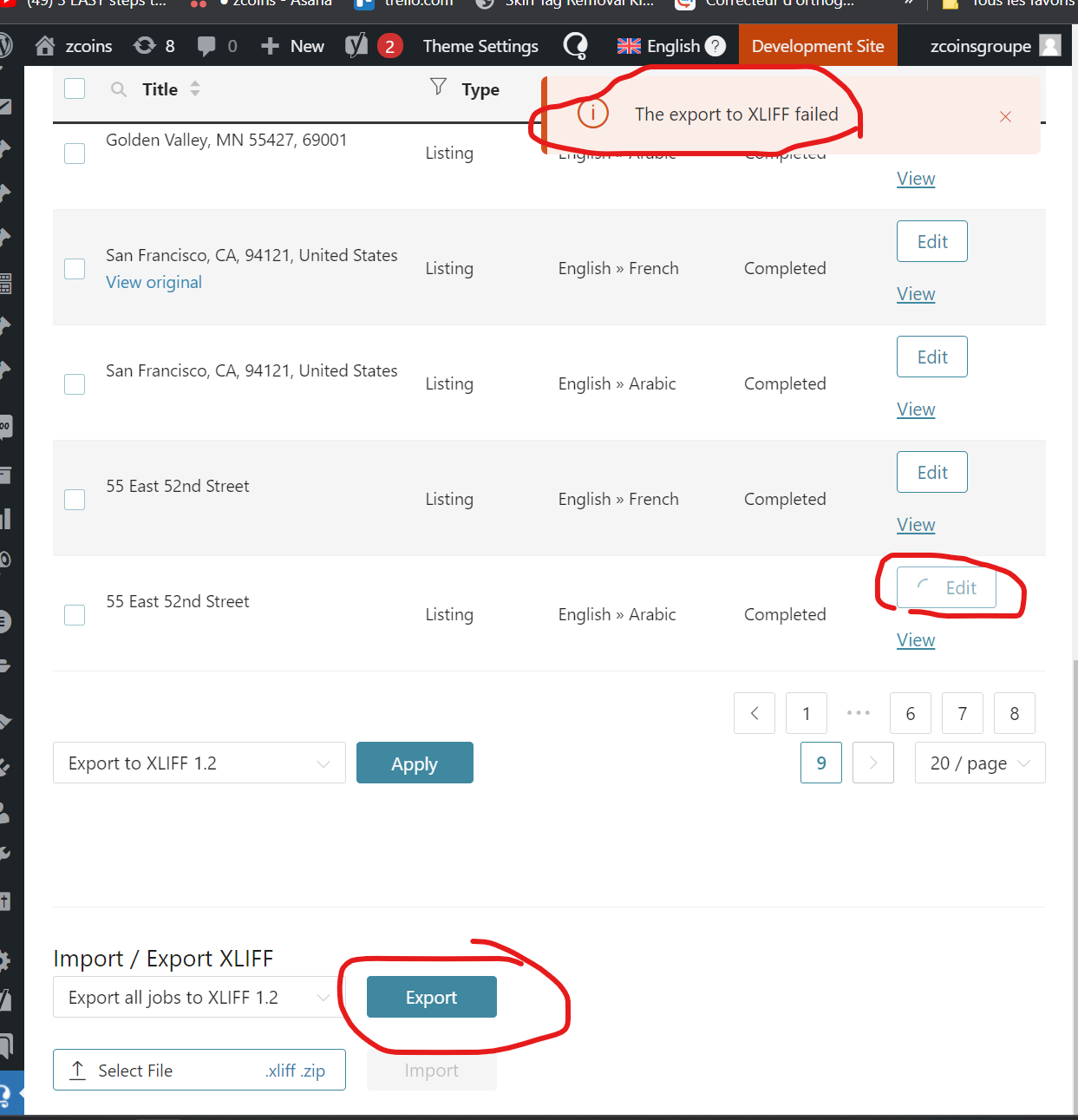

3- je n'arrive pas à exporter le fichier (Export XLIFF)
Merci

1) You ask how you can review automatic translations in bulk. go to WPML > Translation Management > Translators and make sure you're part of the translators for the desired language pairs. afterwards go to the jobs tab (only available if you are working with "translate what you choose", otherwise you can use the "dashboard" tab). and select the jobs with the "eye" icon and then in the dropdown menu select "approve translation review".
Make sure you flush any type of cache you have on your site (whether it's from a plugin or from your server) or you might not see the results.

3) About the XLIFF File, could it be those pages were previously translated automatically? at the same time, in the screenshot, it doesn't seem like you selected the pages you wanted to export, so it could also be that the process failed because no job was selected.
Let me know how it goes so we can understand how to continue.

So, the two jobs I cancelled were related to strings from the 'jvfrmtd' domain.
- One in French and one in Arabic
- I added 1000 credits to your account to be able to finish those translations
- I could deliver the French translation without any issue but not the Arabic one
- Those jobs were pretty big (3700 segments)
- To solve the issue with Arabic I had to increase the 'max_input_vars' from 5000 to 8000 in your htaccess
- All strings are translated now in both languages
