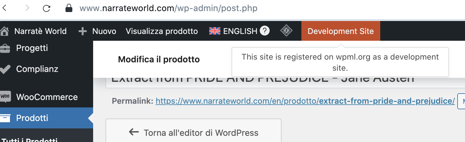

I partially explained this secondary issue:
"After migrating domain I noticed the WPML alert and I shift from narrateworld1.testmenow.it to narrateworld.com ad the plugin ask to do." but i forgot to add that it didn't shift, and it's still 'development'. So after click on 'nararteworld1.testmenow.it' ---> 'narrateworld.com' it doesn't change.

Regarding the issue with the "Development" notice, it appears that a development site key is associated with the site "narrateworld.com," causing the notice to display at the top of the admin. To solve the isssue, please follow the instructionss outlined in this guide: https://wpml.org/faq/how-to-remove-the-this-site-is-registered-on-wpml-org-as-a-development-site-notice/
I hope it will help. Feel free to let me know if you need further assistance in this matter. I will be happy to assist.
