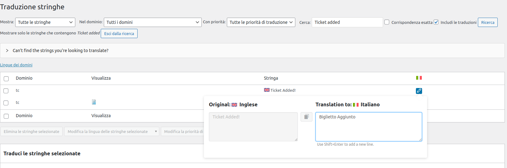

Contesto del problema:
I am experiencing an issue while trying to translate strings from English to Italian for the Tickera plugin (link nascosto) using the 'tc' domain. The default language of my website is Italian. I translated the strings using the .po file provided by Tickera and also exported the strings from WPML, manually translated them into Italian, and then imported them back.

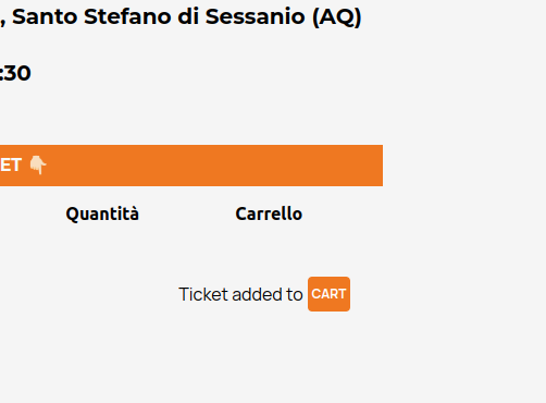

Sintomi:
The translations appear to be successful, as I can see the strings in Italian. However, on the front-end of the website, these strings remain in English and are not translated.
Domande:
Could you please assist me in resolving this issue?
