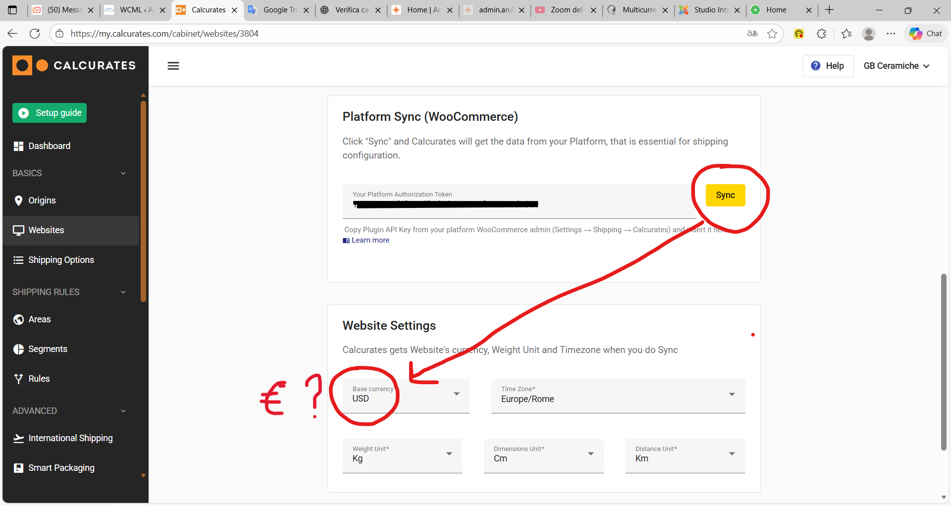

The client is experiencing issues with currency not changing on the frontend after updating WooCommerce and using WPML Multicurrency with geolocation settings. The currency remains in Euros despite using a VPN to simulate different locations. Additionally, when 'Customer Location' is selected in WPML Multicurrency, the default currency changes from Euro to USD in the Calcurates shipping plugin.

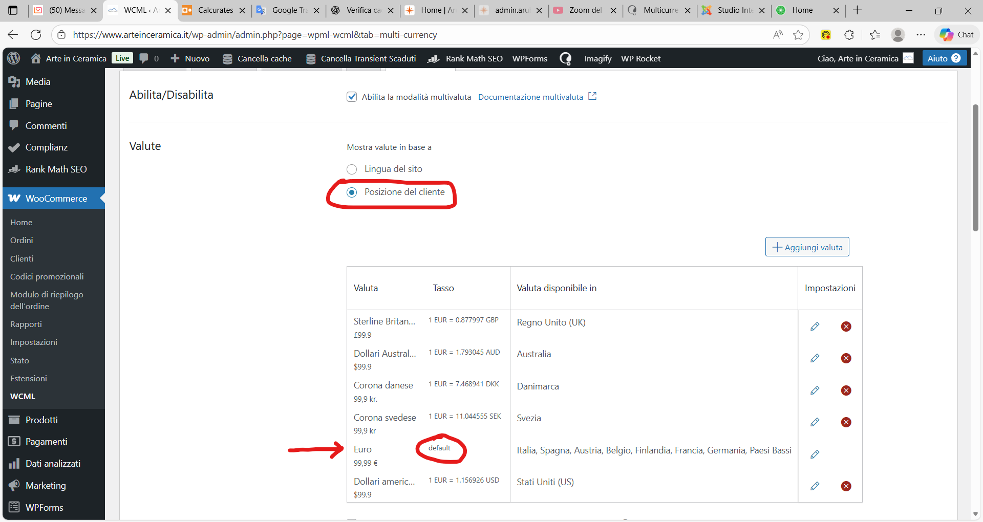

We explained that when WPML Multicurrency is set to 'Customer Location', the active currency changes based on the visitor's geolocation, and the Calcurates plugin reads this active currency during synchronization. If geolocation returns USD, Calcurates sets USD as the base currency. To always keep Euro as the main currency, we recommend setting the currency option to 'Site Language' or asking Calcurates support to ignore the active currency and always use WooCommerce's base currency. Regarding the CDN, we confirmed that it does not interfere with Multicurrency.

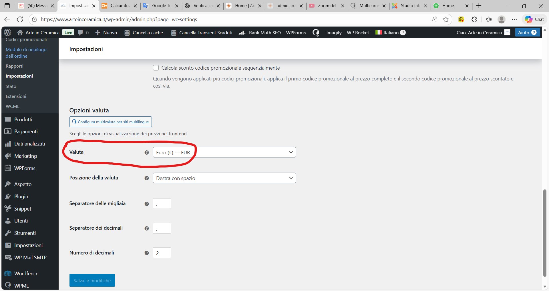

In breve la dashboard del mio plugin di spedizione "Calcurates" quando sincronizzo la piattaforma con Woocommerce mi restituisce la valuta in USD mentre quella di default è in EURO
Se disabilito la modalità multivaluta in WPML-Multicurrency questo problema non c'è.
