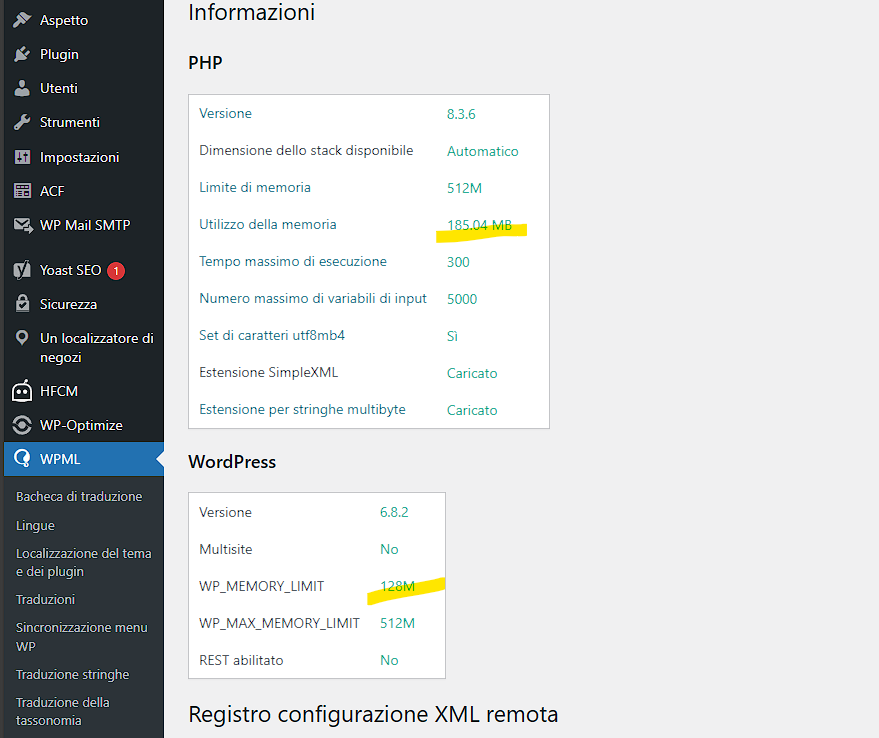

Your site appears to be registered correctly, and the Advanced Translation Editor is functioning.
The issue here might be that the current WP MEMORY LIMIT is set to 128 MB while the site currenlty needs about 186MB to operate without issues. See screenshot.
Could you please increase the WordPress memory limit (WP Memory Limit) to at least 256 MB? WPML requires at least 128 MB.
Your current values ​​are:
PHP Memory Limit 512 MB
WP Memory Limit 128 MB
To do this, you need to connect to your website's server and open the wp-config.php file in a text editor. The file is located in the WordPress root directory.
Add this code to the wp-config.php file to increase WordPress memory:
define ('WP_MEMORY_LIMIT', '256M');
Add this just before this comment:
// That's all, stop editing! Happy blogging.
The current values ​​can be viewed under WPML > Support > WordPress.
These settings can be restricted directly by your hosting provider. Therefore, I recommend contacting them and asking them to change the settings directly if the changes are not implemented immediately.

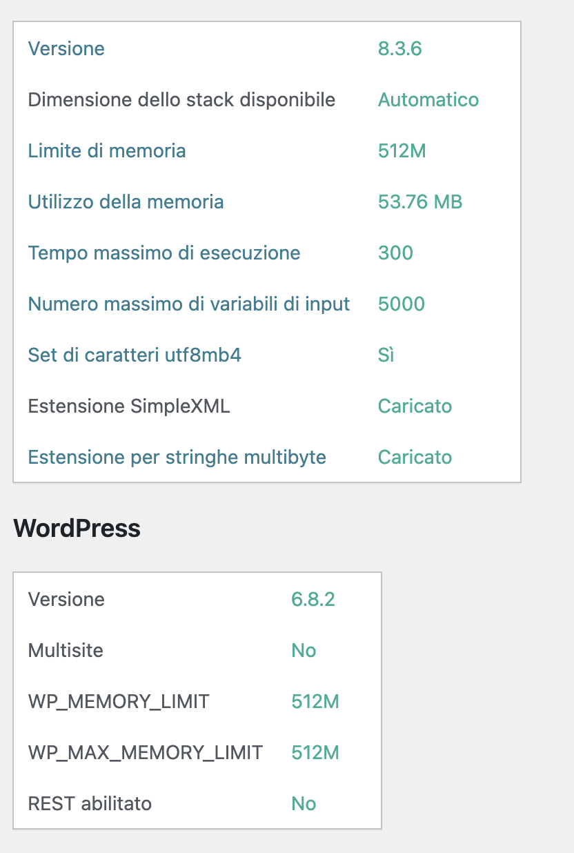

Settembre 5, 2025 alle 10:31 am #17378923
lianaF
Hi Andreas,
WP_MEMORY_LIMIT is now set to 512M but the problem still persists.

Settembre 5, 2025 alle 10:35 am #17378978
Sostenitore di WPML dal 12/2018
Lingue: Inglese (English ) Spagnolo (Español ) Tedesco (Deutsch )
Fuso orario: America/Lima (GMT-05:00)
I do not see any new errors regarding "No sitekey found". The last entry was from yesterday 2025/09/04 3:08:32 PM.
The issue I see at WPML > Support is that the REST API is disabled and this can lead to issues with WPML and its Advanced Translation Editor. Anyhow, this seems to be a false positive, as the REST API seems to be active on your site.
