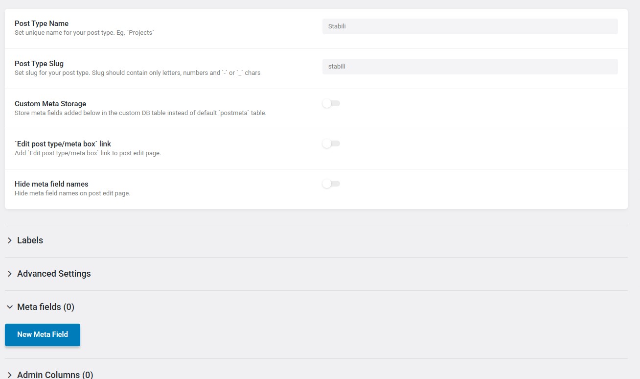

i need support for translate 2 CPT connected by parent, i have a CPT called "stabili" taht are parent, and anotherone children called "appartamenti", the lang translation are it de en.
the slug for stabili archive are:
website.com/affitto
the slug for stabili post are:
website.com/affitto/stabili-post-name
the slug for appartamenti are post are:
website.com/affitto/stabili-post-name/appartamenti-post-name

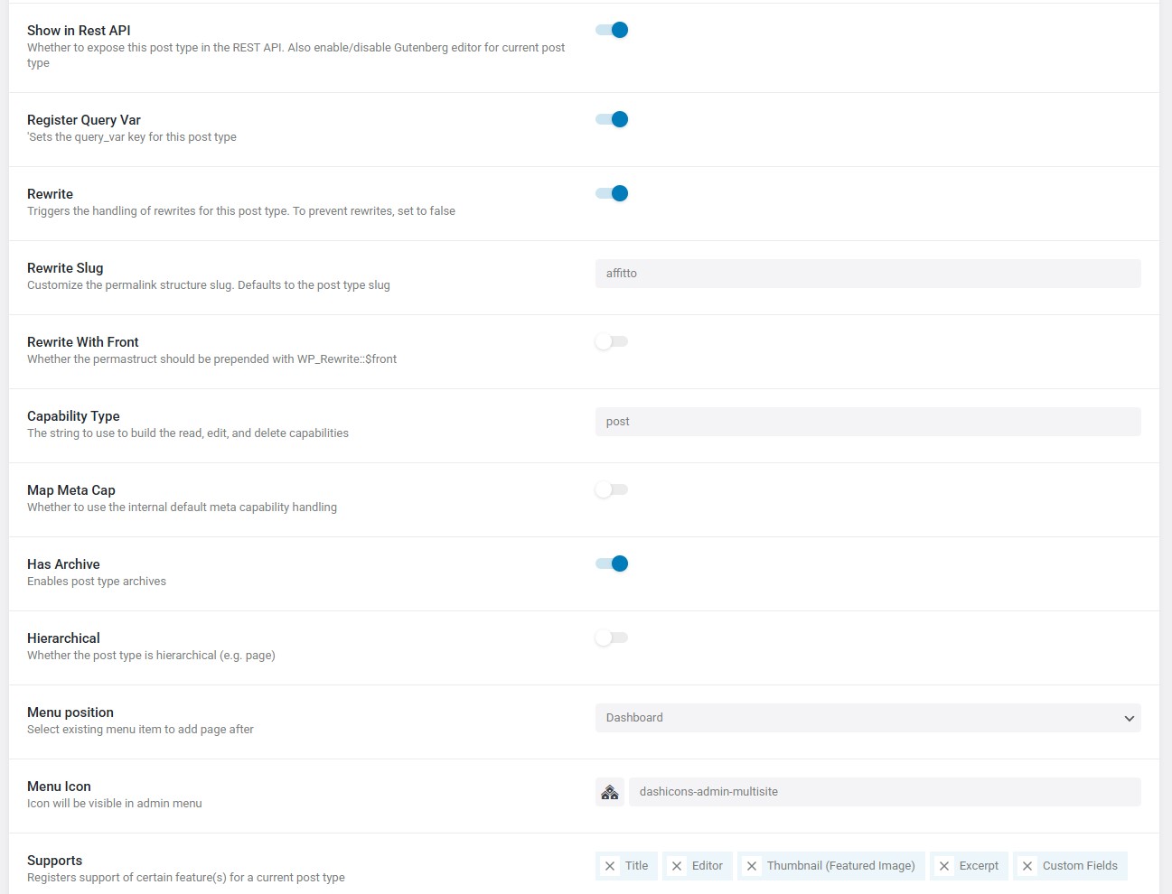

i need to add code? settings are fine? under appartamenti post i select father by select field, and are associed
examle, with attach settings have:
link nascosto
link nascosto

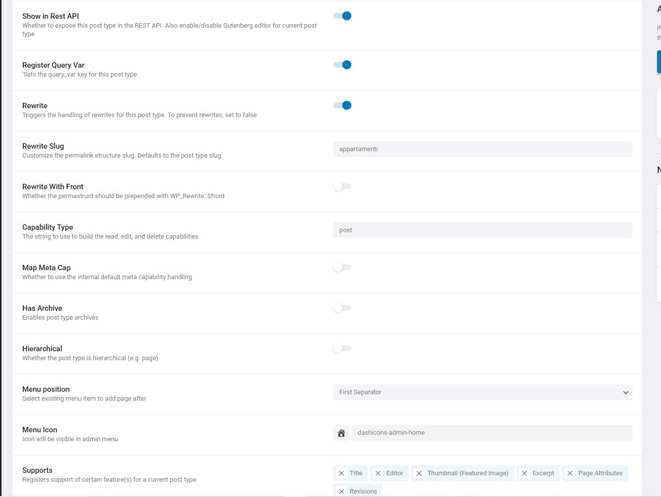

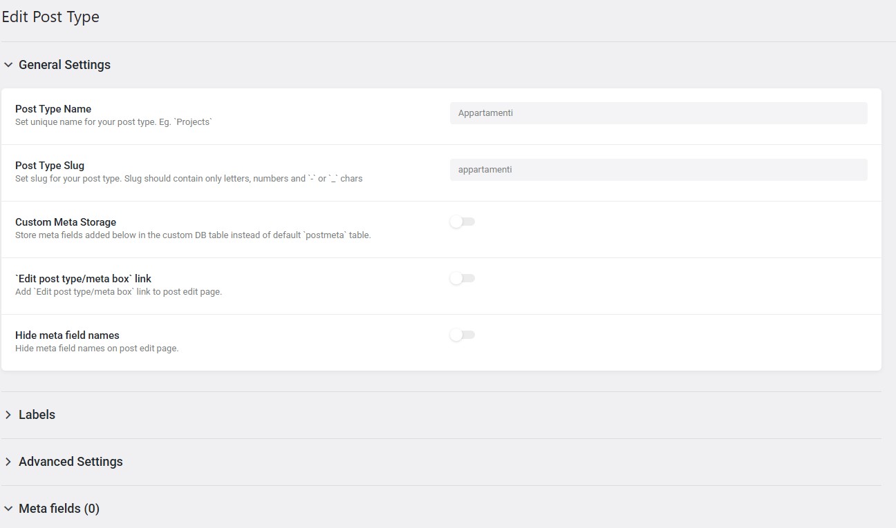

the problem are appartamenti settings
Italy predefined:
link nascosto
link nascosto
i attach my settings

i wait help, i try to activate hierarchical on apartments but don't work

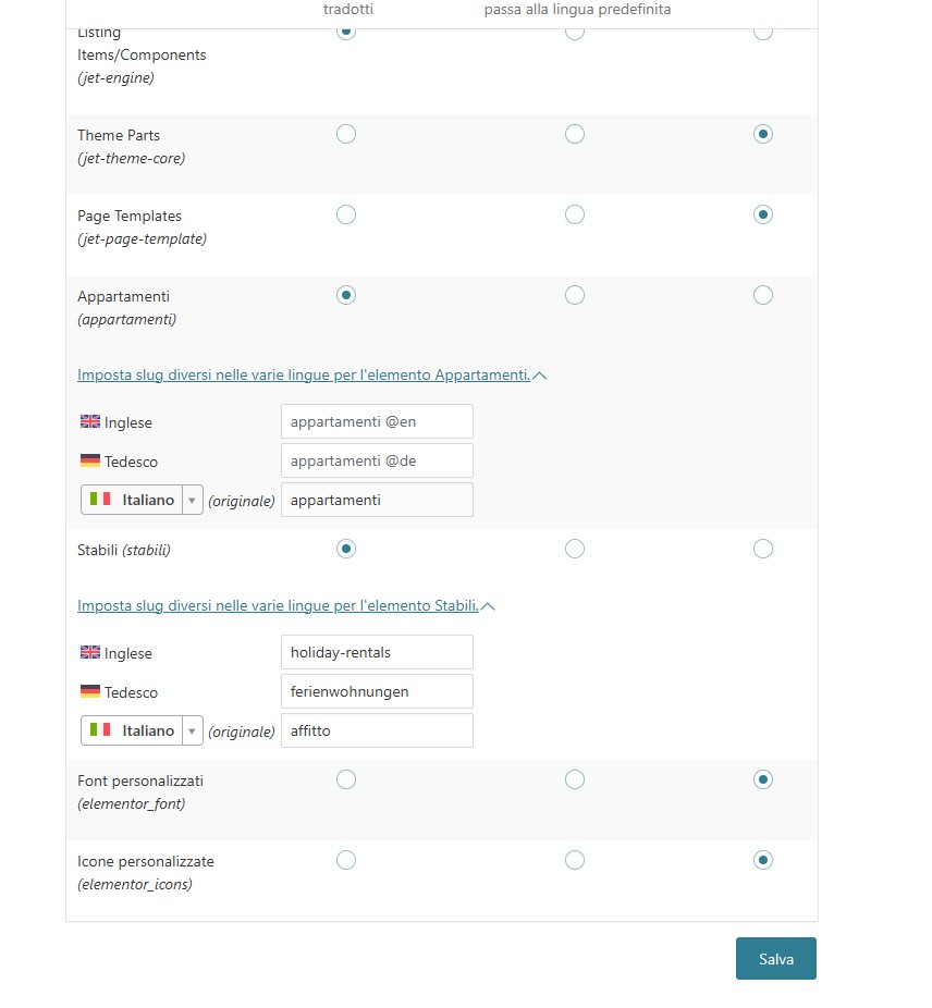

Prova su WPML --> Settings --> Post type translation fai click su Save e anche da Taxonomy translation.
Per salvare gli slugs dei post types.
Dimmi se dopo questo funziona.
