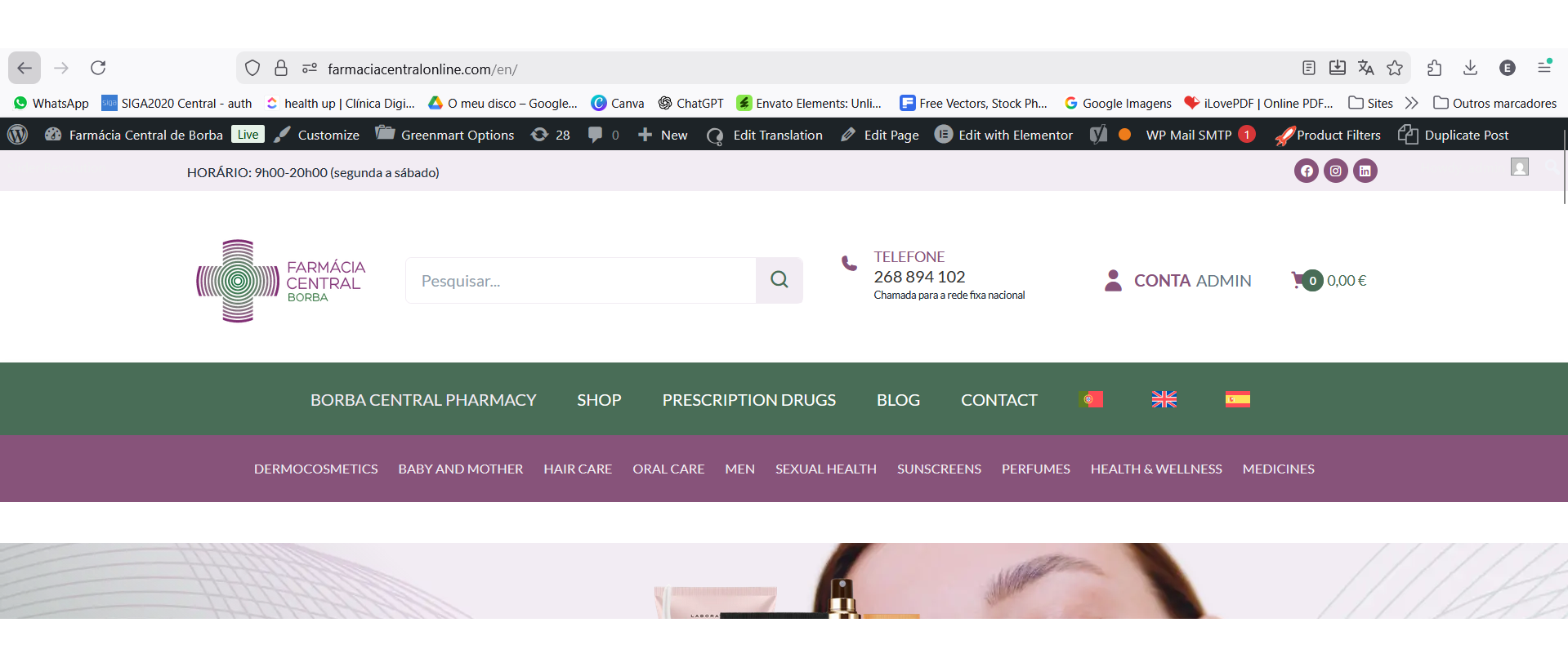

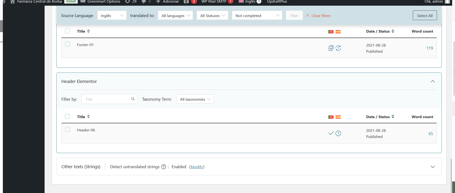

I've already tried several ways, and none of them does the frontoffice reflect some translation elements, for example the footer and header. I send some prints attached. It translates in the backoffice, but is not reflected in the frontoffice. It's the same problem as the previous ticket, none of the proposed solutions worked.

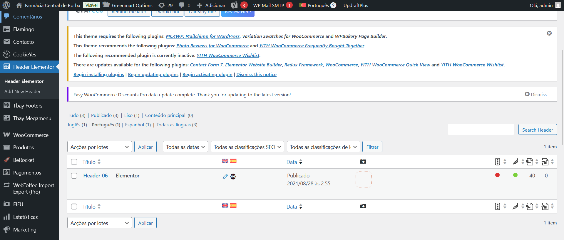

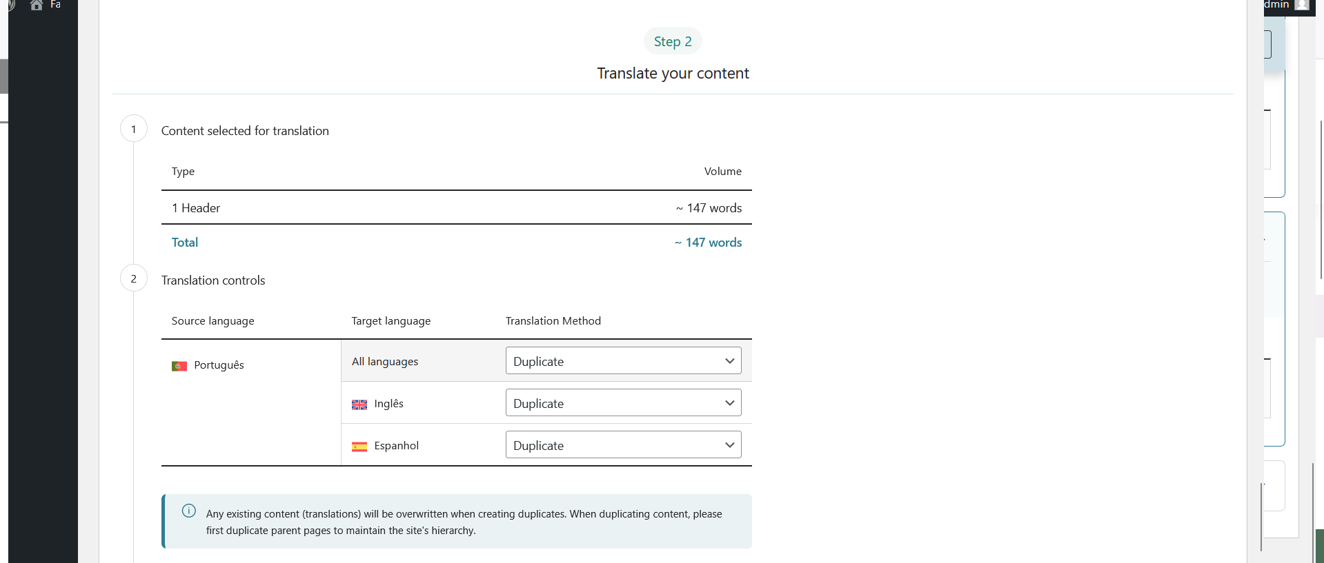

Thank you for waiting. I'll check, it seems that you're duplicating them (in which case, they are duplicates of the original and won't be translated), or there are unregistered custom Elementor widgets.

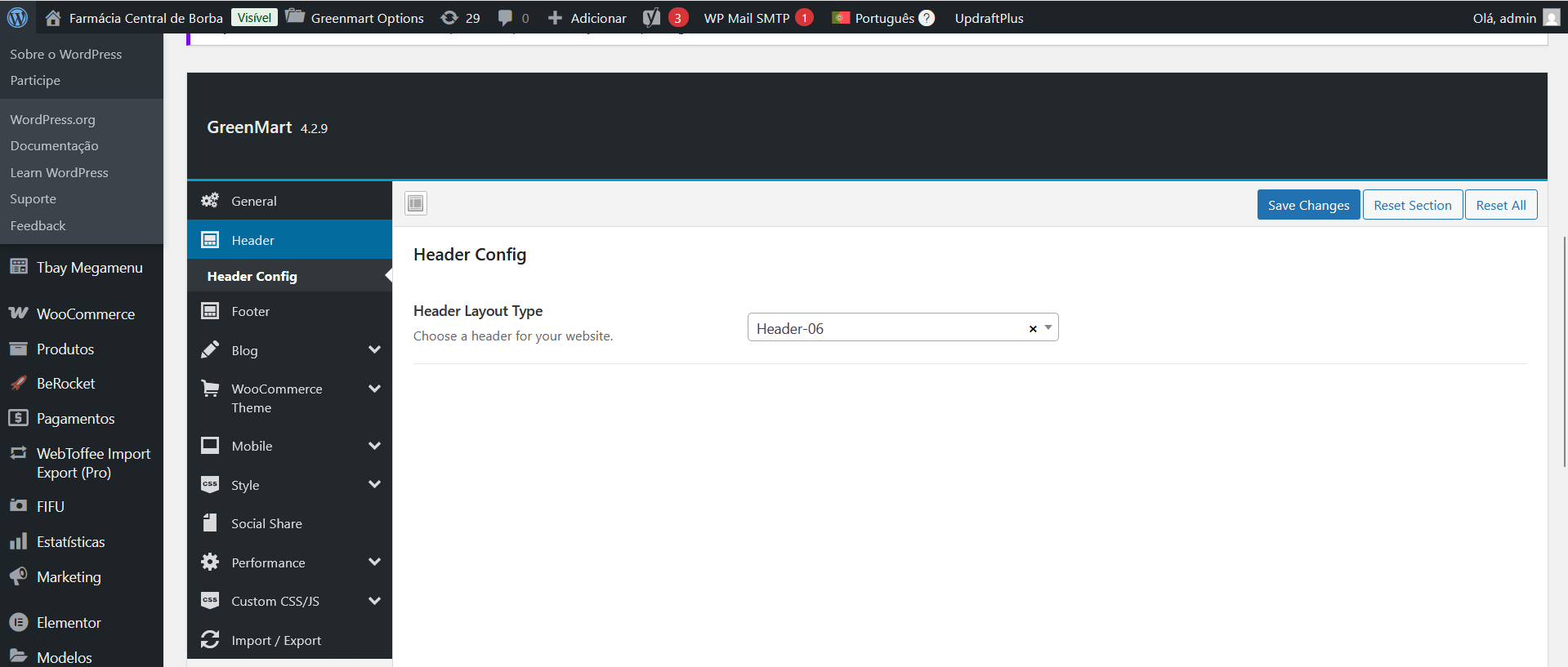

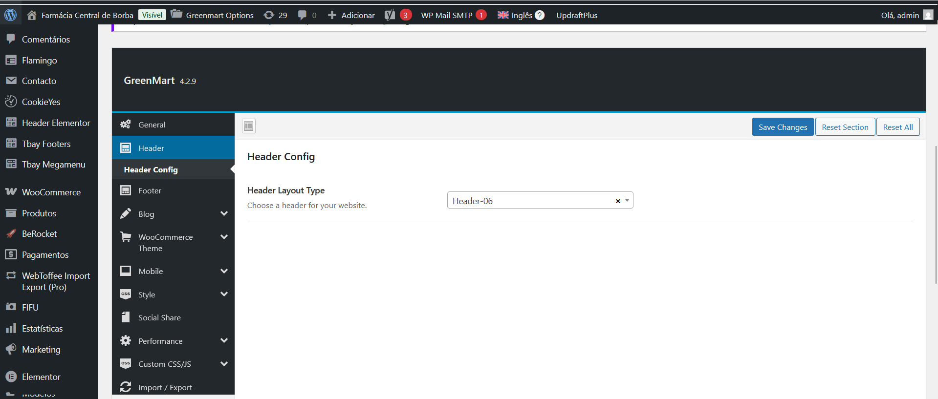

Thank you. I've checked your website, and the Header looks properly translated. What seems to be happening, is that your theme overwrites the header display logic from Elementor, and implements one of its own. This feature might not be compatible with multilingual websites, and seems to be serving always the same header (in Portuguese), regardless of the selected language.

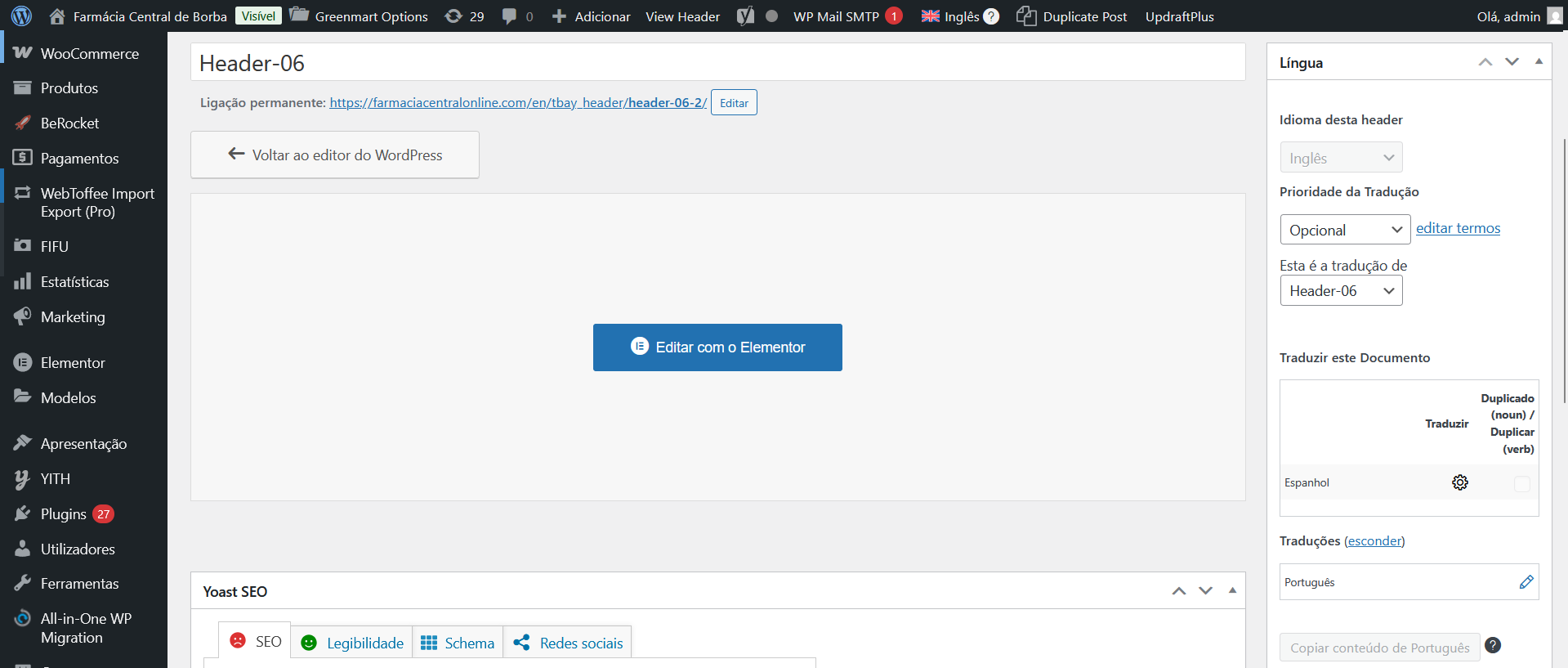

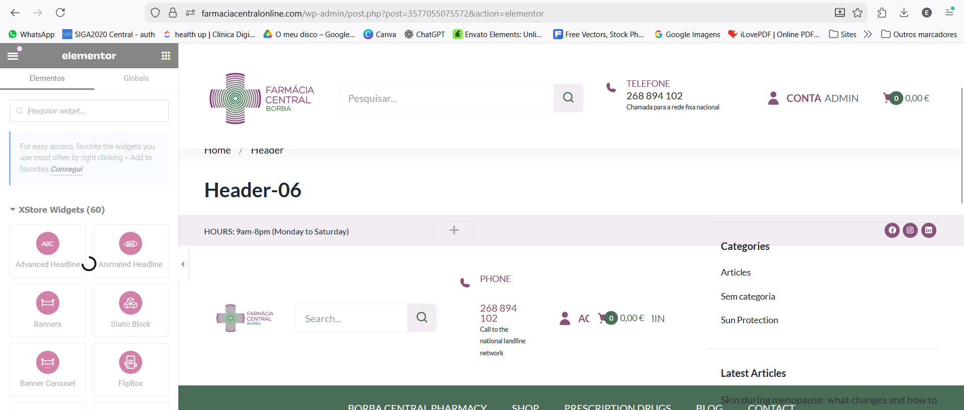

Thank for sharing. I logged into the website, but when creating a header under "Header Elementor", I cannot actually use Elementor to create the header. The builder is not available there.
Can you please check? If possible, please create a header using Elementor, and set it as the website's header.
