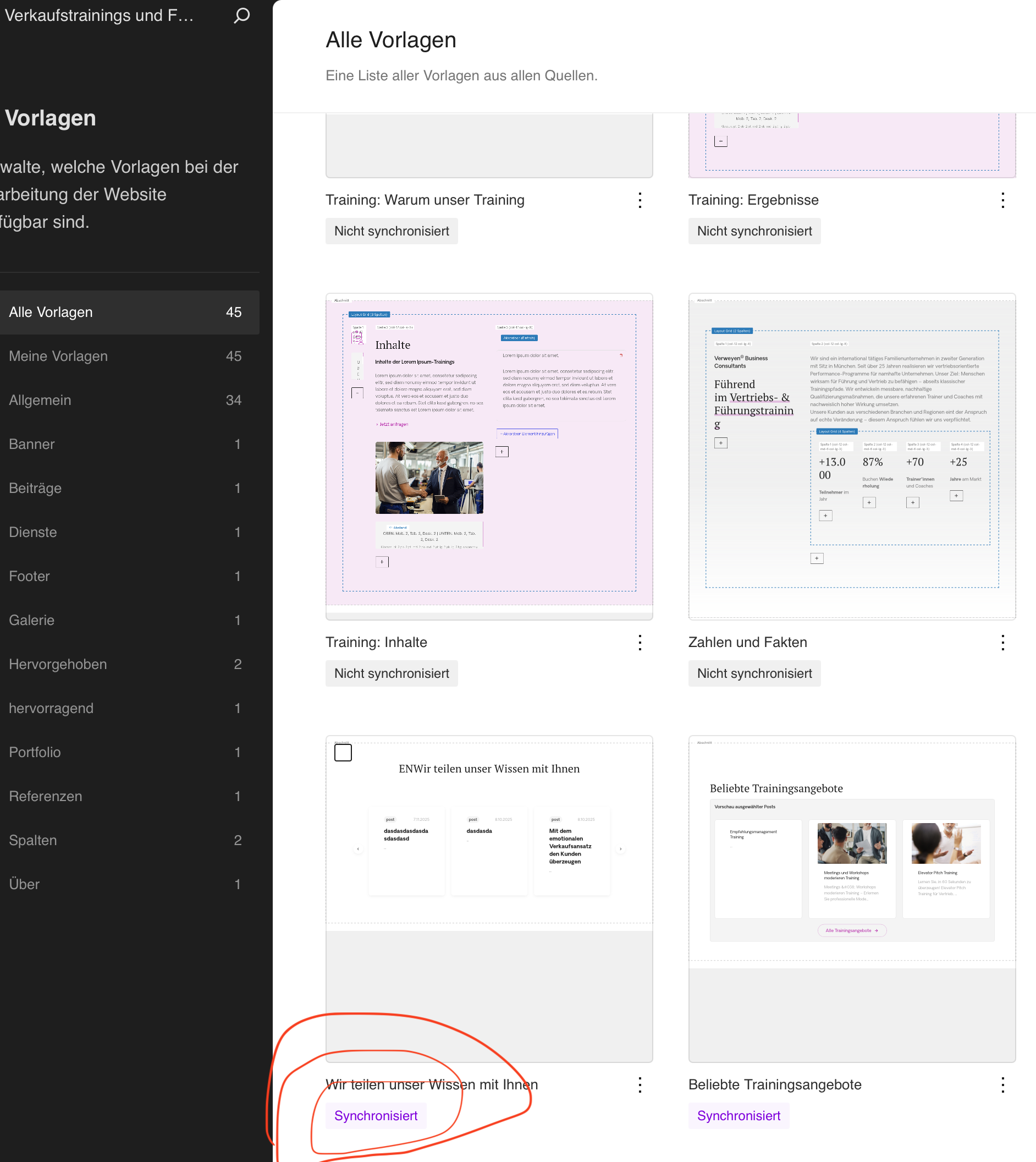

After this, about 50% of new texts appeared in the translation editor. Can you tell me if there is anything else missing from translation editor but is added a text directly on that page?
As for the pattern, I've translated this one versteckter Link
Even though "Warum Trainings von alexander verweyen®?" is translated, versteckter Link still shows wrong, this is one of the translation issues, correct?
Also, these 3 buttons below it, where are these crated? I can't see them within the pattern.
And the last section - Jetzt Kontakt aufnehmen - this is not a block but is also added directly to versteckter Link, correct? For some reason I don't see these texts within "RAW content from the post_content column of the current post" so I wasn't able to generate XML for it so that it appears in the translation editor.
Let me know about these things so I could check further and check this with our 2nd tier support for further debugging.

Thank you! How should I handle the XML? Where it should be saved to make the translations work?
Now the buttons still missing in "Warum Trainings von alexander verweyen®?", the headline and the headlines of the tabs.
The "Jetzt Kontakt aufnehmen" is controlled fron Customizer globally.
I would love if you can help me to translate it completely.

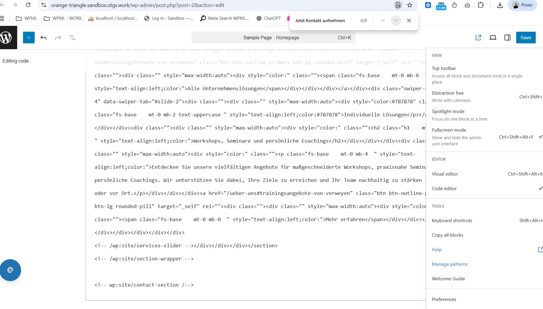

It is added here versteckter Link, so through the template translation (so versteckter Link) I was able to translate the buttons as well.
However it is still not clear how is this rendered:
Sie planen eine Weiterentwicklungsmaßnahme für Ihr Unternehmen? Wir beraten Sie kostenlos und unverbindlich.
If I open versteckter Link and if I search for it within the page code, it doesn't seem to be there so I can't register XML for it.

This text here is rendered in the block itself:
But the rest of the block is from the customizer, here is how the fields are set in the block:
createElement(AdvancedRichText, {
key: "title",
attributes: attributes,
setAttributes: setAttributes,
textKey: "title",
label: __("Titel", "verweyen"),
placeholder: __("Titel eingeben...", "verweyen"),
key: "description",
textKey: "description",
label: __("Beschreibung", "verweyen"),
placeholder: __("Beschreibung eingeben...", "verweyen"),
The rest of the block is in Customizer - > Kontaktdaten -> Popup Einstellungen.
It would be great if we also can translate it 🙂
