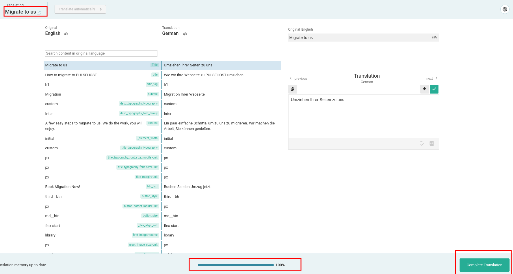

Juli 16, 2024 um 6:20 am #15958198
michaelS-153
Hello Prosenjit
this is odd. I did exactly what you told me, step by step.
Also did a change to title, the page is shown as 100 % translated, but it is not.
Pls see screenshot
