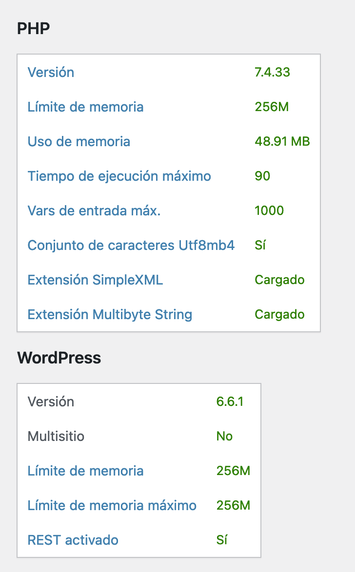

Hello There,
I hope you're doing well. Sorry for the delay in responding due to the weekend.
To reduce the waiting time, I took this ticket and responded in English. Please let me know if you're okay with it or if you want to continue the conversation in Spanish language. I will check and forward this ticket to one of our Spanish-speaking supporters to assist you in the Spanish language.
From the WPML debug info, I can confirm that the translation settings for Pages and Posts are correctly configured. With this setting, you should be able to see the "Language" meta section in the WordPress editor. Please note that this translation meta appears in the native WordPress editor, not in editors like WPBakery or Elementor.
