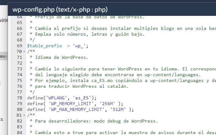

Thank you for sharing the information. I checked your debug info and noticed that your website doesn't have the minimum memory required for WPML to work. WPML requires a memory limit of at least 128MB while 256MB is recommended. See https://wpml.org/home/minimum-requirements/ for detailed information. You can set WP Memory Limit in your wp-config.php file by adding the following code:
define( 'WP_MEMORY_LIMIT', '256M' );
define( 'WP_MAX_MEMORY_LIMIT', '512M' );

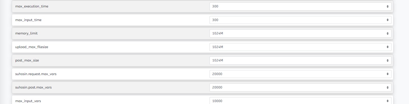

Hi, I have made the changes as suggested and we are still experiencing the same error.
