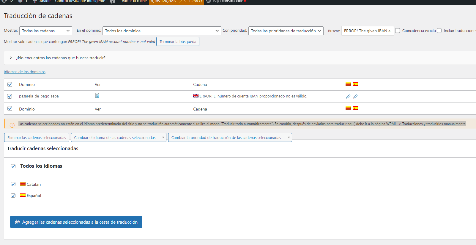

Intento traducir un plugin de sepa para recogida de cuentas correintes de clientes
El error que da es: Las cadenas seleccionadas no están en el idioma predeterminado del sitio y no se traducirán automáticamente si utiliza el modo "Traducir todo automáticamente". En cambio, después de enviarlos para traducir aquí, debe ir a la página WPML -> Traducciones y traducirlos manualmente.
El plugin es SEPA Payment Gateway for WooCommerce
Sitio web enlace oculto

Hello There,
To reduce the waiting time, I took this ticket and responded in English. Please let me know if you're okay with it or want to continue the conversation in Spanish. I will be happy to forward this ticket to one of my Spanish-speaking colleague.
I understand the issue you're having and will try my best to assist. It's important to note that automatic translation is only possible from the default language to other languages. If the source language of the content is different from the default language, you won't be able to automatically translate that content.
Now, to translate the string automatically, you'll need to change the source language of the string first and then send the string from translation. To understand how you can change the source language of the string, please check the guide below.
- https://wpml.org/documentation/getting-started-guide/string-translation/how-to-change-the-source-language-of-strings/
Pleas let me know if that helps or if you need further assistance in this matter. I will be happy to help.
