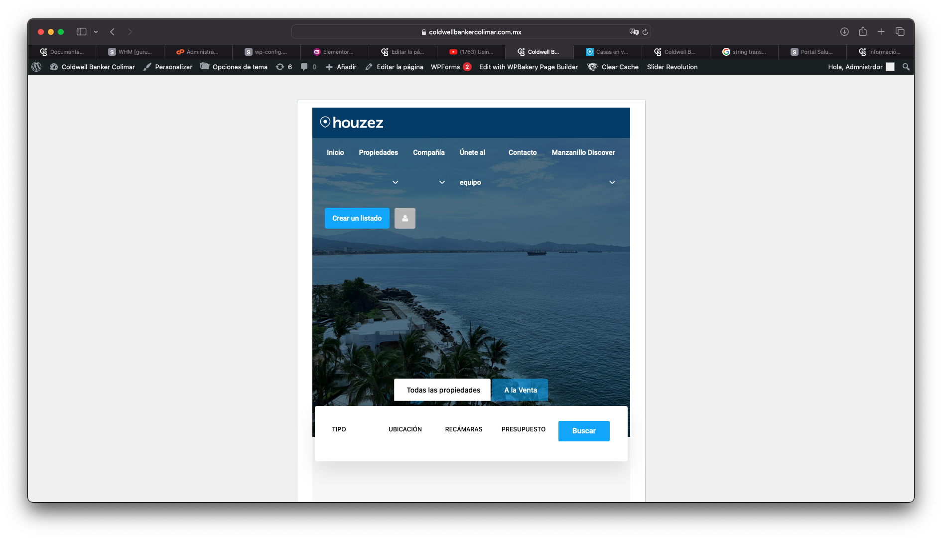

Antecedentes del problema:
Estoy tratando de configurar el plugin WPML pero me presenta un cambio en la forma de la página. URL: enlace oculto
Síntomas:
Cambio de forma en la página
Preguntas:
¿Por qué mi página web cambió de forma al configurar el plugin WPML?
¿Cómo puedo solucionar el cambio de forma en mi página web?

Hi There,
Before this thread is assigned to my colleague, I'd like to offer some initial guidance and potential solutions. To reduce response time, I'm responding in English. If you prefer to continue the conversation in Spanish, please let us know in your next response, and our Spanish support team will assist you accordingly.
It seems there is a fatal error on the page you're trying to access, causing the layout to appear broken. Could you please enable the WordPress debug log on your site and check if any errors are being recorded? You can refer to the documentation below to understand the process:
- https://wpml.org/documentation/support/debugging-wpml/
After enabling the debug log, refresh the page wherem you encountered the fatal error so that the error gets recorded in the log file.
Then, navigate to your site's directory using the File Manager, and you should find a "debug.log" file in the "/wp-content" directory. Please copy the content from this file and share it in your next message. We'll check and guide you on the next steps.

amayaB
Thanks for your response
Warning: Attempt to read property "post_status" on null in /home/coldwellbankerco/public_html/wp-admin/includes/template.php on line 2298
Warning: Attempt to read property "post_status" on null in /home/coldwellbankerco/public_html/wp-admin/includes/template.php on line 2302
Warning: Attempt to read property "post_status" on null in /home/coldwellbankerco/public_html/wp-admin/includes/template.php on line 2308
Warning: Attempt to read property "post_status" on null in /home/coldwellbankerco/public_html/wp-admin/includes/template.php on line 2312
Warning: Attempt to read property "ID" on null in /home/coldwellbankerco/public_html/wp-admin/includes/template.php on line 2316
Warning: Attempt to read property "post_status" on null in /home/coldwellbankerco/public_html/wp-admin/includes/template.php on line 2320
Warning: Attempt to read property "ID" on null in /home/coldwellbankerco/public_html/wp-admin/includes/template.php on line 2325
Warning: Attempt to read property "ID" on null in /home/coldwellbankerco/public_html/wp-admin/includes/template.php on line 2329
Warning: Attempt to read property "ID" on null in /home/coldwellbankerco/public_html/wp-admin/includes/template.php on line 2334
Warning: Attempt to read property "ID" on null in /home/coldwellbankerco/public_html/wp-content/plugins/complianz-terms-conditions/class-document.php on line 823

Hola,
Esos errores no parecen provenir de WPML y aparecen dentro de la sección de pie de página de tu página de inicio original.
Parecen estar relacionados con el widget que está ubicado dentro de tu pie de página y los errores parecen estar relacionados con el complemento "Complianz - Terms and Conditions".
¿Puedes confirmar si esos errores desaparecen si deshabilitas WPML por un momento?
Si los errores siguen apareciendo después de deshabilitar WPML, entonces esos errores no están relacionados con WPML.
En caso de que los errores desaparezcan una vez que deshabilites WPML, avísame y lo investigaré más a fondo.
