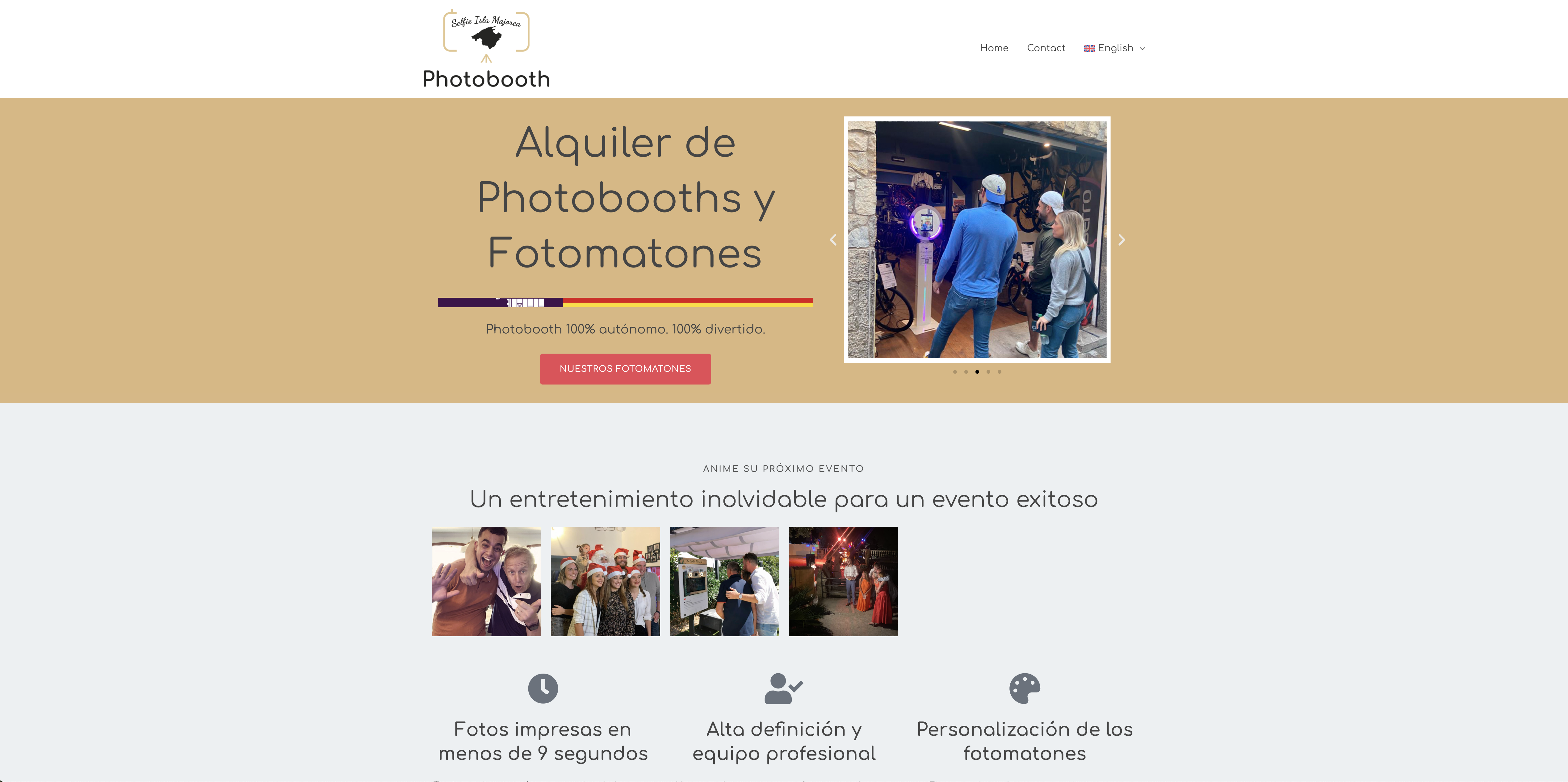

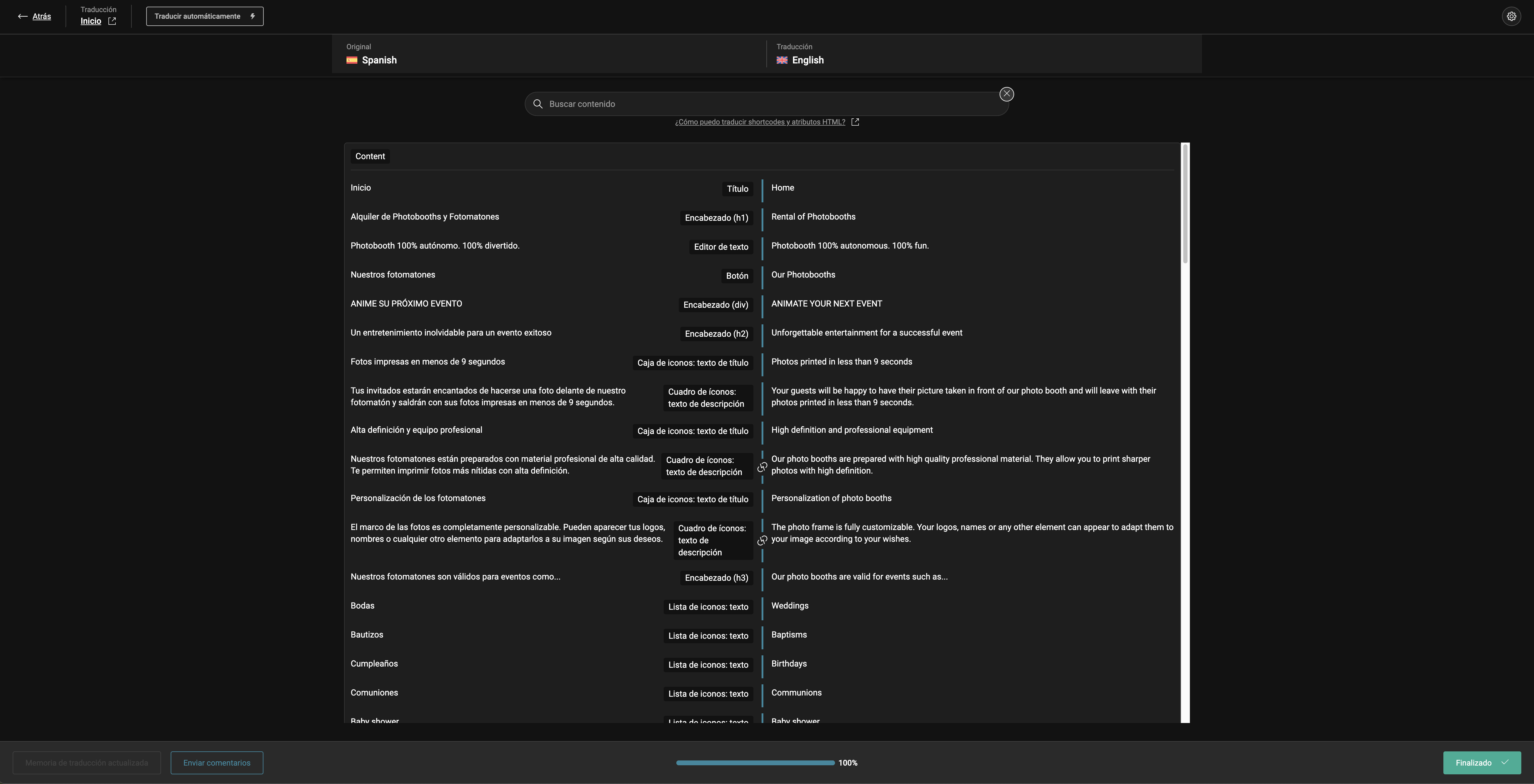

Estoy intentando traducir el sitio web al inglés usando WPML. He completado al 100% las frases en el editor de traducción de WPML.
Síntomas:
Cuando trato de acceder a la versión en inglés de la página principal, veo que ninguna de las frases se ha traducido y aparecen todas en español.

I understand the issue you're having. To display translated content in the Frontend for a page/post created with Elementor, it is necessary to have the WPML's String Translation plugin installed and activated on your site(Check this link for more details). From the debug info that you've shared, I can see that the String Translation is not active on your site.
Kindly activate the "String Translation" plugin on your site, make a small change in the page in the default language, and save the changes. You'll notice the translation update icon after saving the page. Please update the Translation accordingly. The issue should be solved right after that.
