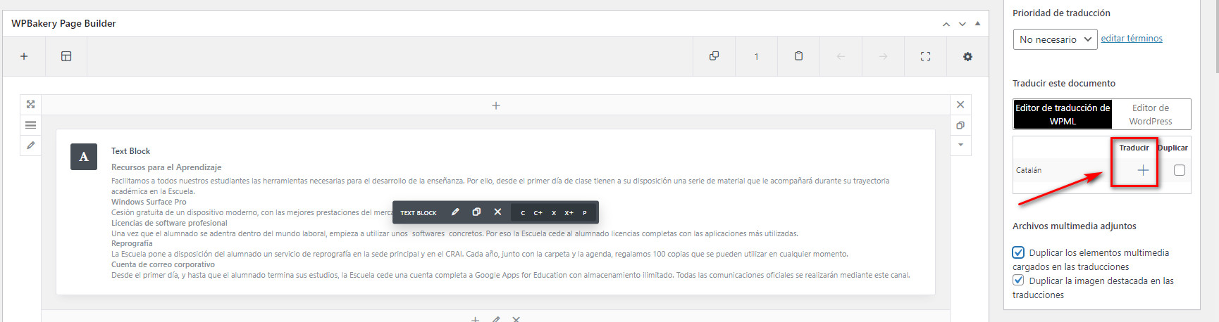

2 - In backend mode edit, i can see at the right the option for translate (image 1)

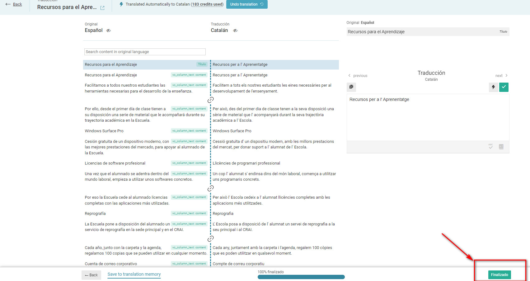

3 - If I click in this option then next page show the translations and after check i submit the form (image 2).

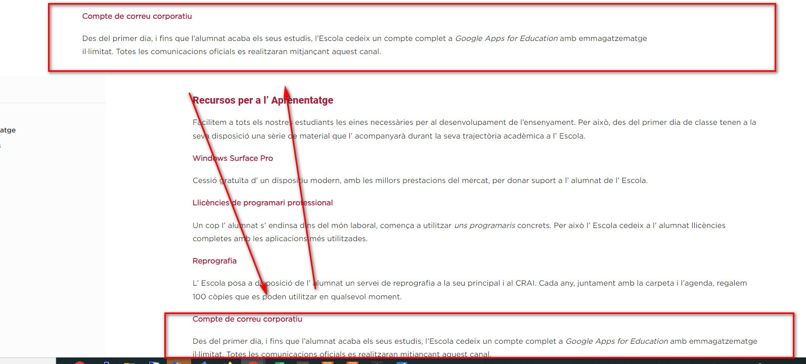

4 - At this point I have the page in the language i need but here is the problem, when i go the the view i see the content duplicated. (image 3). Is not possible to show all content in one image but all content show 2 times in the view.
If I check the page, in the builder you only see 1 time the content, but in the view your see it duplicated.

When i make translation, the page takes the header content block and dont duplicate the background image and make the title translation the thing that happens is that the header block have the same translation of the page and this is why i see content duplicated. If I delete the header content block then the problem is solved. But we don't want to delete the header.
