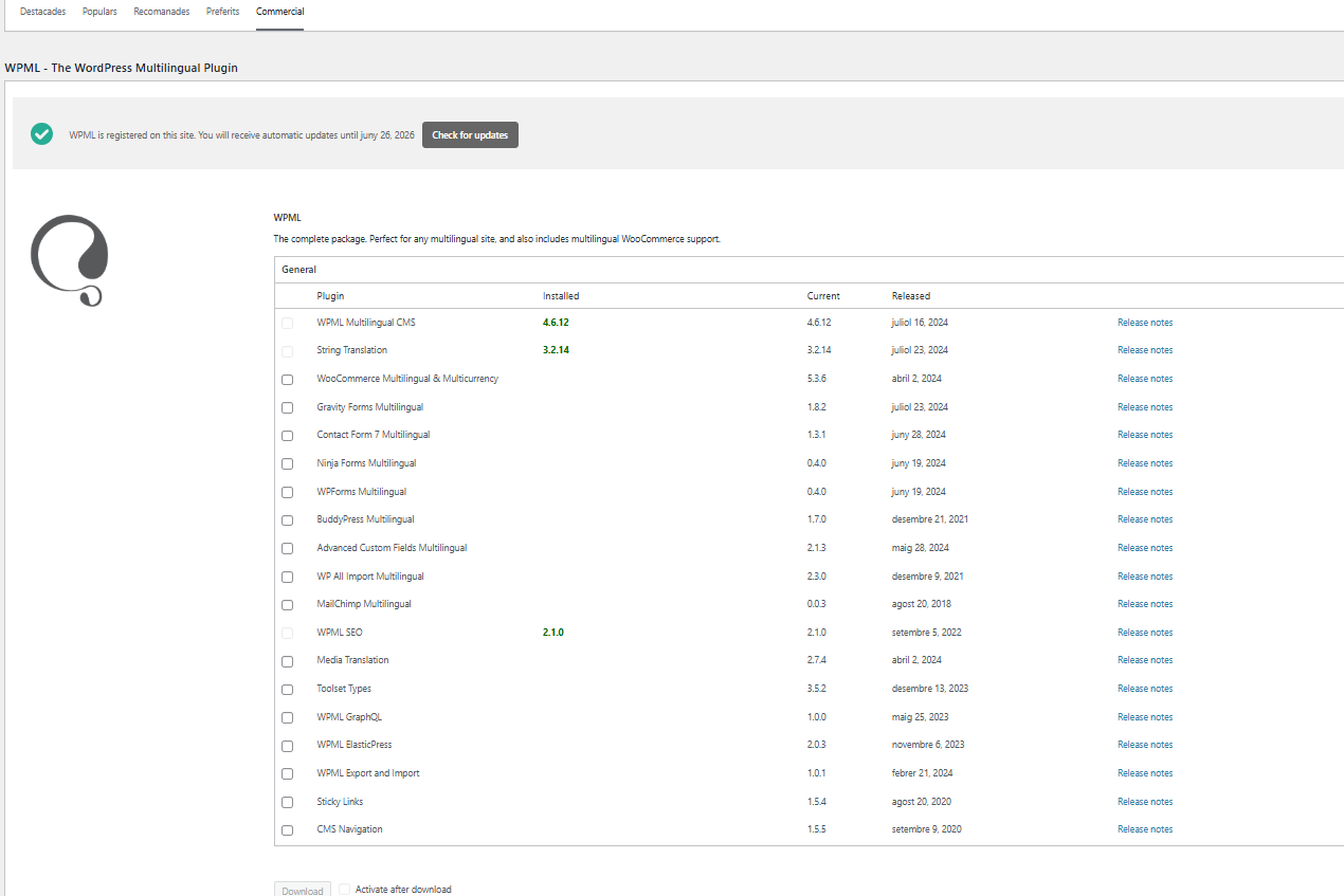

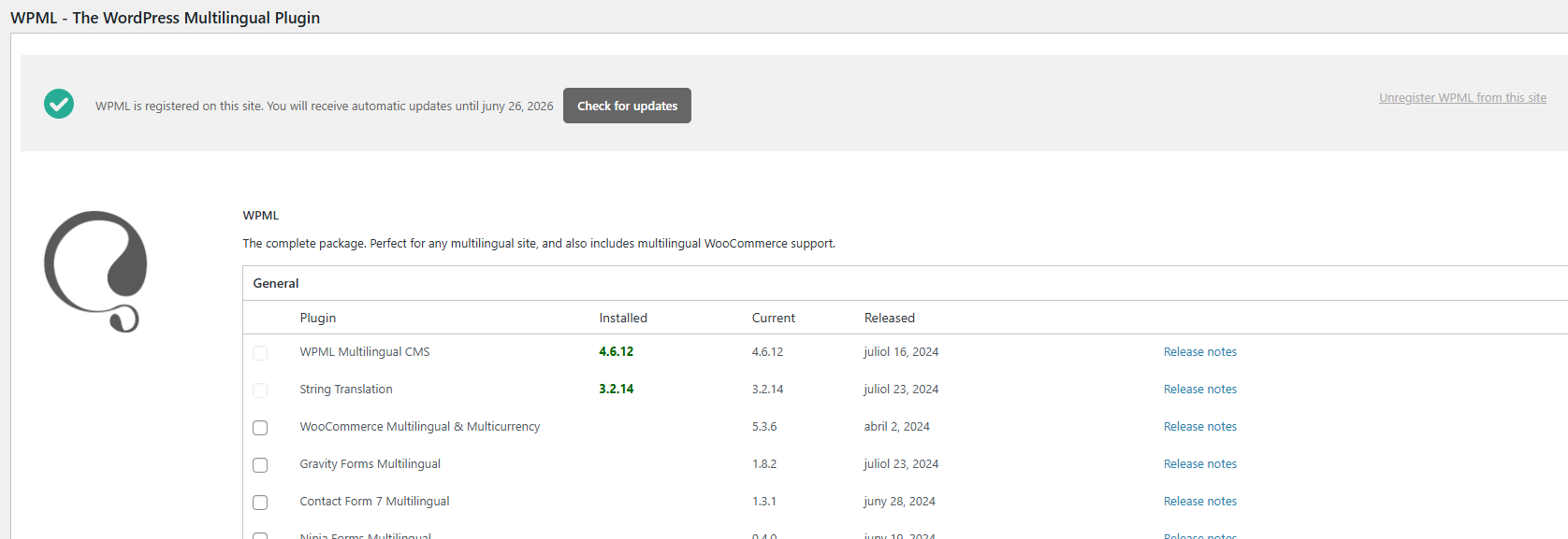

marzo 23, 2026 a las 10:19 #17917940
lluisS-5
Good morning Lucas,
Now on backend after manual update it says that we have last version but it shows the current one as older version, I attach you an image of it.
Is that normal? On frontend it seems that all is running properly except out stores markers, after update due to a problem with the REST request, I don't know if could be something retalet to WPML manual update, I am trying to figure it out right now.

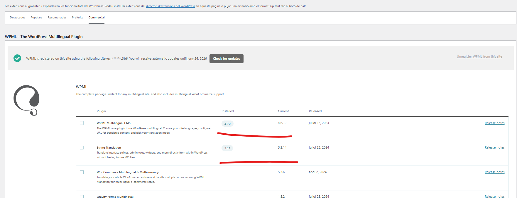

marzo 25, 2026 a las 16:09 #17927118
lluisS-5
Hello Lucas,
I do it without deactivate as you do it and the 3 plugins updates with no problem! But in commercial tab still appears current version 4.6.12 and the Installed 4.9.2. I attach you an image and if you need you can still access to WP backend with your credentials.
Miquel

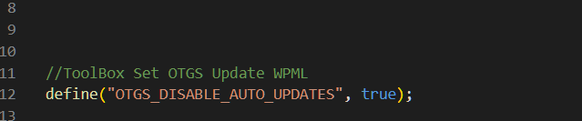

marzo 31, 2026 a las 08:15 #17938606
Lucas Vidal de Andrade
Partidario de WPML desde 11/2023
Idiomas: Inglés (English ) Español (Español ) Alemán (Deutsch ) Portugués, Brasil (Português )
Zona horaria: Europe/Vienna (GMT+02:00)
Hey there,
Thank you for waiting. After investigating, we saw that the "Check for updates" option was explicitly turned off in your wp-config.php file. Check the image.
Make sure you have a full website backup, and remove that line. Let me know how it goes.
