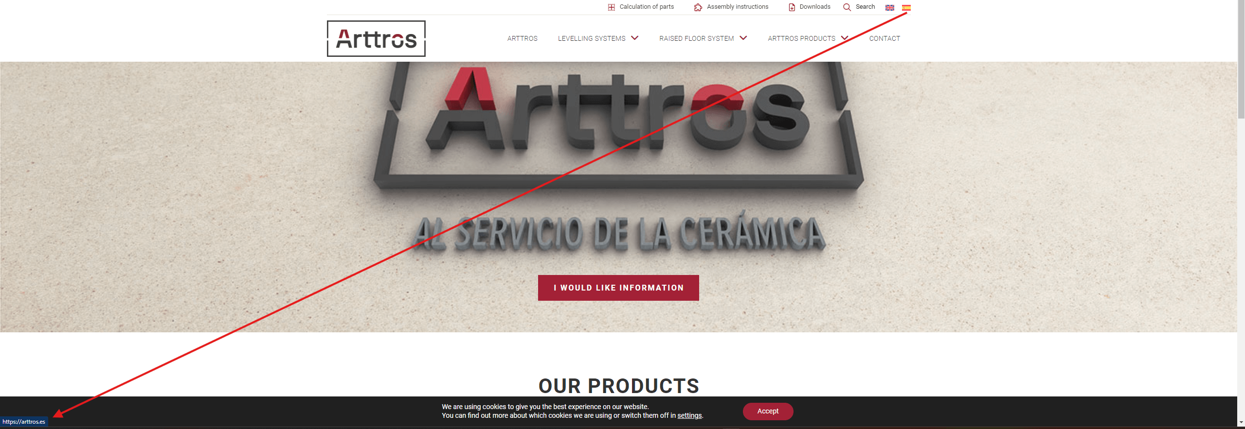

I logged into your main site and tried to configure the different domains per language settings. I changed the default language to English. After entering the Spanish domain and saving, I found that the Spanish domain showed as valid. Please check this screenshot: enlace oculto
However, when I checked the frontend, I found that the Spanish domain was pointing to the English (.com) domain.
In the WPML troubleshooter (WPML > Support > Troubleshooting), there is an option to update the domain name in the language switcher (the option named "Update domain name in language switcher settings"). When I clicked that button and checked the frontend, the Spanish language flag started pointing to the Spanish domain. Please check the attached screenshot.
But when I tried to switch, I got redirected to the .com domain.
