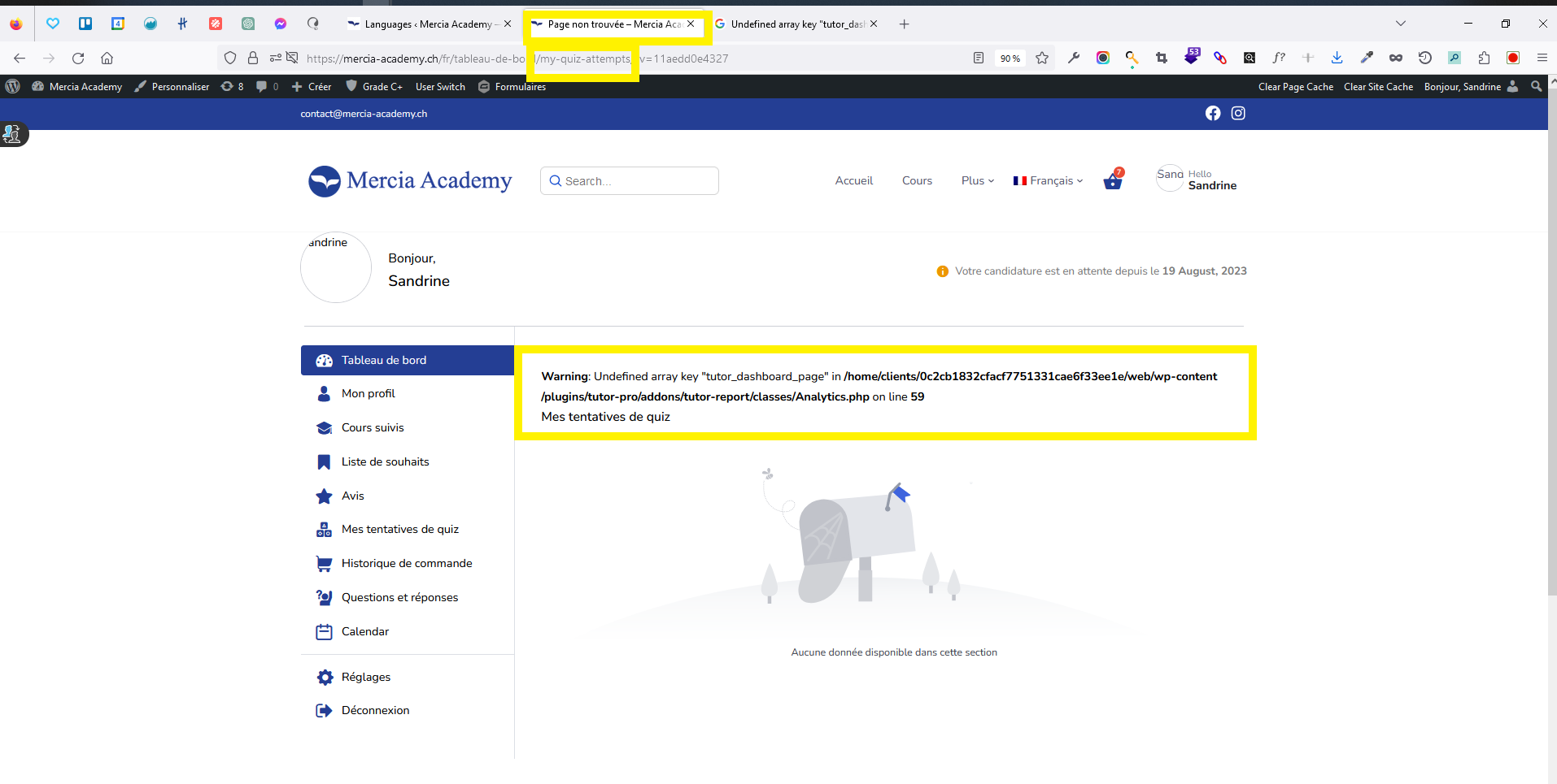

1- my dashboard links work now, but the title of the page displaid on the tabs is same as 404 result "page non trouvée" same in spanish
2- in the url the sub-menu still in english (same in spanish)
3- I've got a bug message "Warning: Undefined array key "tutor_dashboard_page" in /home/clients/0c2cb1832cfacf7751331cae6f33ee1e/web/wp-content/plugins/tutor-pro/addons/tutor-report/classes/Analytics.php on line 59" (same in spanish)

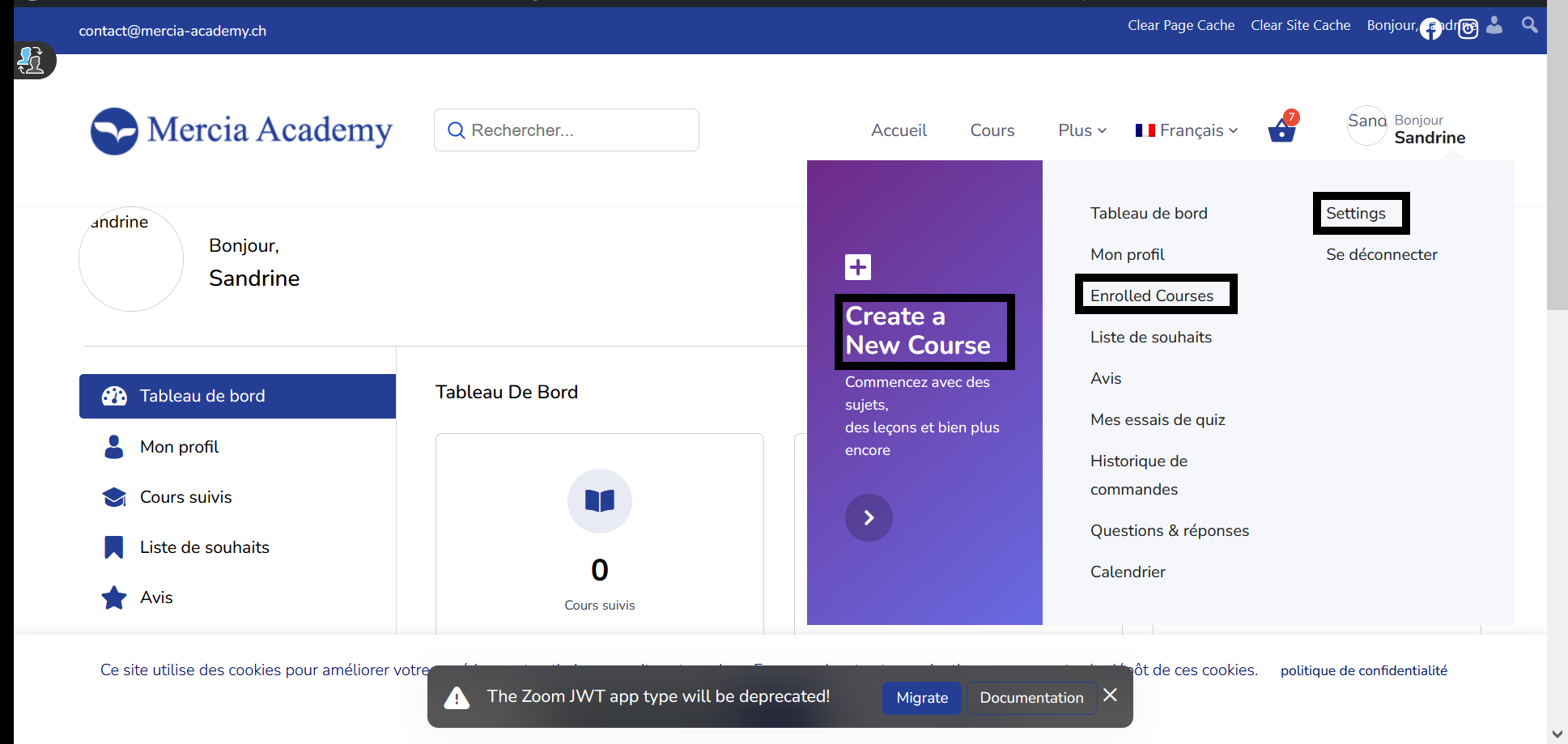

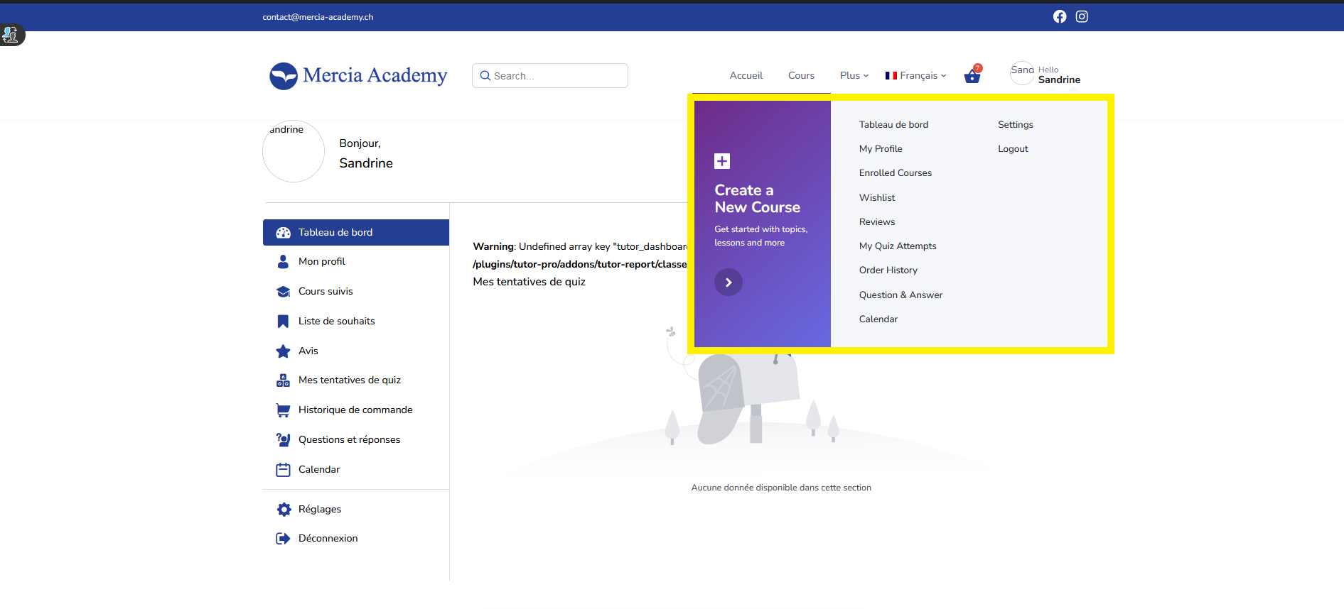

4- when I go hover the dahsboard with my mouse, all the items except the dashboard one are in english...it's not the case in spanish...
I put screenshot so you see...

2 and 4- The dashboard string is shown as French for your case and the rest is not because I was the one who translated it from String translation, You have to translate those terms from WPML > String translation > Search for the term > Translate all matching strings : lien caché (Same thing with the sub-menus)
3- I have downloaded a new copy of your site hoping I could see this error, it seems that either :
A- A string that wasn't supposed to be translated was indeed translated by mistake
B- An error entirely coming from the plugin Tutor LMS as the error suggests it belongs to the folder /tutor-pro/addons/tutor-report/classes/Analytics.php
I will run other tests, in the meantime, please consider contacting tutur LMS if they could give us an insight on that error message,

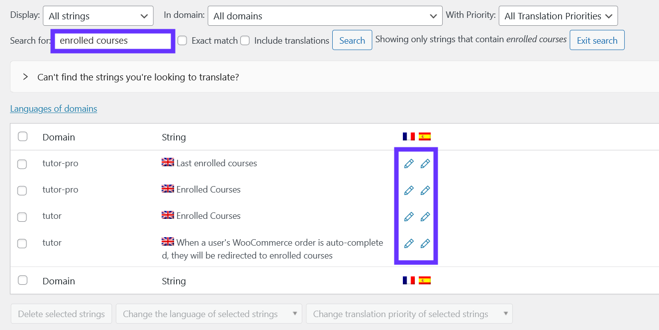

>> ok I've translated all of them, but still some of them appears in english even if they have been ALL translated (see screenshot) + exemple "enrolled courses"
>> even after the translation strings, the url still linked to the english items (see screenshot)

Also, I've been trying to get “enrolled courses” translated, but it seems to be stuck, I'm transferring this to my second tier colleagues, so they can take a closer look,

Do you have an idea for "create a new course" which is still in english althought I've translated it...
And I just received a message from the Lms team who corrected the error line, which is a good news!

For "create a new course" , I was also able to translate it using the same method here : lien caché
It is now translated in both French and Spanish, be carful to not delete the <br> html tag in that string or any other string for that matter, always leave the HTML formatting.

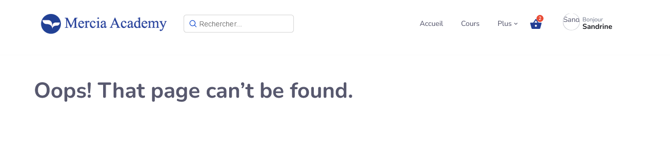

I'm sorry but I'm still having troubles with urls versions...maybe linked with the url repertory format.. I've translated my pages contents but when I click on the french or spanish version, I've got a error message (here enclosed):
An example:
english version: lien caché
french version: lien caché
spanish version: lien caché
It's the case for almost all my pages!
