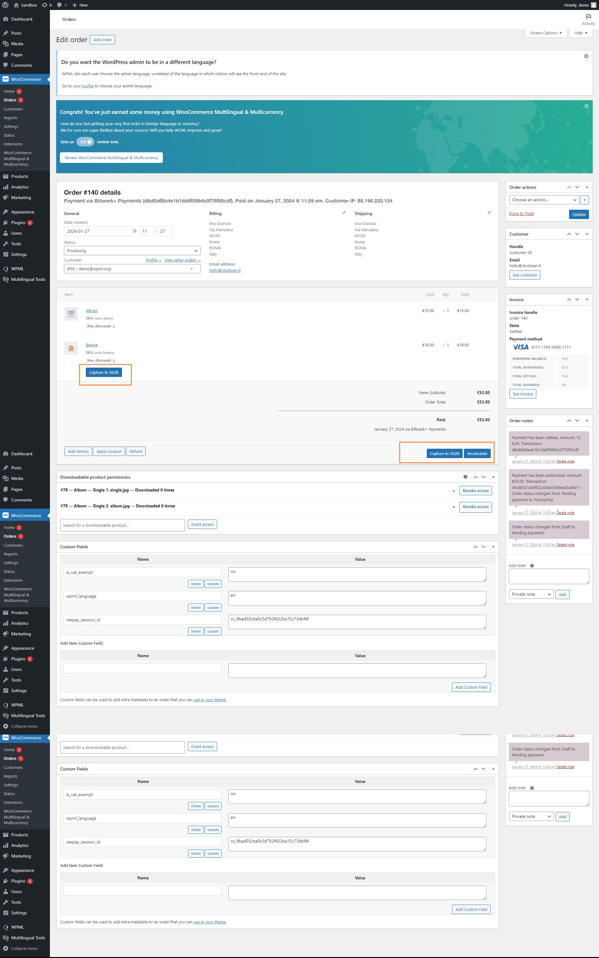

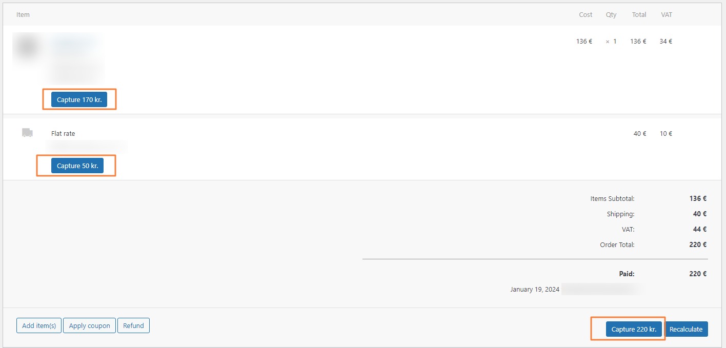

I have an issue with an order in the backend. The website is in danish & english. I've attached a screenshot. If the order is placed in danish/DKK everything is fine, but after updating the WPML plugin, we had an order in english/EUR, everthing is ok except that the "capture" button in the backend is in DKK and not in EUR - it should be written Capture 220 EUR and not Capture 220Kr (that it's 30 euros), what could be the problem?

I did a test with Billwerk on the clean installation you created and I can see the same error.
In the order page the Capture Button is in DKK and not in EUR.
