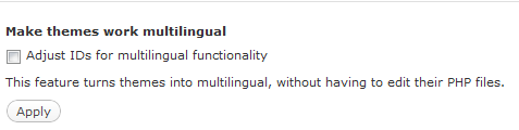

1) Automatically Adjust IDs
WPML can hook to WordPress API functions, detect when specific items are loaded and adjust IDs so that the results are adjusted for the active language.
This functionality is enabled by default and can be accessed via WPML->Languages (visible in Advanced mode):
Auto-adjust IDs
This will automatically adjust all IDs and can be used in any WordPress theme that uses the API correctly (almost any theme you can find).
